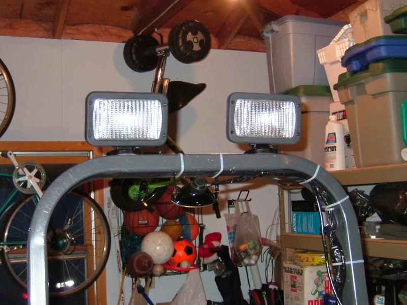

I PUT TWO 55W LIGHTS ON THE ROPS & CONNECTED THEM TO THE TWO WIRES UNDER THE SEAT, THAT GOES TO A 20AMP FUSE MARKED WORK LIGHT BY THE BATTERY. I WILL NOT BE USING THEM ALOT 30 MIN OR SO. DO I NEED THE HIGHER OUT PUT ALTENATOR ?. WILL IT HURT ANYTHING USING THE ONE IT COMES WITH. THANKS BX23RIDER. PS I DO ENJOY YOUR DISCUSSIONS.

All kidding aside, welcome to TBN! I have a BX22 that I rigged the same way. You should be fine with that setup and the stock dynamo. I've use my lights and headlights at the same time for hours at a time while shovelling snow without any problems.
   / WORK LIGHTS #3
I don't think you will have a problem as long as you don't run any other high draw equipment at the same time. I think two 55 watt lights draw about 11 amps. I run one 55 watt halogen on the rear with the same hookup as you. I can run it along with the headlights and flashers and I have had no problems.

I run (2) 55 watt facing forward and (1) facing rearward on my BX1800 with the stock alternator and have had no issues. I don't run the stock lights at the same time, but do sometimes run the flashers when near the road.

The basic formula used is P=I*E or watts=amps * voltage. Using basic math to solve the equation when amps is the unknown, you would have amps=watts divided by voltage.
So for two 55w bulbs you would have an amp draw of just over 9 amps. Three 55w bulbs would draw about 13.75 amps.
I believe the standard dynamo on the Kubota's is 14 amps. Exceeding a 14 amp draw will discharge the battery faster than the dynamo can recharge it.
