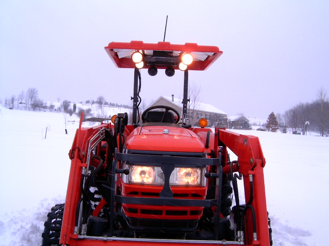

I can see that I will be using my tractor a lot at night, especially this time of the year. I have read some threads about adding work lights that are not totally blocked by the FEL. I would like to know a good "1, 2, 3, ..." process for doing that on a Kioti CK30. I am pretty sure I could do it myself but need to know what to look out for, where exactly to plug in the light wire, where best to install a switch (or have them work off existing switch).
I understand the controversy over drilling in the roll bar. Are there lights that attach with U bolts, or C Clamps? I think I would like two lights forward and one facing the 3pt attachment. Thanks in advance for the help.

Since my last post I have thought it through a bit more and if I were to add work lights to mine I would probably get square U-bolts to go OVER the top of the ROPS and a length of perforated angle iron to run between them, then hang the lights UNDER that at or close to the corners;
a) Keeps them under the ROPS so branches and other low clearance things don't decapitate them.
b) At the corners means away from my head.
c) perforated angle offers so many choices.
I would probably "cross the beams" to get a wider angle of coverage, which matters more than range at tractor speeds.

How long have you been offering this? I made mine, and I think I committed on here that Kioti should sell a roll bar light kit as an option. Guess you thought the same thing and took it upon yourself to create it? I probably would have bought it rather than make it, if you had this (and I knew about it) when I put mine on. Can you post a photo?
Yes the OEM headlights are almost worthless with the bucket on.
I mounted two front, one back on a piece of unistrut ubolted to the roll bar. Wired directly to the customer fuse through a marine grade toggle switch mounted on the rear of the 3ph lift lever plastic cover. Much like some others have done. The type of light you choose can make the job easier. Make sure you use lights that already have adjustable pivots. I used trapezoidal, rectangular lights that had little to no adjustment out of the box. So I had to fabricate my own pivots and weld them to the unistrut.
Buy the kit from MI. It'll save you a lot of time and trouble.
