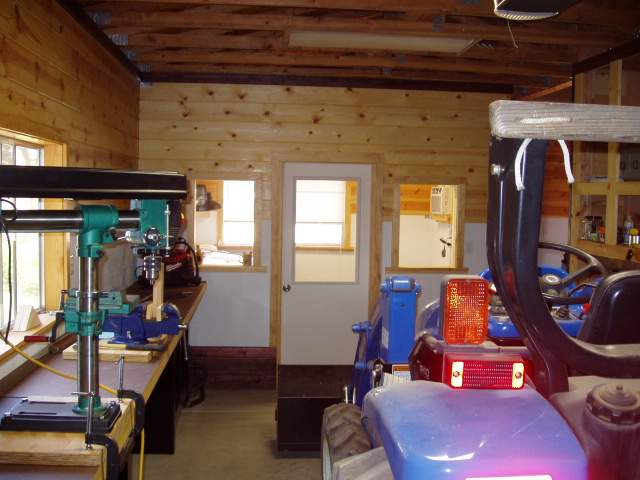

Glue 2 thicknesses of 3/4" plywood together and screw it down, then go to Lowe's or HD and get a sheet of 1/4" hardboard and screw it to the plywood. It makes a nice smooth surface to work on. After you wear out the hardboard in a couple of years, you just unscrew it and replace it. It's cheap durable and smooth.
I used the same ingredients but laminated three layers of 3/4" plywood because I wanted an open underneath clear space so I could move a stool around and sit where ever. The workbench is 2'x16'x38" high and 2-1/4" thick and supported by two 18"x47" Sears black metal two drawers and lower shelf pedestals. I wrapped the exposed edges with clear SPF then screwed on the disposable 1/4" Masonite work top. Both the drill press and vice are mounted on two layers of 3/4" laminated plywood that can be moved about and clamped in place.
