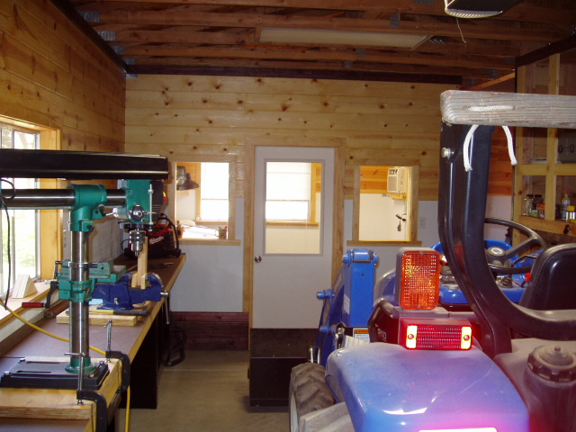

/ Workbench top #22
See Photo's
I can't believe a 30' long workbench used almost $500 in materials. I have enough left over for an L shaped bench on the opposite wall, but still expensive. Tempered Masonite glued on over planks makes the top . Once it warms up it will get a couple of coats of poly and I'll paint the wood gloss light grey or green.
Then I'll unpack all my tools and junk.

Thanks for all the replies and pics too!
A couple of comments and questions...
My workbench is not a primary workspace. It's for the odd job that won't need many tools. I don't store much beyond my machines and surplus goods in that building. It's not very good "work" space.
My base construction has two overhangs. First the large one to the right, but also the front has about a 2 1/2" lip from that 2X8 laid on its side.
For those that have used a hardwood, either strip flooring or tread or whatever... how did you fasten it down? Did you use a "subfloor"?
For the metal topped benches, is everyone just using cheap HVAC sheetmetal?
Anyone have an opinion on using cement board (like Hardie backer as opposed to Durock)? It would probably have to have some angle iron on the edges, but I could see that lasting a long time if it had 3/4" ply underneath.
I'm not sold on butting dimensional lumber together for the top. The only plus for that option would be not needing a seam due to the >8' length. But I can see having to belt sand all that area to get rid of the eased corners of each stick.
Anyway, thanks again. I hope this thread will provide some good ideas for folks who are thinking about building a nice sturdy workbench.
I would not use any type of cement board as a top ply working surface due to the possibility of it cracking or chipping. I'm very pleased with good old 1/4" (+-) tempered Masonite at a far less cost.
