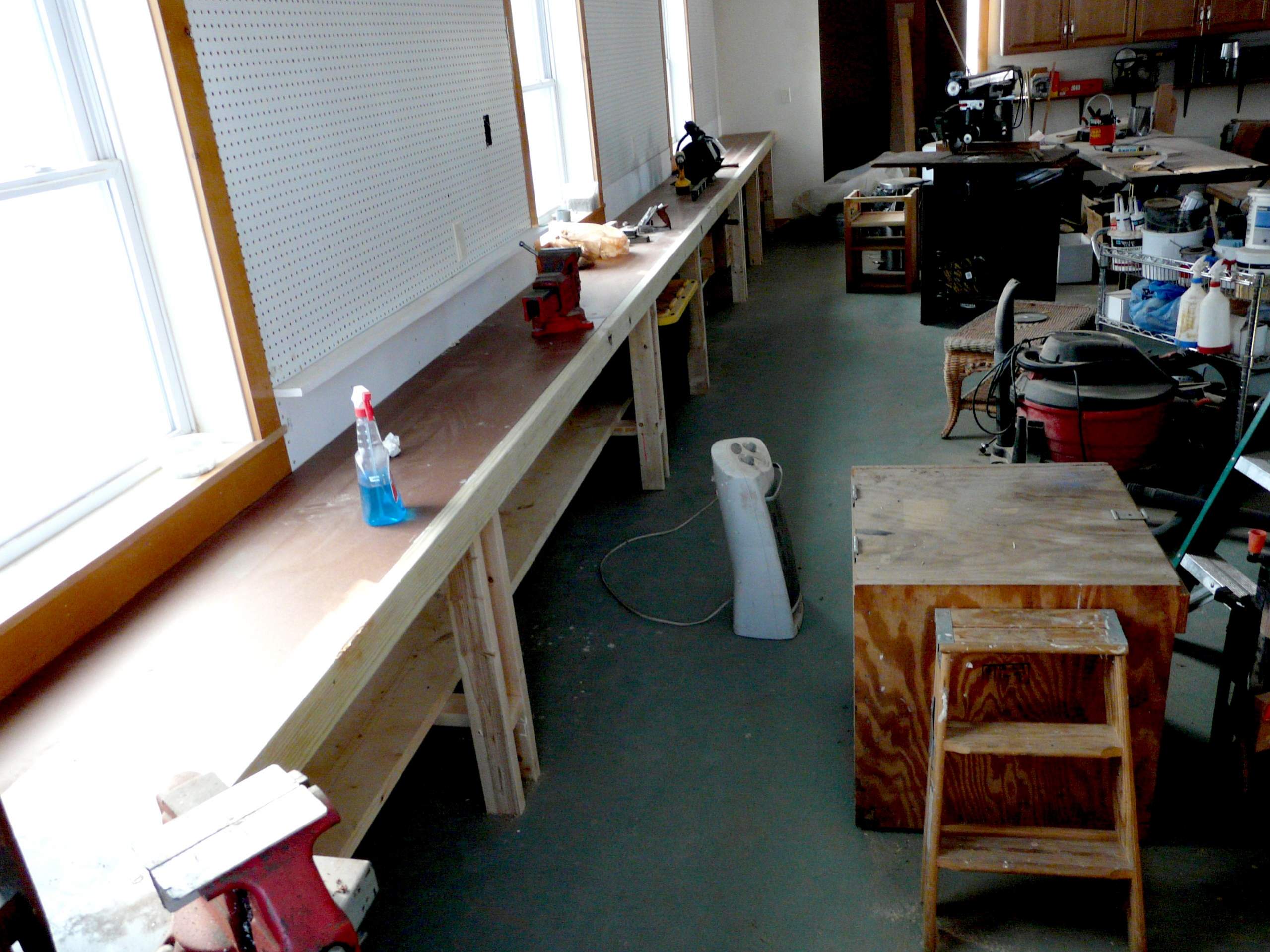

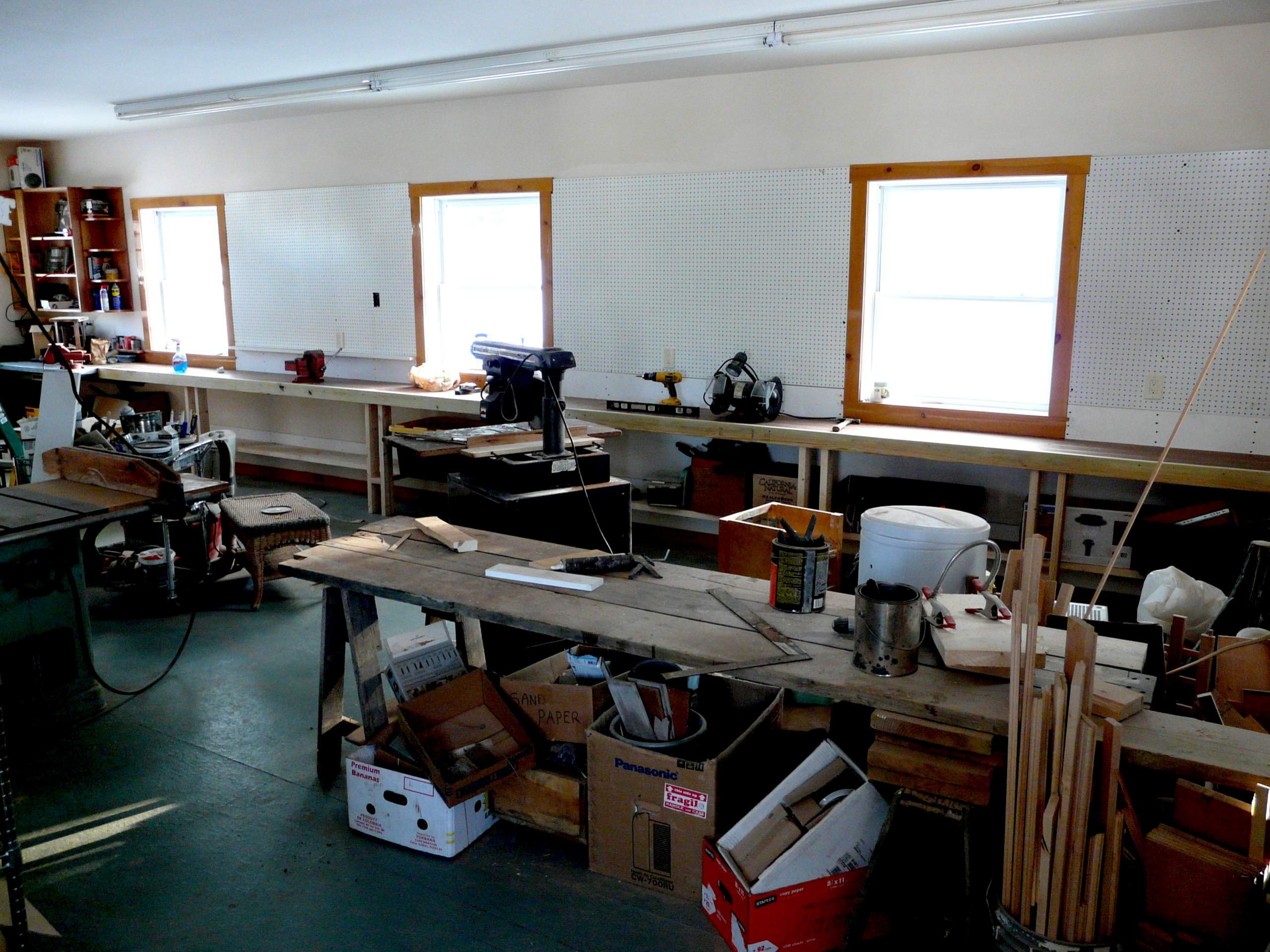

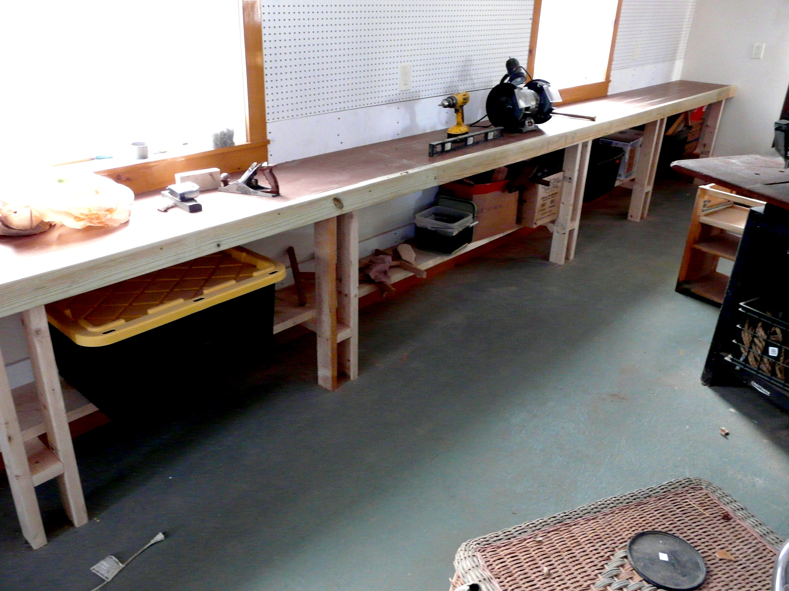

   / Workbench top #22
See Photo's
I can't believe a 30' long workbench used almost $500 in materials. I have enough left over for an L shaped bench on the opposite wall, but still expensive. Tempered Masonite glued on over planks makes the top . Once it warms up it will get a couple of coats of poly and I'll paint the wood gloss light grey or green.
Then I'll unpack all my tools and junk.
