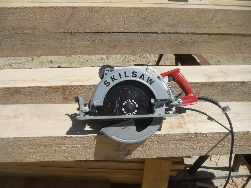

The Skill is a good one, got 3 of them and the last one (see pic) has a 10 1/4" blade and they now make a 16 5/16" model. But it's hard to beat a Makita, they just don't offer a 10.25 worm drive but they do have a "normal" top handle 10.25 and a monster 16" beam saw.
That's a 6x8 it's sitting on.
Thats a bit more wagon than I need😁.
