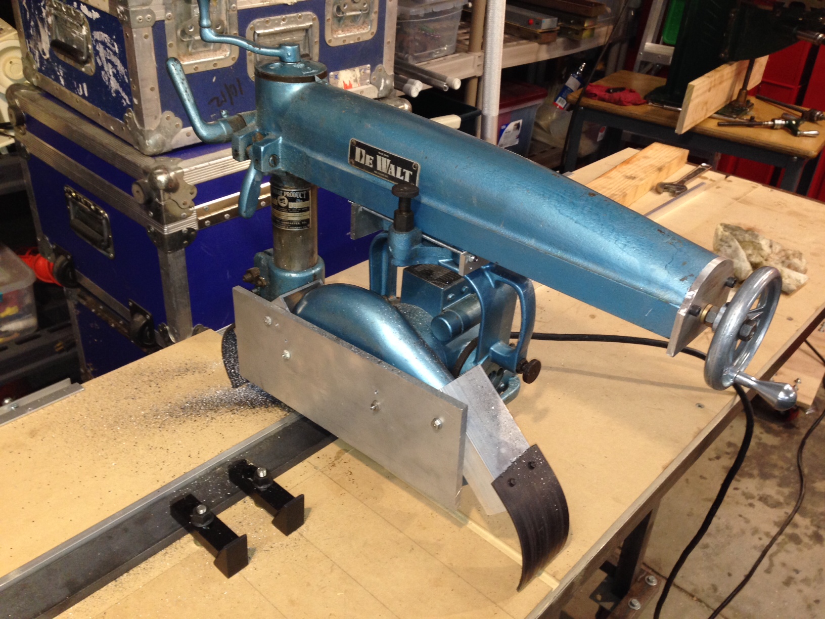

Willie, check the rated rpms on your saw (probably 3600 or so) vs. the rated max rpm of the blade you're looking at - I've seen a few that are rated at high enough speed for a normal chop or radial saw, but haven't tried 'em to see how long they last.
What I DID do, and it was a success (until it wasn't :=( was to buy a "closeout" blade from Hazard Fraught, it was a 14" carbide tipped "metal cutting" blade - it listed max rpms at around 2400 IIRC, and my abrasive chop saw is 3650 or so - I got stupid, put on my heaviest welding leathers/gloves and face shield, clamped a piece of square tube down, stood with ALL body parts AWAY from the plane the blade runs in, and gave it a shot -
The cut was perfect, no burrs, looked like it had been polished after cutting. Same with the second cut, up thru about the 15th or so (IIRC, it was 2" .095 wall tube) -
Then, it got harder/slower to make each successive cut.
By about #25, it was done. Blade was clearanced out @ $50, so each cut cost me $2.
Typical "cold cut" chop saws like DeWalt, Milwaukee, etc, run at around 1750 rpm and the blades are typically rated at maybe 2000-2500 -
Like I said, I've seen a couple 8-10" blades that are rated at high enough rpm, but they're anywhere from $60 to $100, and I'm not sure I want one bad enough to take the chance it will last.
I am, however, planning on keeping the blade option open on the "radial plaz" when I get to it, but it'll mainly be a "mini-track saw" for a plasma cutter, that will crosscut, miter, bevel, and cut radiuses for things like hoe and loader buckets, maybe "heavy duty hose hangers" for all my welding carts, etc. - I'm gathering notes and such, and will start a new thread in the Welding forum on the subject - of course, anyone who beats me to it will be encouraged to post pics, plans, results, etc, so that thread can be sort of a "one stop shopping" thing for converting a RAS to a "RAP" :=) Steve
