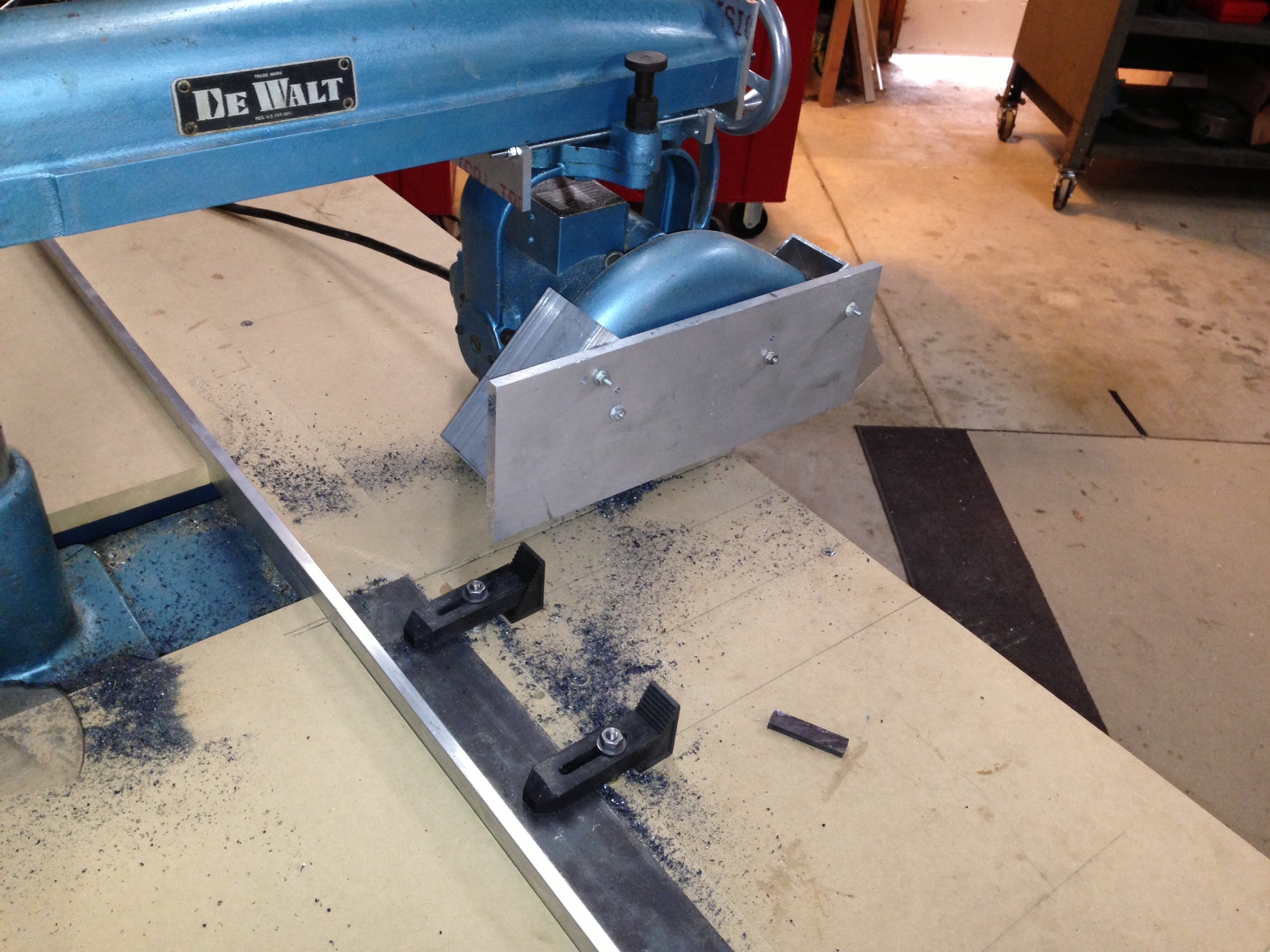

On JJ's question, I have done it both ways now. With the two milling machine clamps (see picture) to stabilize the work, and the 3/8x12tpi lead screw to stabilize the saw, I don't see a difference in ease of control. That being so, going forward, I will use it the traditional way (pull into work). I agree that is generally accepted RAS practice and also closer to the motion of the metal cutting chop saws.

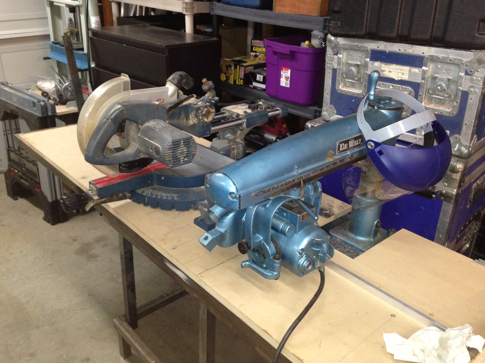

Here is a picture of the two machines side by side.
If I go to the machine on the left, hold a piece of wood against the fence with my left hand, and push the motor head through the work with my right hand, my technique is good.
But if I go to the machine on the right, hold a piece of wood against the fence with my left hand, and push the motor head through the work with my right hand, my technique is bad.

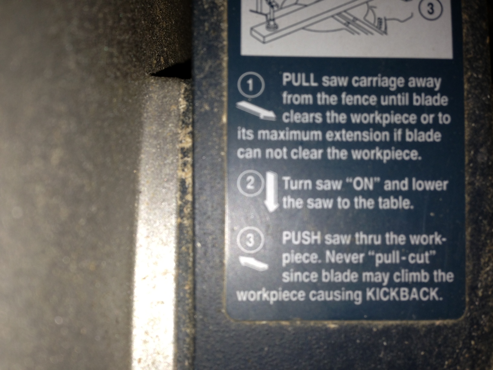

We know the instructions for radial arm saws say, always pull through the work.
The Bosch of course says just the opposite:
So the question is, why is pushing good form on the miter saw but bad form on the radial arm saw? :confused:

Pat, I'll give this a shot - let's assume a pretty wide board in each case, since that's where more of the differences lie.
Chop saw - You start off with the blade ABOVE the surface of the board, so initially there would be a DOWN pressure on the board along with the blade pushing INTO the fence. Once the blade has plunged thru the board at the outer edge, the force would be trying to LIFT the board at the outer edge but still PUSHING it toward the fence.
A good hold-down would help control this, but I've yet to see a saw that offers a MOVABLE hold-down that can be located at the FRONT of the cut, where the lift is more pronounced. So YOU need to be that hold-down.
Lift force doesn't seem to be so drastic that this isn't doable. Board width is limited to about 12-14 inches, even on the 12" saws - I have two chop saws, a 10" Hitachi and the 12" Dewalt slider.
Radial Saw - You adjust the blade depth BEFORE you start the cut, and there's no SAFE way to CHANGE that during the cut, because you're using BOTH hands - one to control the saw, and the other to hold the work piece.
This means that, if you PUSH cut, the blade must be all the way toward you so there's enough room to get the work piece between the fence and the blade, WITHOUT the blade in contact with ANYTHING until the cut has started.
Sooo, if you PUSH cut with the RAS, you will START with maximum UP force (with some force toward the fence), giving the work piece the most chance of being LIFTED by the blade - especially if you get impatient.
Keeping the saw BEHIND the fence keeps the blade further away when the saw is started, makes sure the piece is NEVER subjected to lifting force, instead it's ALWAYS being pushed DOWN and BACK.
In the event that you use the prescribed method and DO get impatient, the blade will try to climb the piece and "take a run at you" - I've had this happen a time or two over the years, and it has NEVER MADE IT THAT FAR - I guess if you were cutting stuff thinner than maybe 1/2 inch that it COULD happen - but normally it just stalls the saw and "wakes you up" that you were getting too impatient.

The proper technique is to leave the saw in the resting position as far away from your body as possible, position the stock, then pull the blade through the cut. When the cut is finished, return the saw to the original resting position and then move the stock.
I would also suggest that when cutting ferrous material, to put a magnet in the direction of the thrown chips.

So, on the last part of JJs question. I think the front-located magnet idea is a good one. The shroud I made does a pretty good job of keeping chips on the table, but anything to better manage the chips is worth trying. I am thinking of two other modifications. A rubber flap, that could stay right on the surface of the material, might help, especially in front, where JJ is suggesting a magnet could be placed. Also, I am thinking of routing a slot through the table where the blade travels, and installing a pan underneath. That might better contain the chips that travel with the blade.

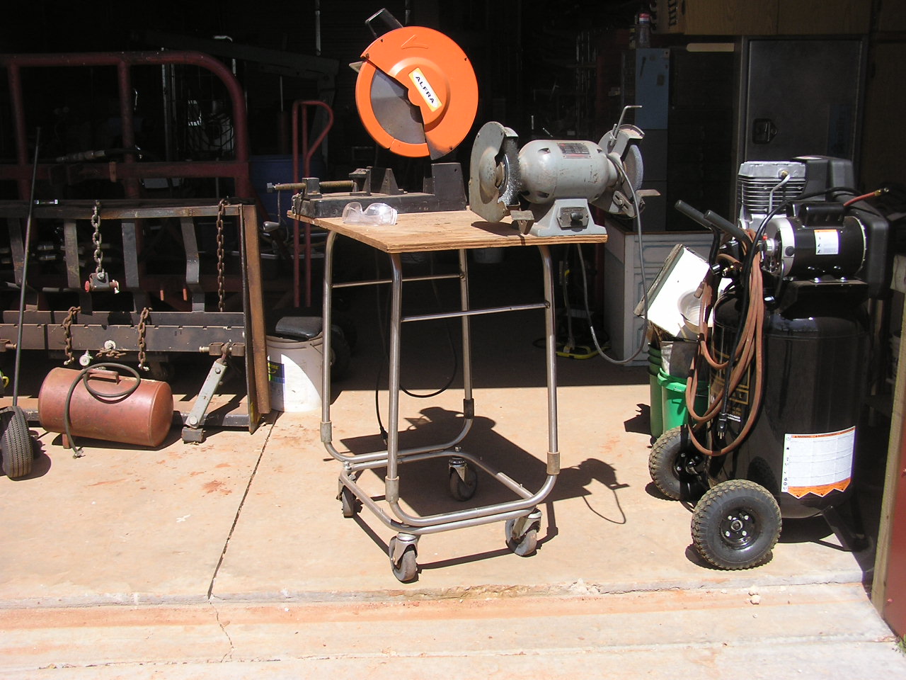

That is the way my metal cutting saw is made. It has a chip drawer under the slot. You pull it out from the back to dump the metal chips.

Totally agree on face mask for metal cutting, picture in post #62 shows it hanging on the saw. I'm even thinking about a leather apron which will be a first for me.
