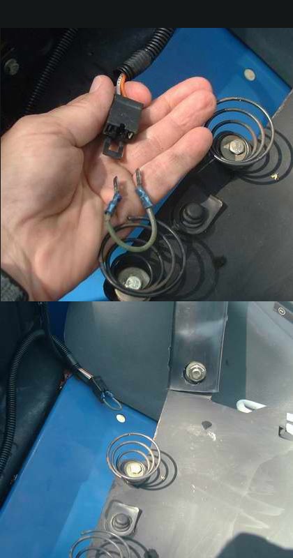

Here's a question for you - since you are VERY familiar with this platform... and I have an offer in on one :) One VERY annoying "safety feature" is the fact that if my rump comes off the seat for any reason - the tractor stalls unless the transmission is in N. Even if I'm not moving - just sitting there - foot off the hydro petals - idle - stand-up - engine dies. So - I'm trying to figure out how the heck - when bush hogging, I would stand up to see right in front of the tractor if needed... (PTO not engaged in this scenario)
My Challenger does that, too.

That safety switch is easily disabled if that is what you want to do.

Look at the attachment for how to disable the seat switch. Just disconnect the switch connector under the seat and follow the photos attached. I did this the first week I owned my tractor and I've never looked back. I stand up a lot when operating.
That looks the seam, uhh, fix, under the seat of my mini-Bota.
