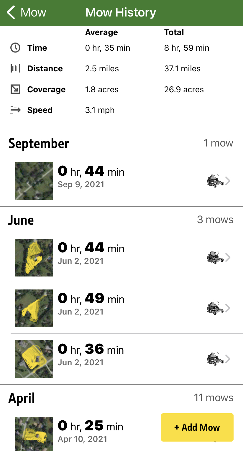

I think the op can trim perhaps 20 minutes off his mowing time with an equivalent sized zero turn mower deck. Only he will know if that's worth the expense of a new machine. In my area of 26-30 mows per season, the zero turn would save about 8 hours of seat time per season.
I cut about 30 acres across 15 or so 1-3 acre lots, so the zero turn is a no brainer for me. Hustling on these lots I average 3 acres per hour with a 72" zero turn. On my 6 acres I do perhaps 4 acres per hour at a brisk (but safe and quality cut) pace.

What application are you using to generate this data? I would really like to have that information to assess my bush hogging this summer.

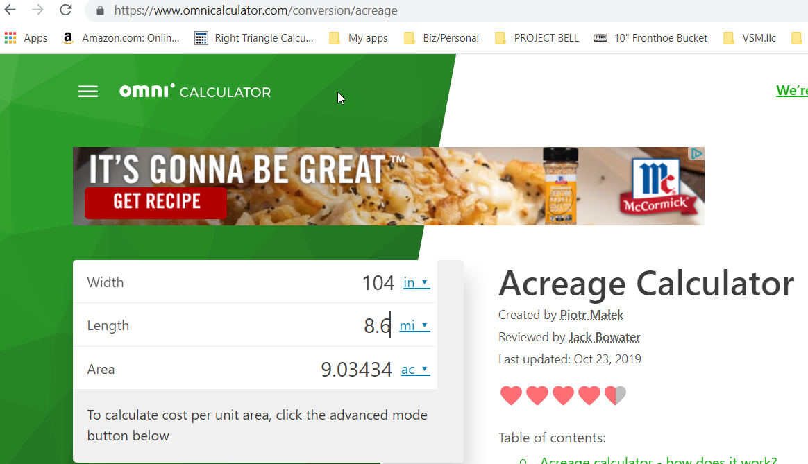

1 acre = 43560 sq ft 9 acres = 392040 sq ft. Cutting 6ft wide with no overlap 392040/6 =65340' long strip of grass 6ft wide. 65340/5280ft/mi =12.375 mi /hr. Not many zero turns will go that fast, and if you do have one that does, your not going to cut that much in an hour if you have to turn, overlap or cut anything rougher than a green at Augusta.
   / Would a zero turn be faster than a B2601? #40
If I am reading this calculator correctly, a 104 inch wide mower has to go 8.6 mph to mow 9 acres. That is no overlap, no turns, just a linear line.
I don't know how fast commercial grade zero turns run but I suspect an experienced tech would say that running it wide open would shorten the life of the spindle bearings a good bit.
