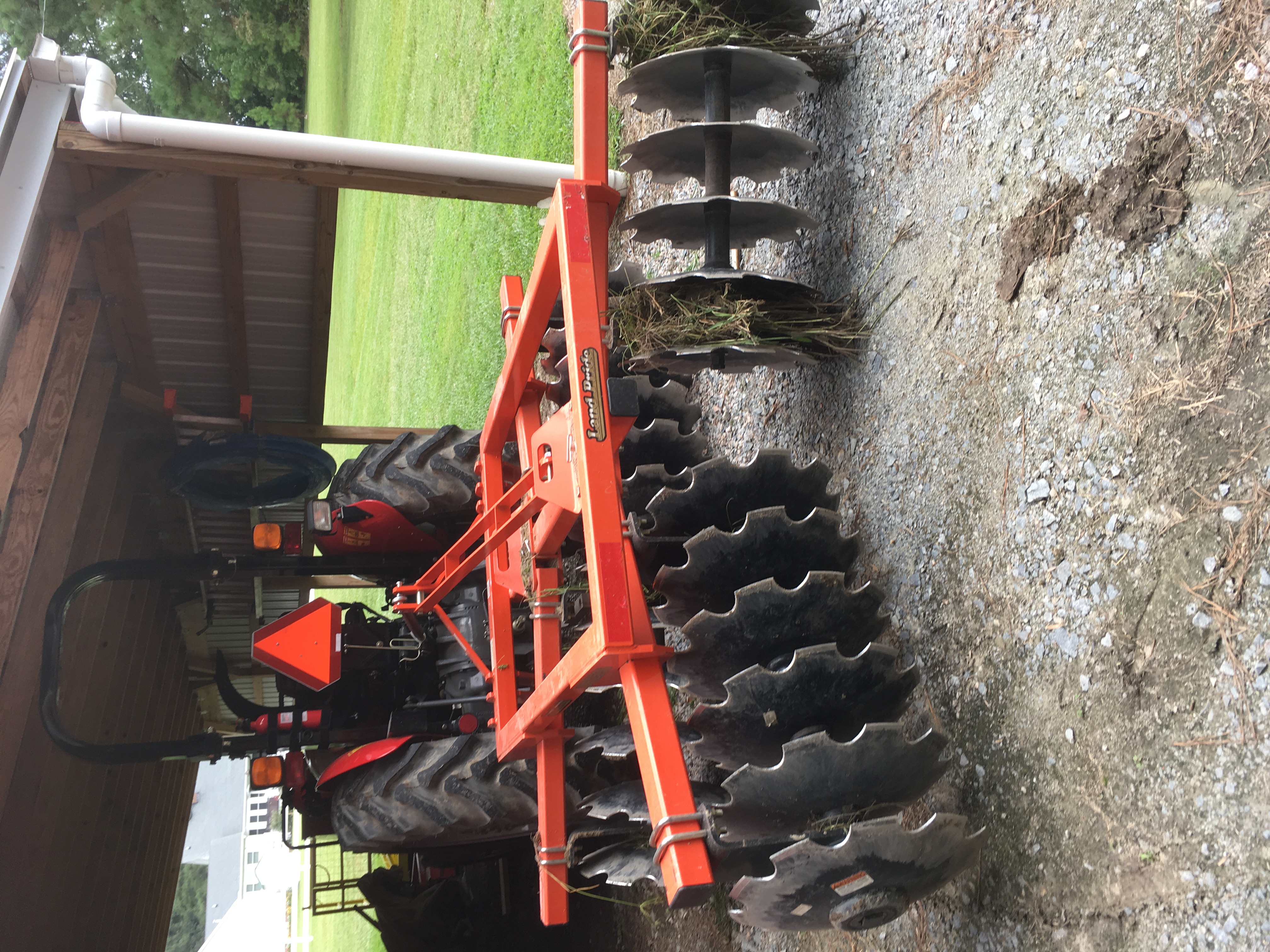

Too wet to get back into fields yesterday after over two inches of rain, but around 9am this morning I am back at it. And this time....brakes unlocked and they will be used.
Harrow readjusted to position three in front, one down from most aggressive, and position 2 in the rear, one up from least aggressive. Harrow is hitting on front gangs about an inch faster than rears, so they are biting in, which is good with all this grass involved. What a pain that was to get out of the discs...took me almost an hour. Notched discs are stamped Land Pride, not another company and boy are they sharp. Actually cut the end of my finger on one.
I'm going to lower the air pressure to 14# in both tires. They look pretty flat as is, but no bulge or ripple in sidewall. Maybe I can soften them just a little.

thanks guys. In for lunch. Been out there for four hours, it's running great.
boy does using the foot brakes help, probably knocked the new pad glaze off them.
by the third pass I did not have to lift the harrow very often.
Again this is land that should have been bushhogged and/or plowed.
Farmer neighbor delighted, he thought it was too wet.
after raising the disc this morning before starting, I wiggled the tractor back and forth and there is
both flex in the sidewall and some small bulge when the weight of the harrow is on. Looked pretty flat
and for sure not overly stiff.
