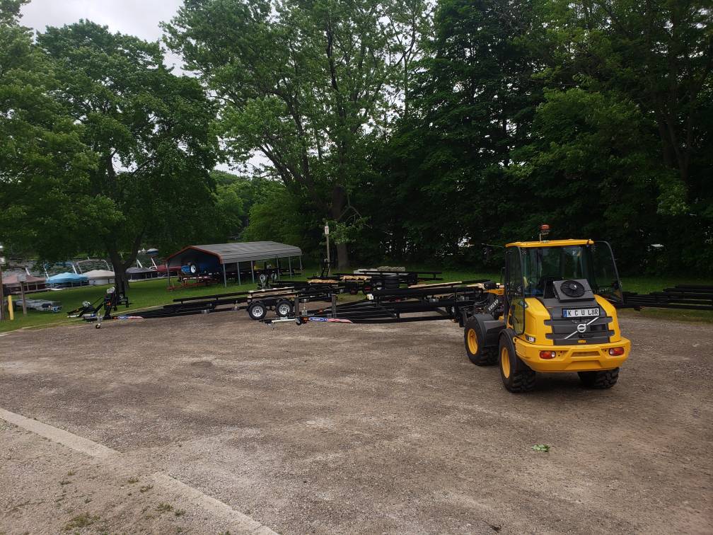

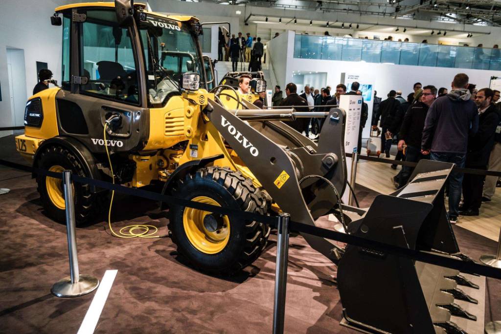

So here is where I am at right now. I have been using a loader around my boat yard for years, and have finally found the "goldilocks" However, my 168 hour 2019 Volvo L25H ($80K) is having emissions issues and reduced power. I love the functionality of the machine, but hate its emissions. Fuel consumption is not even a consideration, I think that I may have fueled it 6 times in 10 months. For my use, I think that electric would be a God send! I don't even care about the overnight electricity usage, as it would probably be a wash in energy expenses. The next great big however, is that Volvo is offering $50k trade towards the $130k electric L25. For $80k extra, I think it is a tough step to make.View attachment 670649View attachment 670650
As they say quality only costs once but it is up front. That is one awesome machine. In your setting that word Electric would be impressive I expect. I did not know there was a tilt features on front end loaders.
https://www.volvoce.com/-/media/volvoce/emob/brochures/brochure_l25_electric_en_21_20059105_b.pdf?v=G9hQPw
