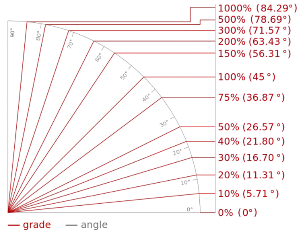

Here is one way to show how steep the hill is in a picture.

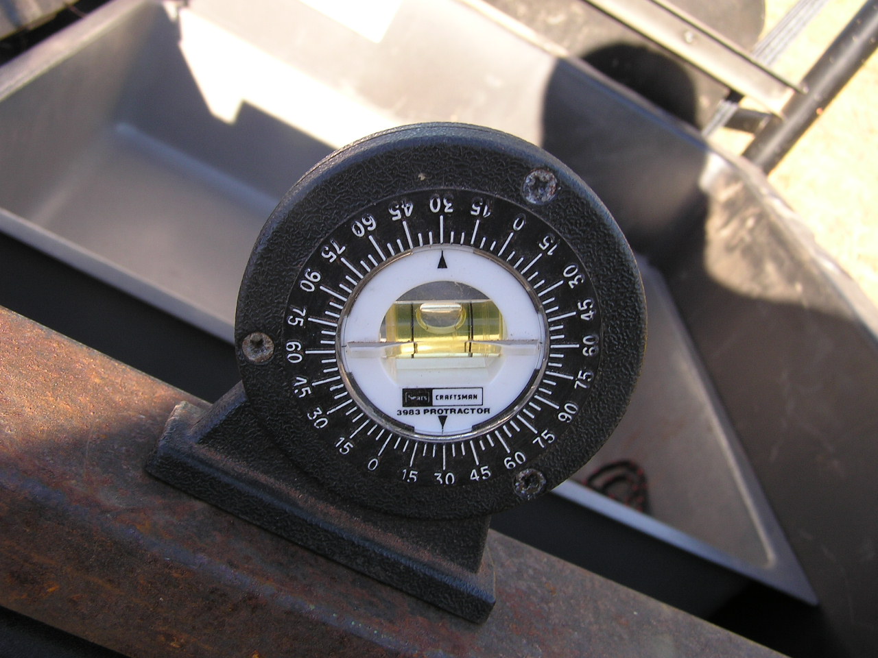

You really need to measure the slope to accurately assess the safety. Anything less than 25 degree slope could be mowed with a tractor albeit very slowly and with completely dry soil conditions. A zero turn mower would handle 30+ degree slopes with ease. They will start sliding before tipping over so you are pretty safe with regard to flipping them as long as you go slow and don't hit any holes or washout spots.
It is hard to tell what the actual slope is in your photos, but looking at the fence and the slope, I don't think you are more than 15 degrees.
