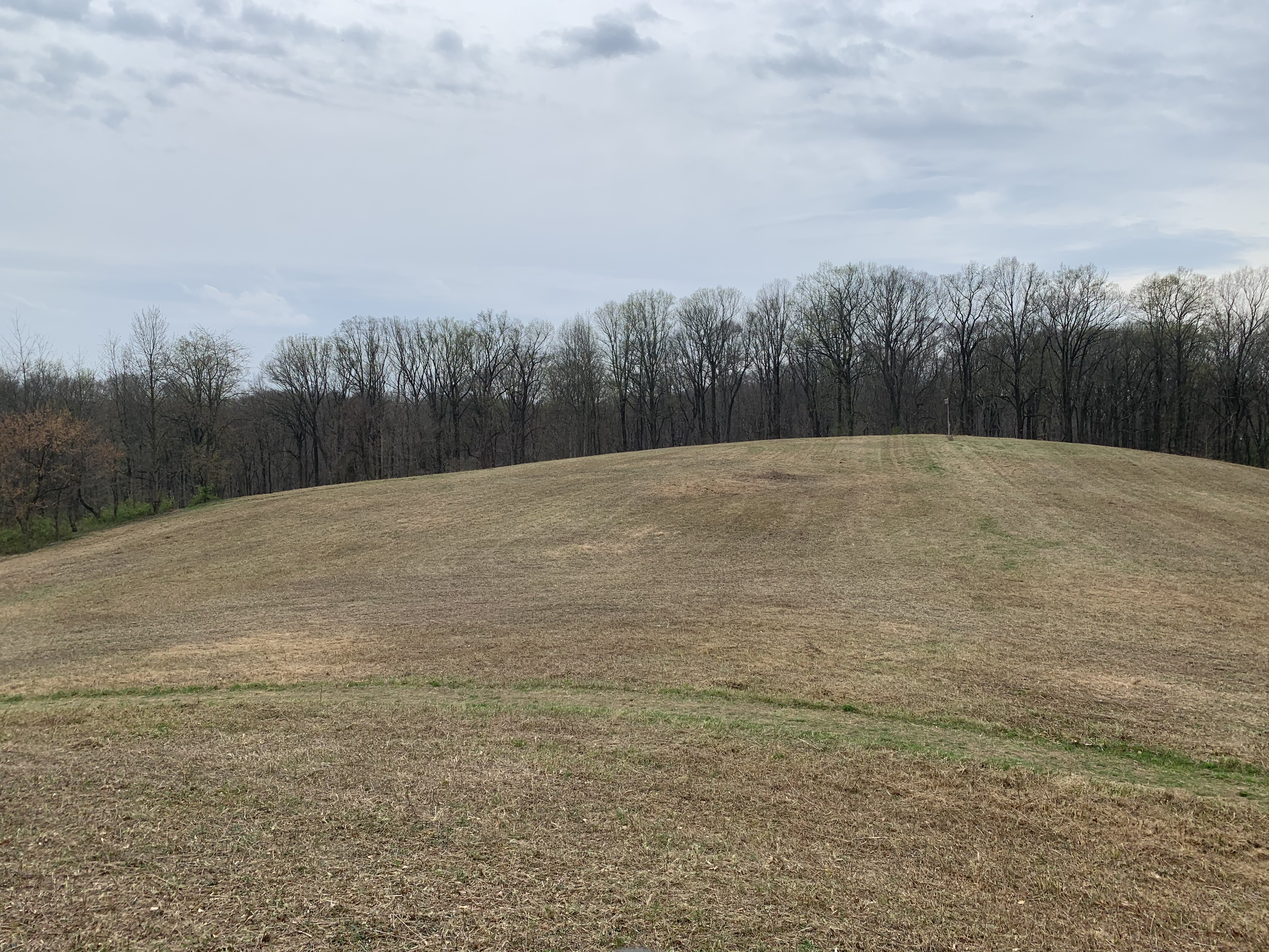

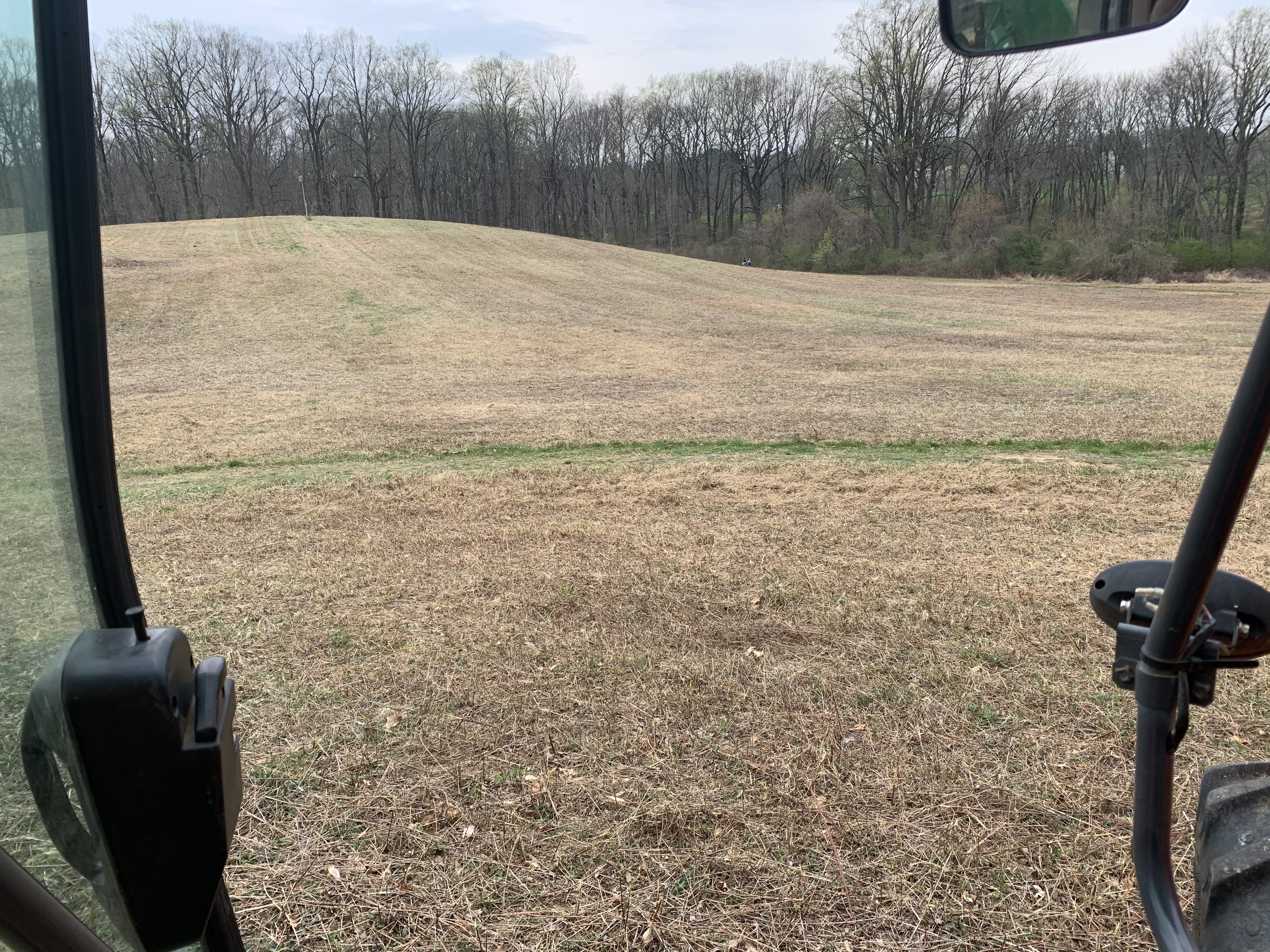

I used to do that, too. Then I realized Lyme Disease is pretty bad. Now instead of walking the property if its a new customer, I mow it very slowly. Usually I will hang my 8 foot bucket on the front of the loader, curl it all the way back and let it hang about 8 inches off the ground with the loader in soft ride mode.
If I hit something, the loader will ride up over it, and I can stop to investigate.
I just cut this place for the first time after customer let it go 2 years. I hit one stump and an area of rocks. Loader found them in the overgrowth real easy. No big deal.
