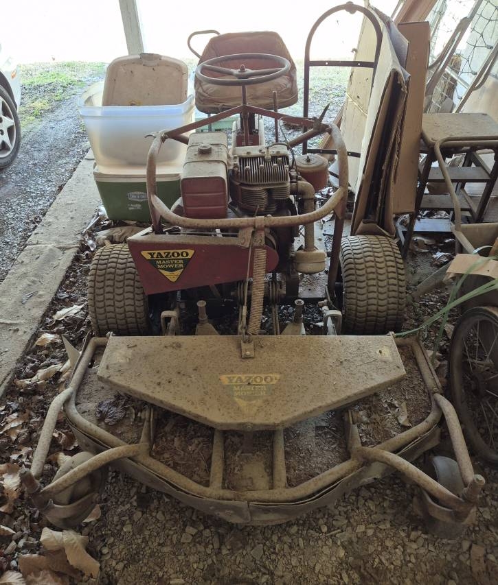

About 15 miles away at my homeplace is this Yazoo mower my Grandfather bought new in 1970. It's been sitting in a shed 30 years. I have 5 mowers and don't need it, but sort of sentimental. From memory it has a Kohler K321 14hp motor.
When Dad inherited it, he used it some but I'd have to "un-rig" everything he did. It needs tires, seat, probably sand blast, deck repair, battery, probably carb, magneto, blades, belts.
I can picture everything I'd do, disassemble, paint, decals, etc. Question is...is it worth it?

Worth it? Resale value vs parts expense, absolutely not.
/ Would you work on this? #3
Only for the memories. You'd probably have to fab most replacement parts. (I know that's not a problem with your shop setup) You'd have to research the deals and have someone remake for you. Don't think that Yazoo will have mick stuff left for replacement parts. If you have someone younger in the family that would be worth giving the project to, and oversee their work. That would be worth it!
/ Would you work on this? #4
As D&D said ... if the goal is to refurb & sell? NO. Only you can answer what the sentiment is worth. If you think it would make your Grandad smile ... sure. As long as you don't wind up cursing out your Dad for all the stuff you have to unrig.

Yes it's front drive and wheel under seat has a chain drive to steering wheel. It's a 2 speed. I remember like yesterday we were having noon dinner when Grandad goes flying past dining room cutting grass...we all said "what 'tha"???
He thought it was amazing thinking it did a good job cutting before wheels ran over grass and first zero turn we've seen.

If it was mine, I'd restore it. Take your time and fab what you need and if you require machining of anything, PM me.
far as the engine is concerned, it's a K series Kohler single and all the parts are available for them readily. I consider the K series Kohler engines to be the best singles they ever built and they sound oh so sweet when idling. If you need a shop manual for it, I can send you a PDF for the entire K series of Kohlers. K series have adjustable valves (no grinding the valve stems to set the clearance and with proper care, it will outlive you....

Several years ago I was given one of these mowers. They are tough as nails but not exactly full of creature comforts. Mine had a large Wisconsin engine on it, and it was the biggest single cylinder engine I have seen. Starter and carburetor were the same/bigger than what was on my Farmall H. Great commercial for them floating around on YouTube....
Previous owner of mine had bolted a tractor weight to the frame behind the seat to try and help keep it on the ground. If you did a lot of swapping between forward and reverse it was easy to pick up that single wheel.
Husqvarna had a few parts remaining, but mostly everything is NLA. Biggest potential issue is the transmission. It uses a set of friction disks that once they start to go South I don't know if there is any way to repair or replace them, at least not cost effectively. I may still have some parts or service manuals for that machine if you need any.
