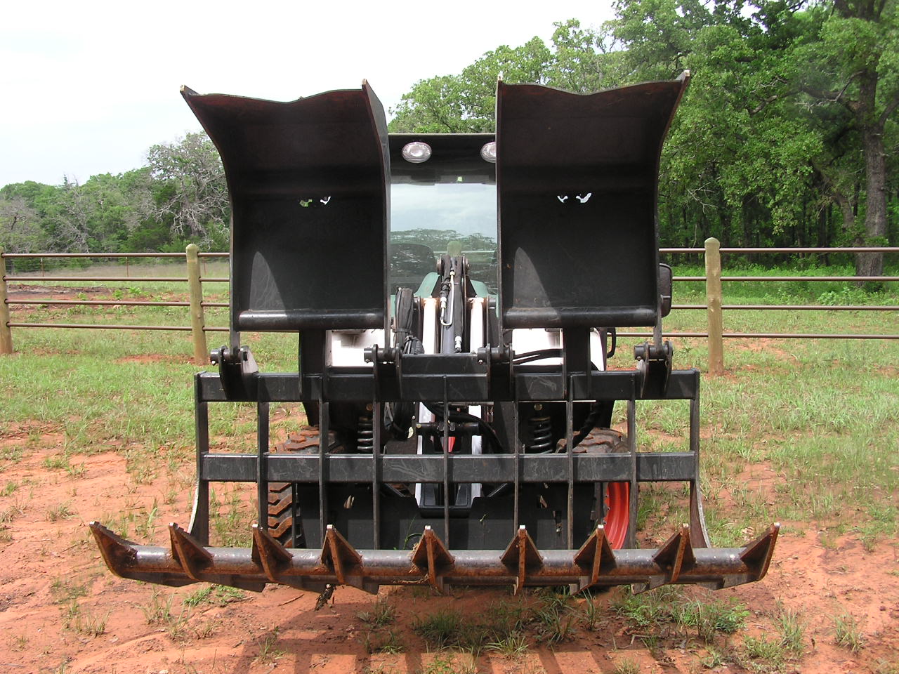

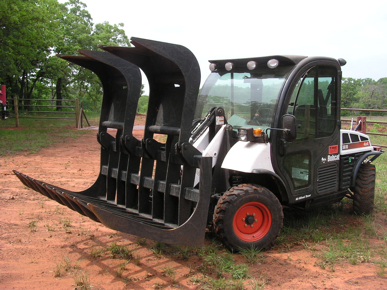

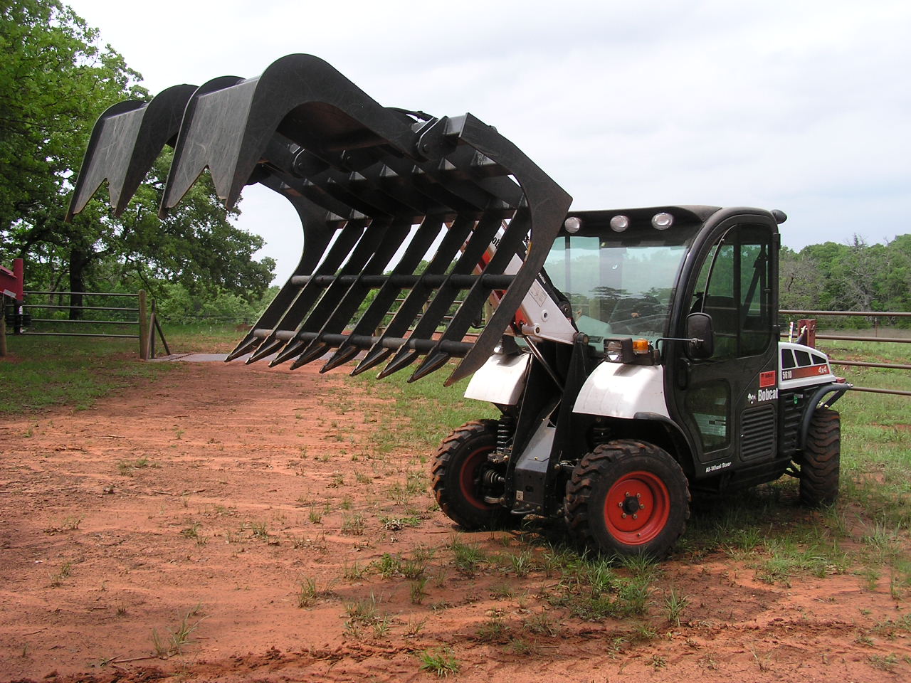

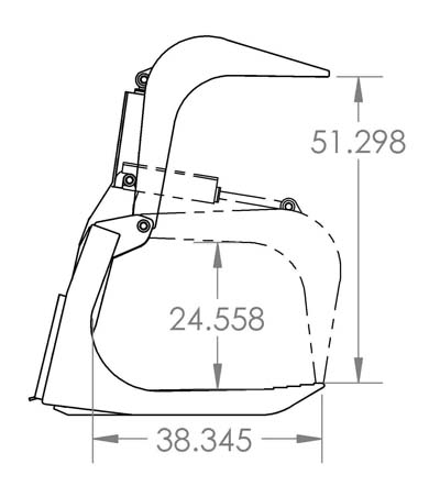

lwm, I know you considered the Monster Grapple, now it sounds like you should have got it.
51" opening.
400x452xMRG.JPG.pagespeed.ic.24IcWkPDdY.jpg P5240009.JPG P5240010.JPG P5240017.JPG
I am posting this to help newbies make a decision. The grapple is heavy, so it needs to be a big tractor. :thumbsup:
   / wr long or ??? for brush & logs? #142
51" opening.
View attachment 345738 View attachment 345739 View attachment 345740 View attachment 345741
No reason that exact grapple design couldn't be built in 48"-60" width with a single lid using 3/8" mild steel. That would sure cut the weight and cost.
   / wr long or ??? for brush & logs? #143
Yep, I posted that drawing and mentioned raising the pivots on one of the EA threads, but got no response from Travis.
