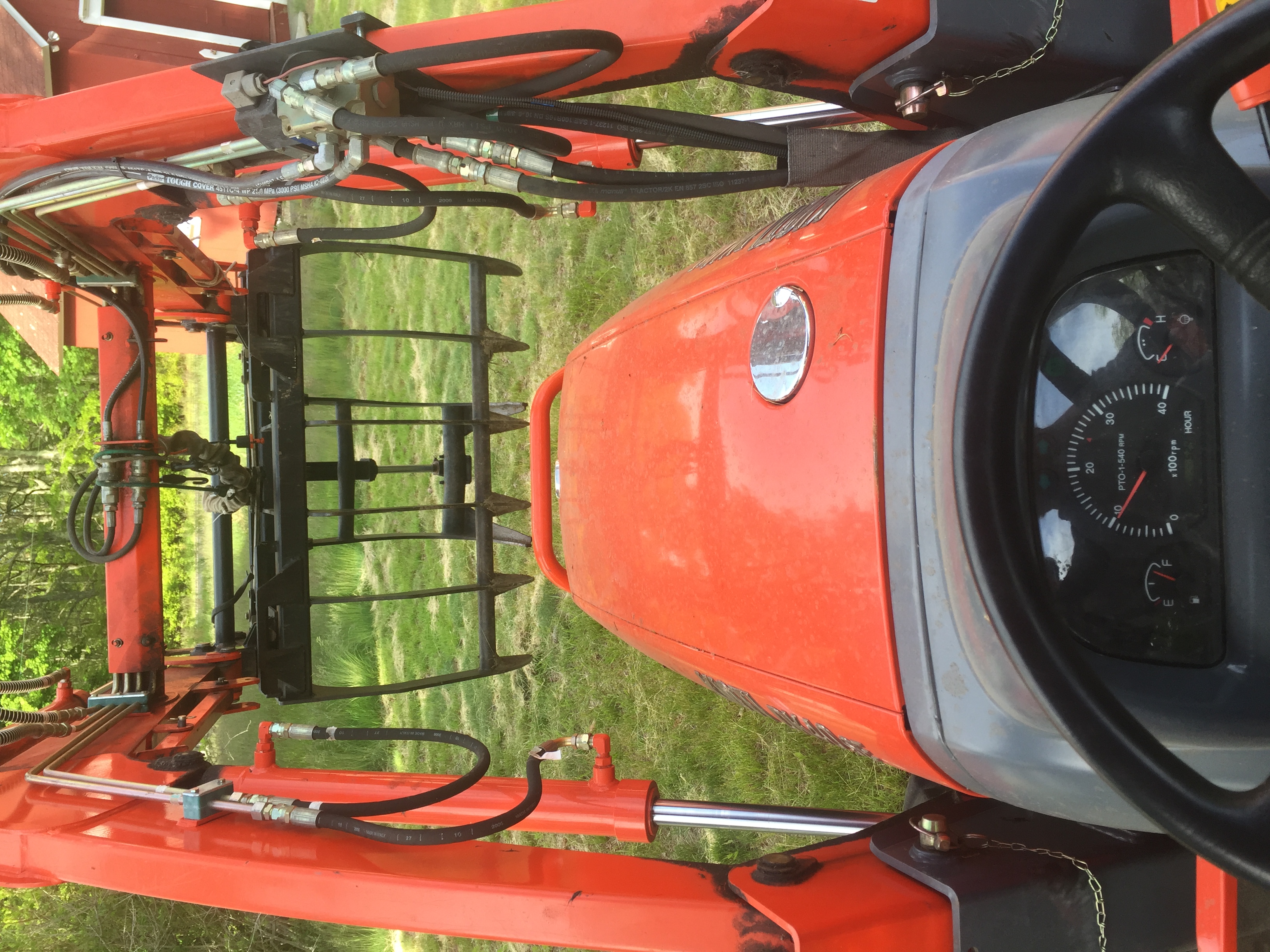

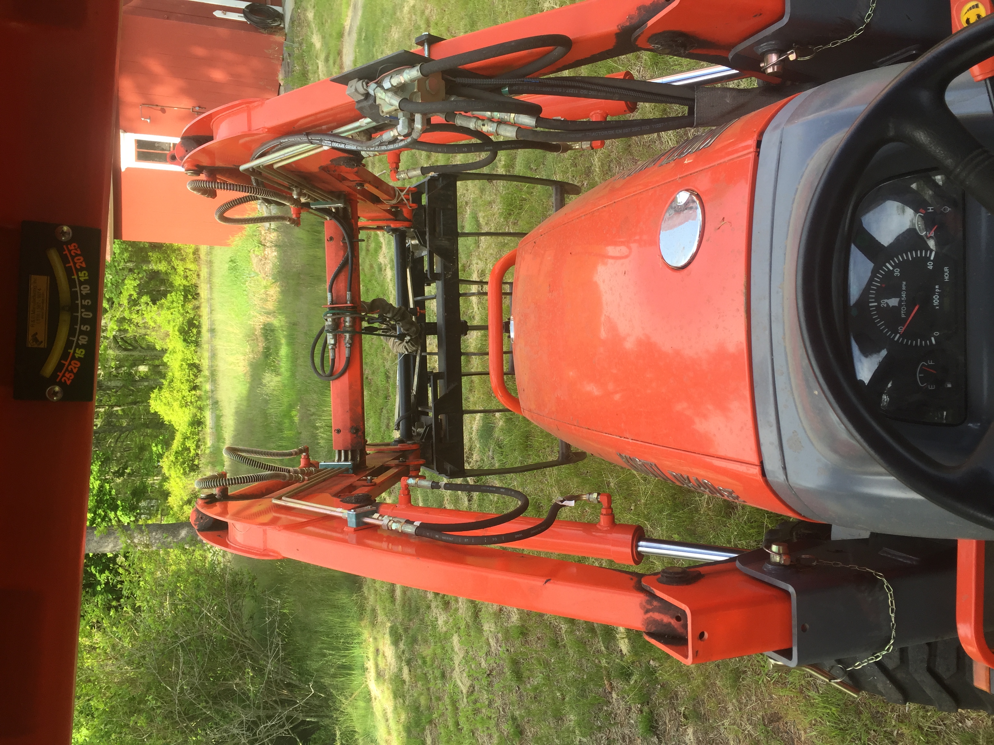

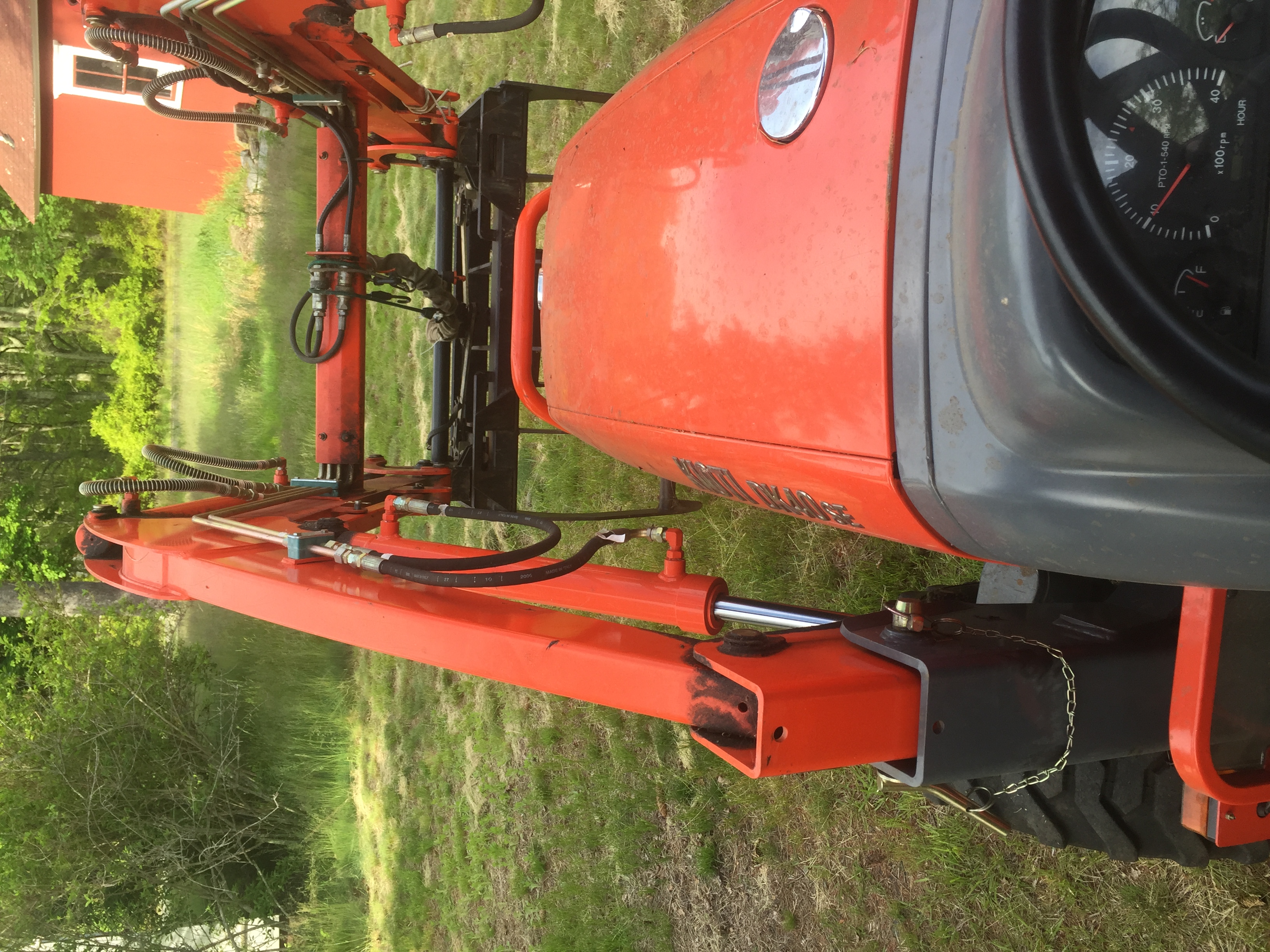

Island Tractor, I have never operated a grapple, so bear with me. I am here to gain knowledge before I make a purchase. You have stated " get a narrow grapple" I understand that a narrow one will penetrate the earth better, but how do you know where your grapple lower front edge is? I can get a fair idea from the loader leveling guide But is the tines 6" or a 1/2 inch off the ground ? Or do you just go in to the log at a slight downward angle dig in under the log and tear up the ground and then curl up ? Do you stand up and look over the front of your tractor to see it? It would seem if the grapple was a couple of inches wider than your tires then you could see the angle of the tines and it's position to the log you wanted to pick up. Thanks

Good question. With a narrow grapple you can actually see the edge of the grapple sitting in the normal position. Just lean your head slightly to one side or the other to see where the edge tine is on either side. See photos below. With a wider grapple like a 72 or 84 you could probably see the same edge outside the FEL but then you wouldn't be exactly lined up on the object. Think of a narrow grapple like forks. You can see what is ahead pretty easily. There may be some instances with any width grapple where the hood of the tractor interferes with your ability to exactly locate the central tines but unless you want to install a "backup" camera on the front grill that will be the case with any FEL attachment.
