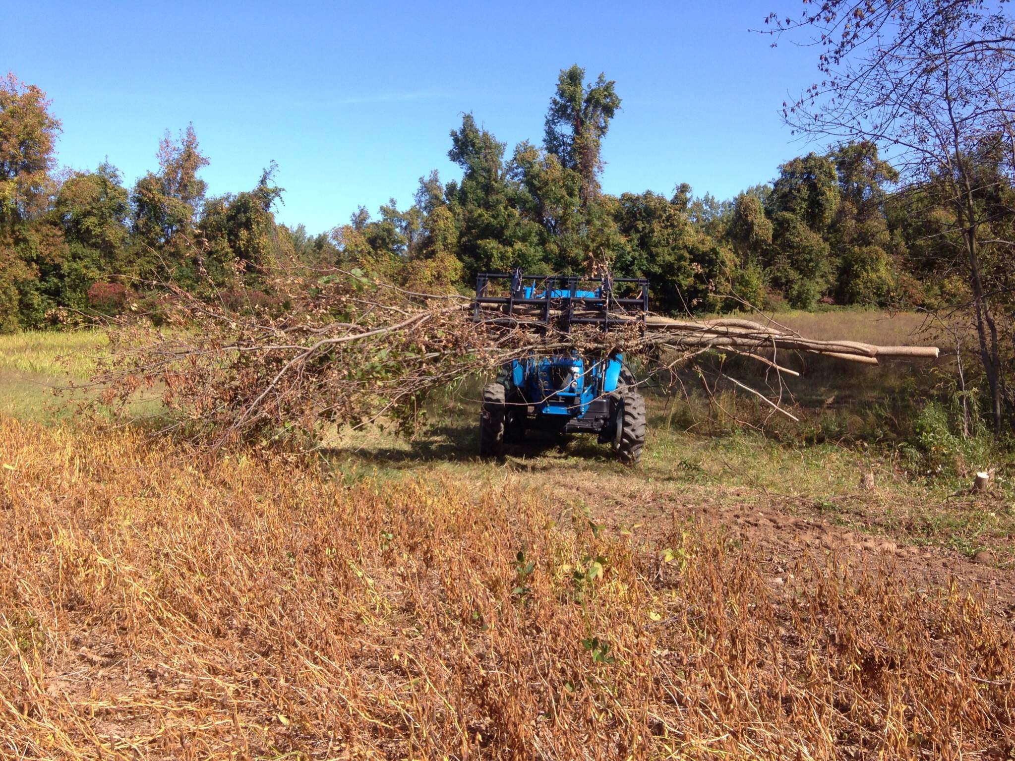

Well the first morning went well. First I picked up about 2 dozen trees I had cut and here's the obligatory picture:

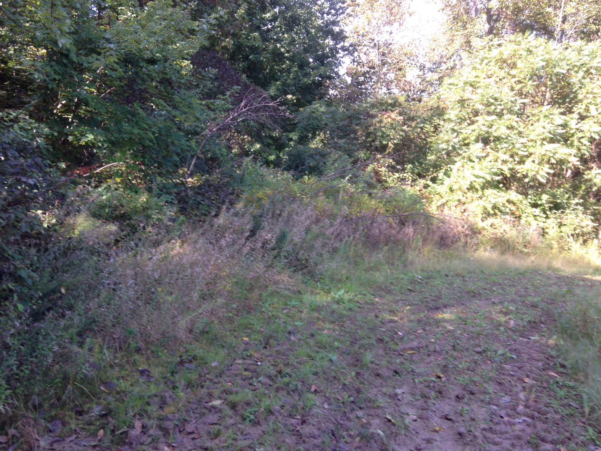

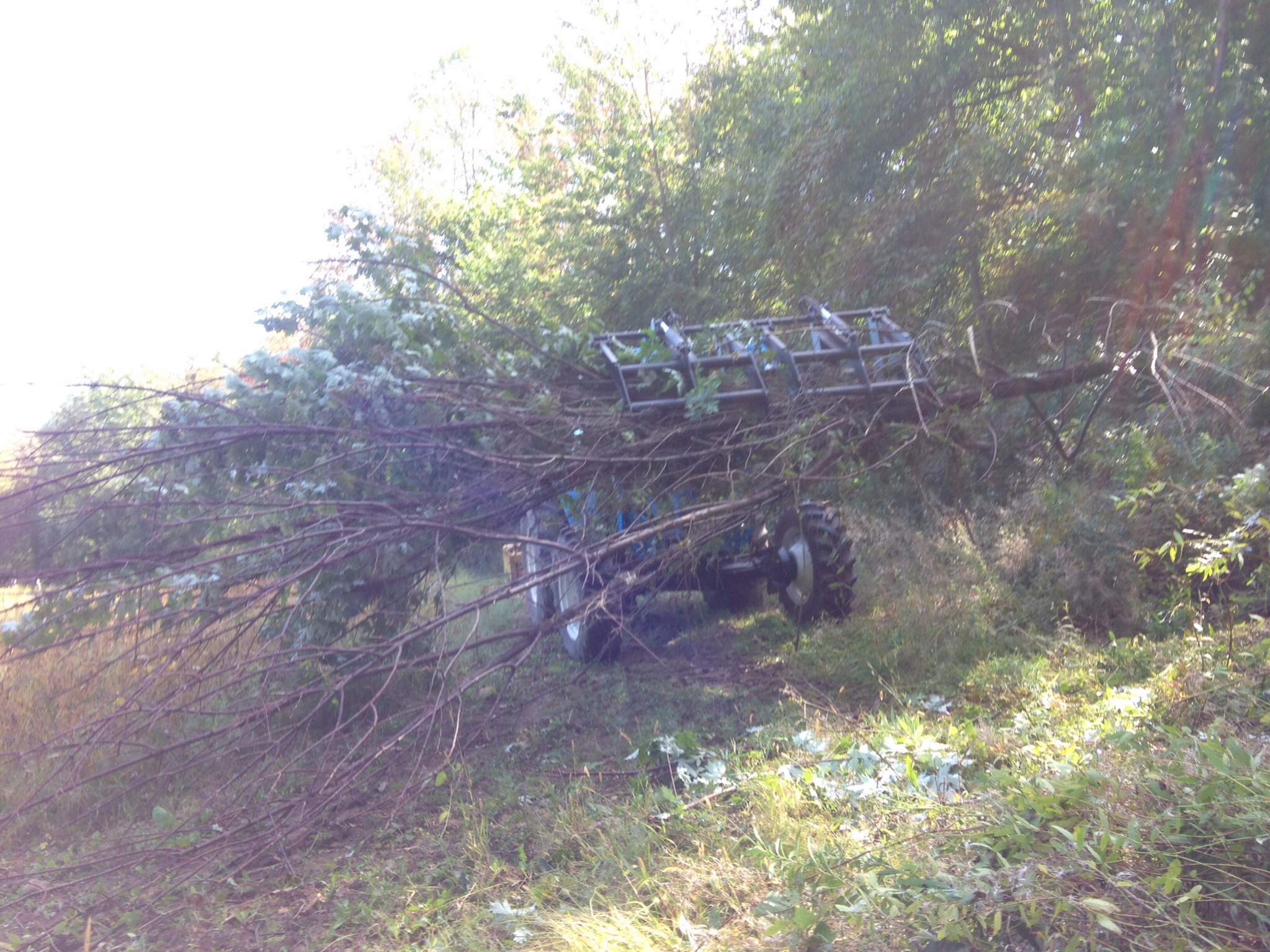

Next I attacked a hedge row with lots of fallen trees. Here's the before picture and a picture of the first "bite" out of the hedge row:

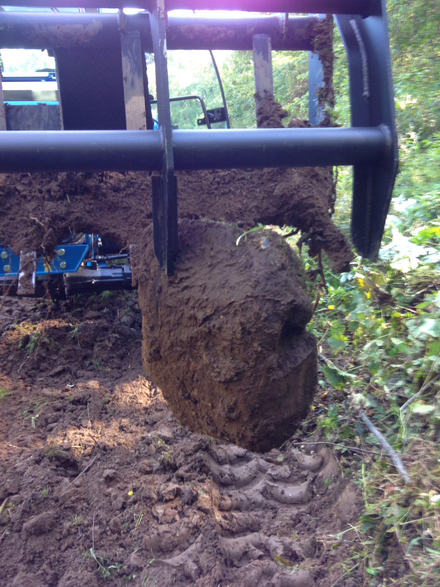

Got a little Rambo and had buried the tines all the way to the crossbar and came to a quick stop when I hit this rock. Didn't bend anything and was able to pop it out very easy:

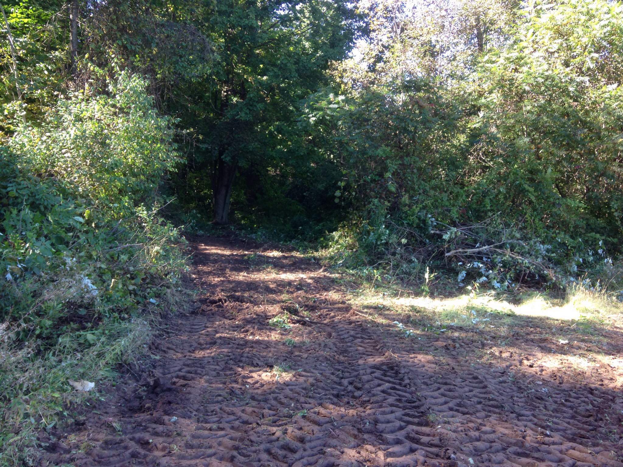

Here's what it looked like when I got through the hedgerow:
Man it's great having a grapple again! :thumbsup:

To be totally fair, I can't compare it to what I previously owned because this large of grapple on a much larger tractor is a totally different beast. I had no where near the lift or weight. Before I worried about width of grapple for digging but not now. You can see how deep I was going on the picture of the rock. If the other style digs deeper then I don't need it in my soil. It can already stop my tractor.
