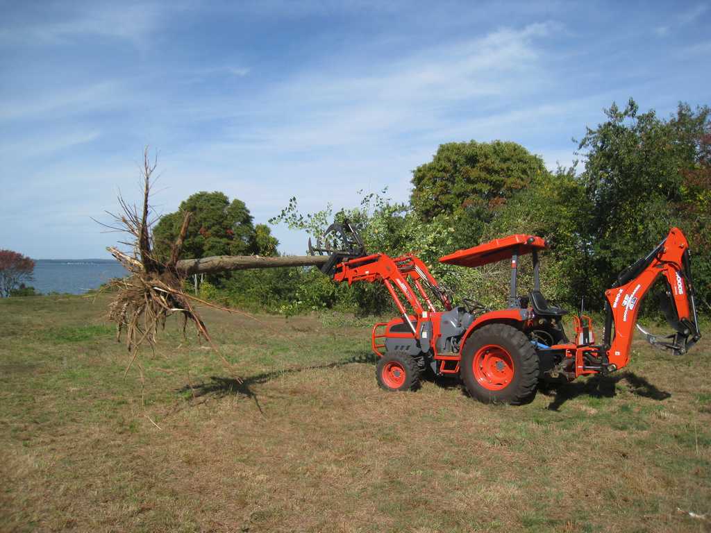

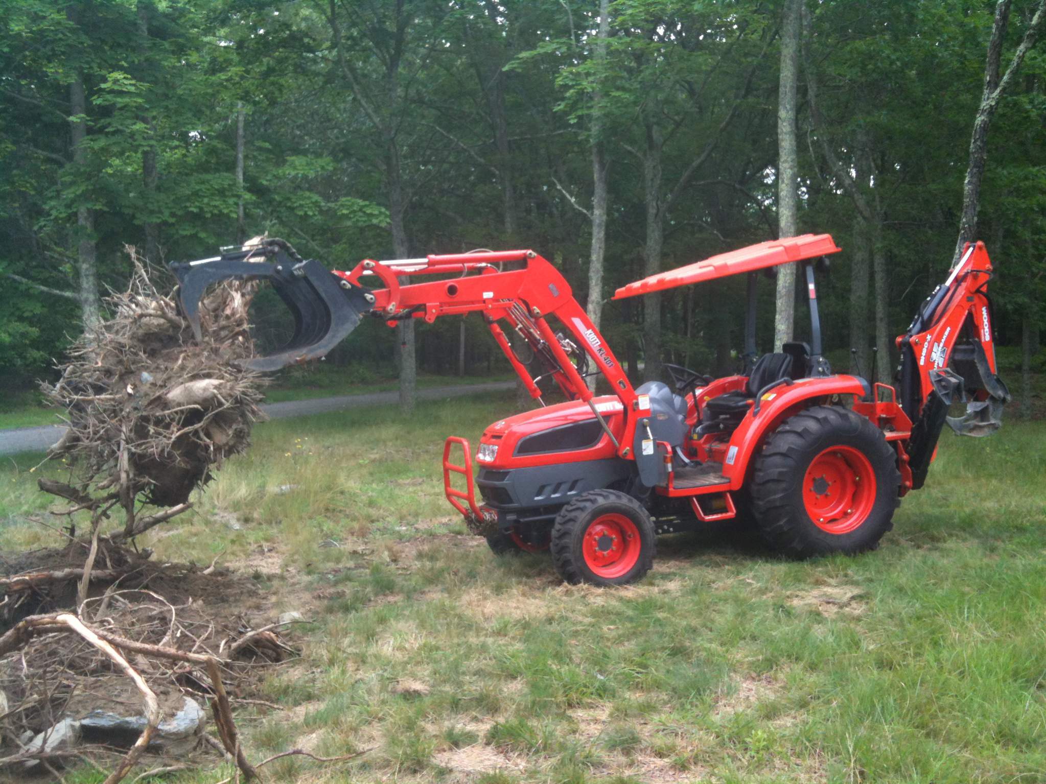

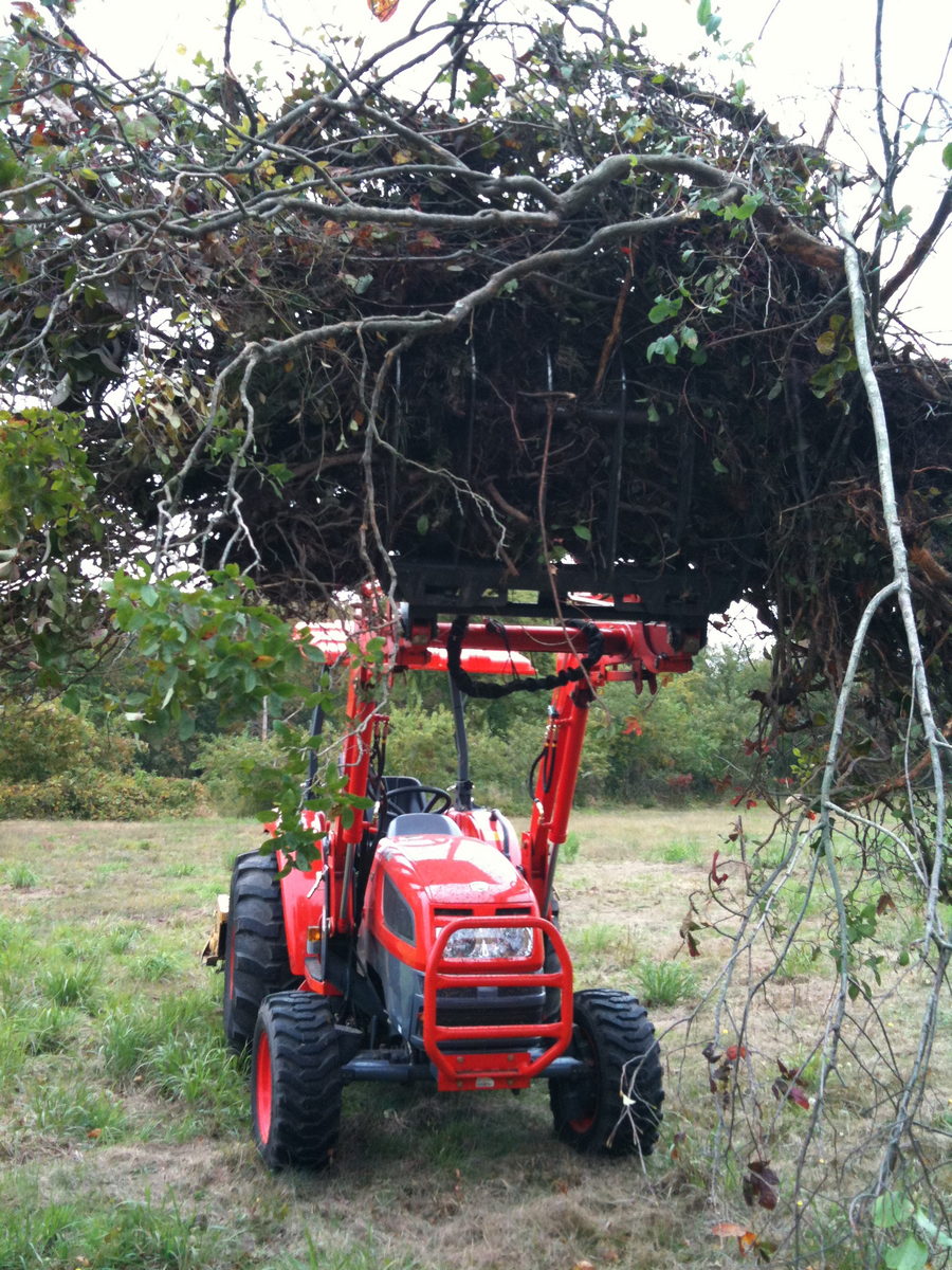

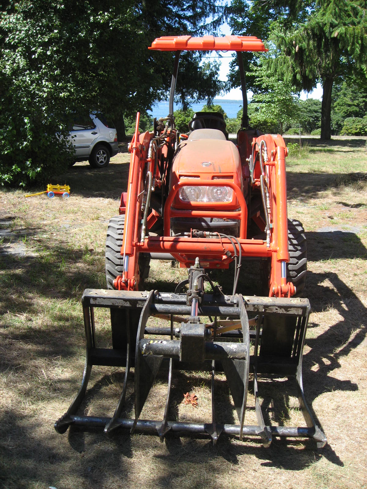

I won't try to be balanced here as I already stated some of the pros and cons of different types. If I were moving brush and logs with an M59, I'd get exactly what I already have, a light duty 48" open bottom style grapple. It is the most versatile, least expensive and easiest to use IMO. There are a number of companies that make them (WR Long is probably the oldest, EA has a really nice selection and there are numerous other companies). Key reasons: you will be able to lift more than one log at a time with an M59 but you won't be able to clamp more than one at a time with a clamshell. You can load multiple logs into an OBG at once and securely clamp them for transport. Brush is sticky so you just put it in a pile (either by hand or via grapple) and then use the grapple wide open to come over the top of the pile, push down on the pile to compress it into the grapple and then simply close the grapple. I've posted a few photos below so you can get an idea of how much can be loaded. Forks are not a viable brush solution despite your photo. That brush will bounce off the forks if you travel any distance over terrain other than a parking lot. The load needs to be secured with an upper grapple arm.
I own a 4n1. I use it only when I have my backhoe mounted to clean up afterwards. It is a total PITA for carrying either brush or logs compared to a grapple. Nearly worthless because of the top hinge which means that anything smaller than the first item to jamb in in the pinch point will fall out when you lift the bucket. It can lift a single log just fine and it can pick up a little brush but it is really next to useless when compared to ANY type of grapple. If I were a contractor taking just one FEL implement with me to a job I might well select the 4n1 if there were digging, scraping, leveling etc as well as grappling to be done but if I were within a reasonable distance of my barn I would much prefer to use one real implement and then change it out for another rather than a Swiss Army knife 4n1 that does a lot of things but none well. Indeed, if working in the woods, I would consider mounting the grapple and then grappling the standard bucket to take it with me if I really needed a bucket rather than using the 4n1.

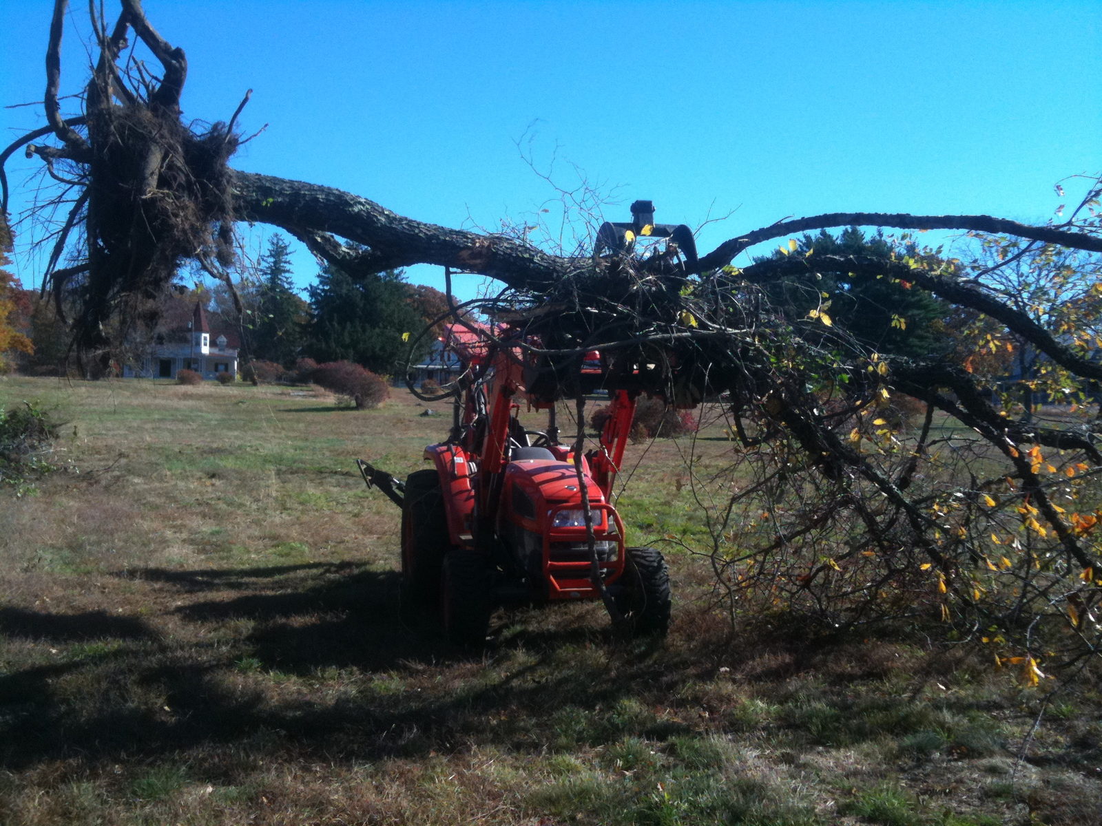

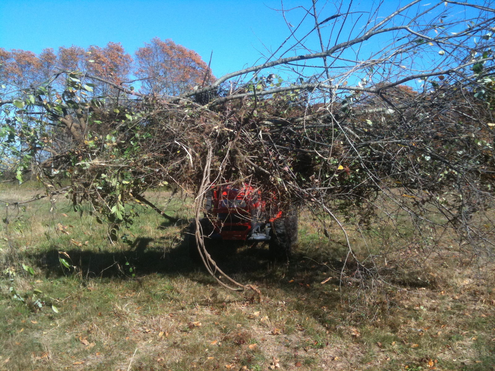

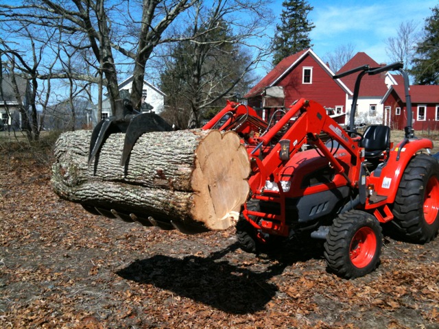

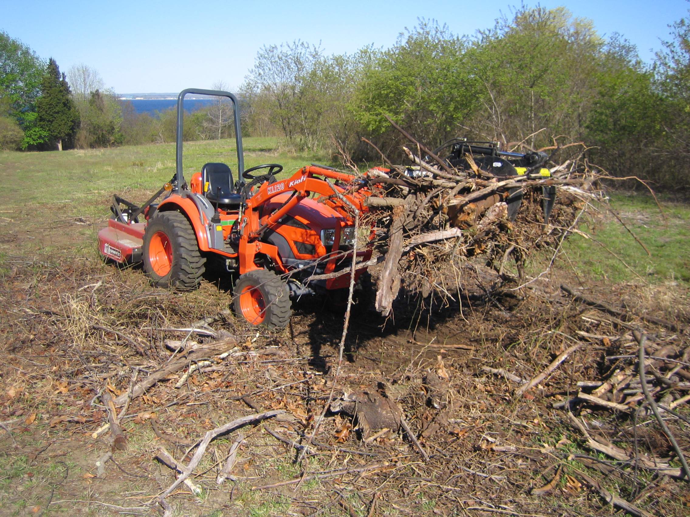

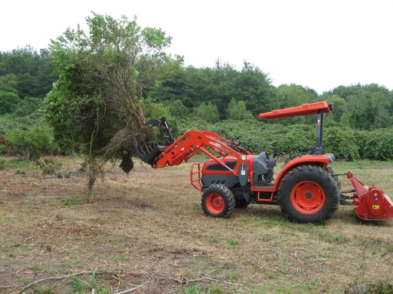

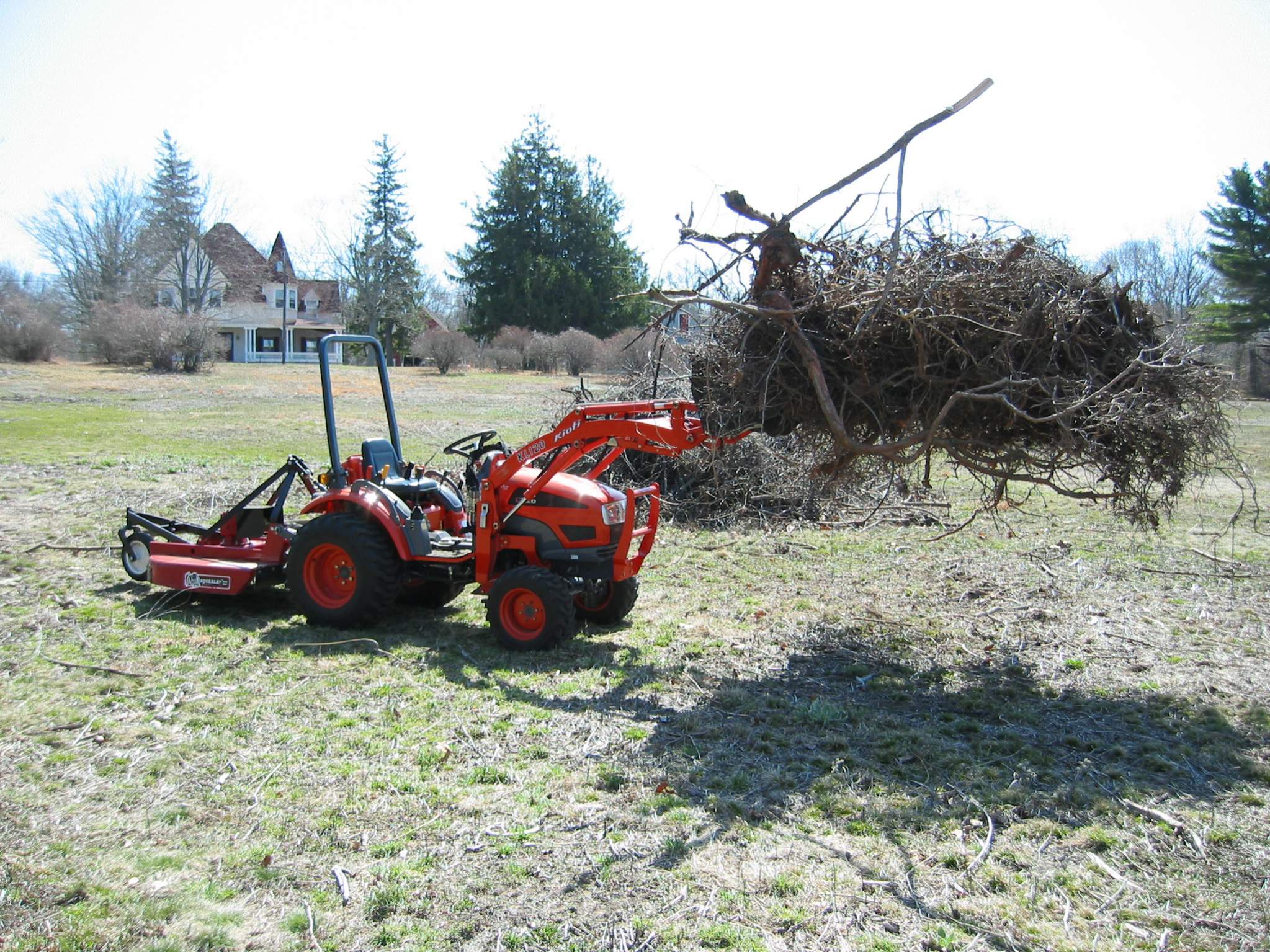

All these photos are either my DK40 or CK20 with the same grapple. DK40 has 2700lb+ lift capacity so not as much as an M59 but you will never likely have 4000lbs of brush or even logs in a grapple at one time so used properly you wouldn't damage the grapple. I beat the crap out of mine but always am careful to line up loads so I don't twist the grapple and I don't ram with it. Grapples need to be used properly regardless of what type or service duty they are.

Island tractors assessment is so full of misinformation it's laughable. Look at the leading edge of his grapple vs mine and you decide what would cut roots or dig better. If all you do is dig stumps buy a freakin' back hoe. And why you wouldn't want to cut/dig/push material as wide as your tractor is just ridiculous.
As far as he's concerned a 48" single top grapple is all everyone needs, you can read it in almost every thread he posts about grapples. He makes assumptions when clearly he has never owned any other style/size or a tractor large enough to handle one, but he can assure you the one HE bought will be the right choice for you. Unless you just want to pick up a little firewood, light cleanup at construction sites and push tumble weeds around any choice but what he made would be wrong.

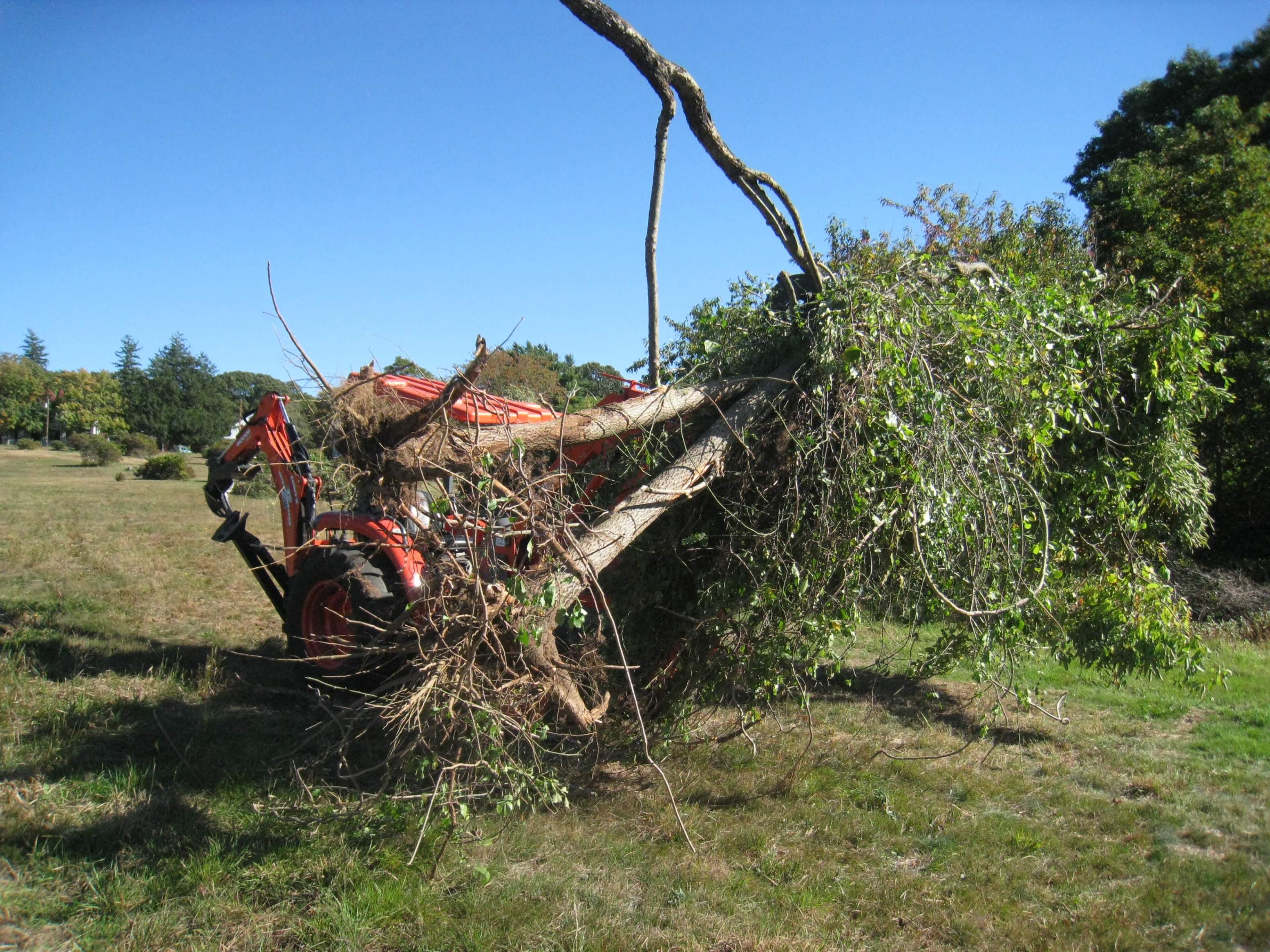

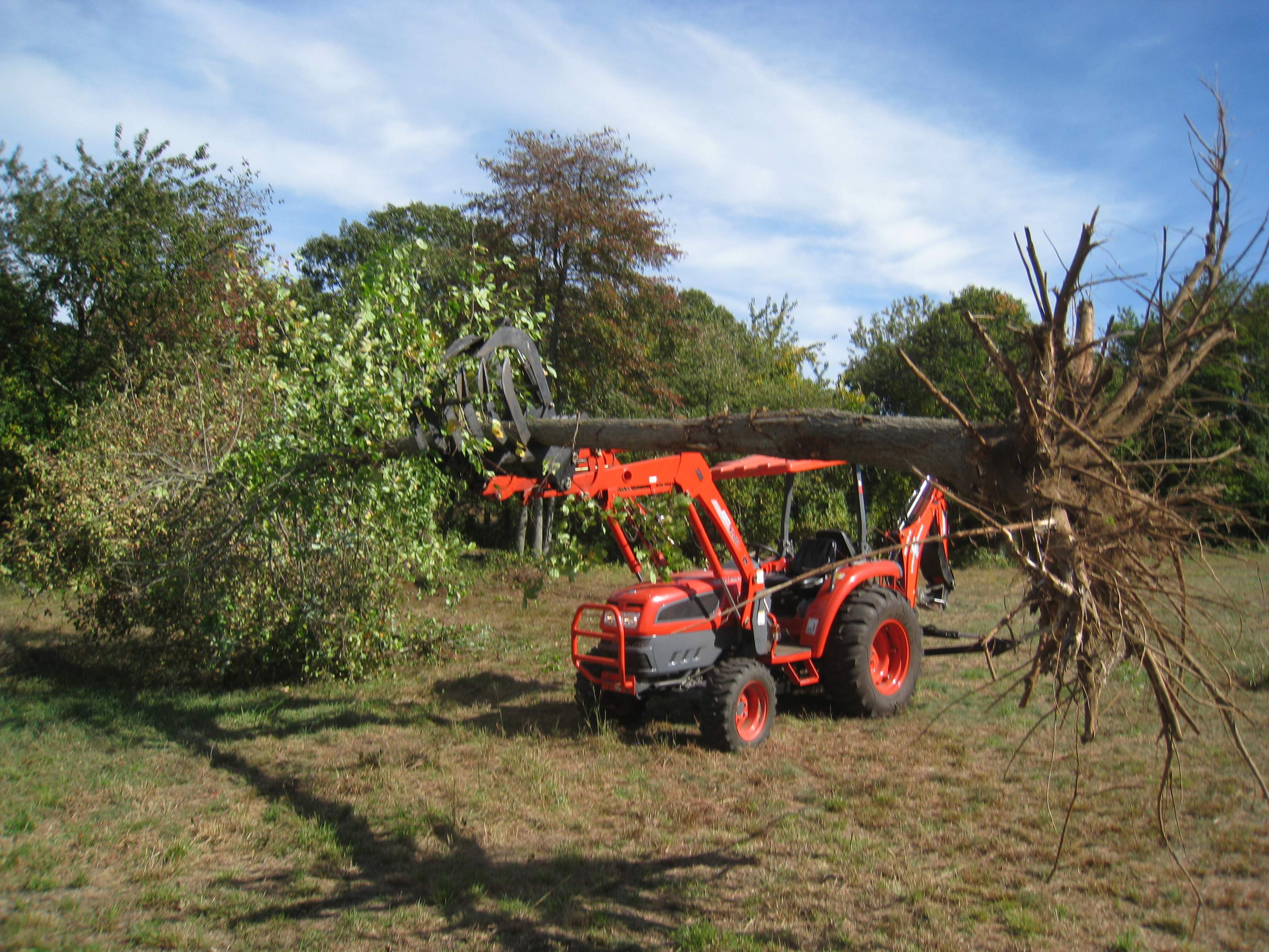

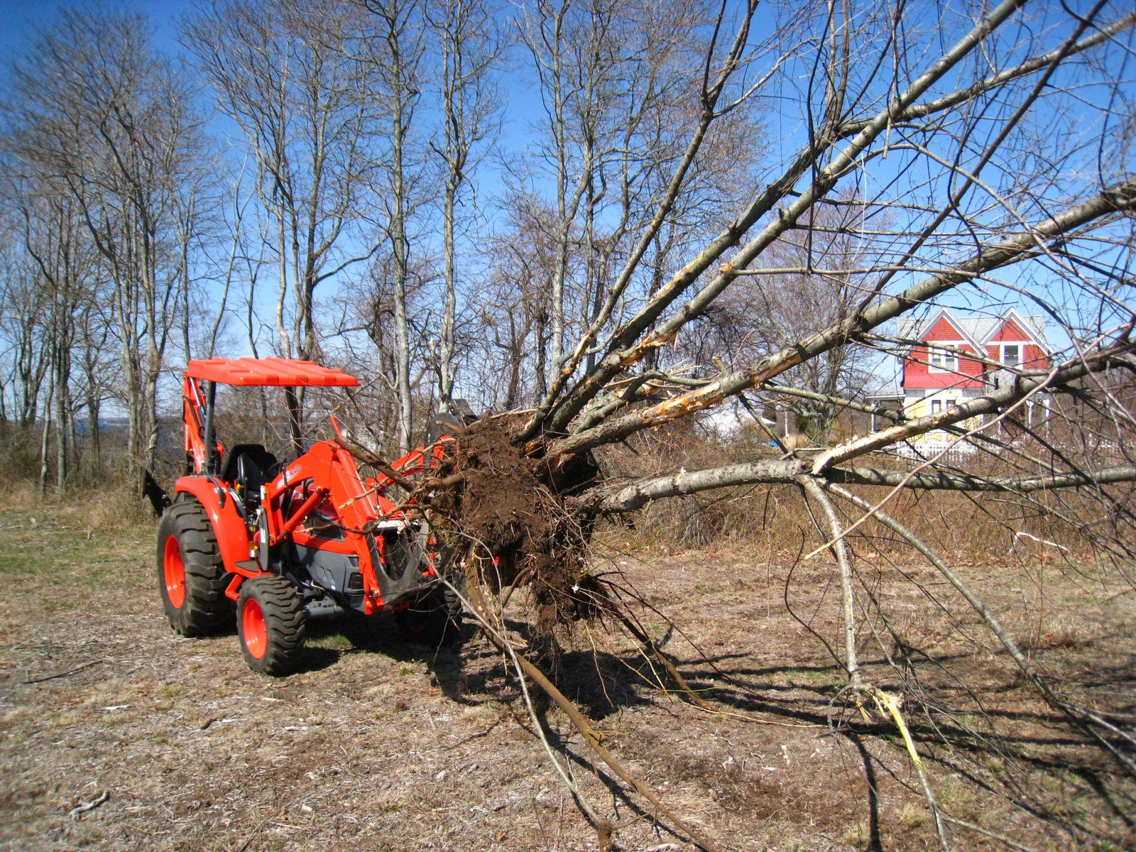

Yes, to pick up a single small tree or log the RBG is better (as is the 4n1). However, even though a single small log is not securely held down, it is trapped in the OBG. You just need to pick it up somewhere close to the middle (which you should anyway to prevent twisting the FEL) and it will stay there. I do it all the time. The only things that are really much better done by the RBG are things like small pieces of firewood or construction debris etc which are both too small to be compressed by the upper grapple arm on an OBG and are also short enough that they will bounce around. When I do need to take material like that I just get a bunch of it together so it is compressed or I through some brush on top of it so the brush gets compressed.
Notice also that with a small tree, the branches stick out and are compressed by the upper arm which holds the whole tree in place even if the trunk is not in contact with the upper arm.
Note the trade off: the RBG could never pick up a whole tree by the rootball as my photo shows because the clamping direction would push the trunk into the ground while with the OBG the clamp allows the whole tree to be upright. Pop it out with the grapple and carry it away.
