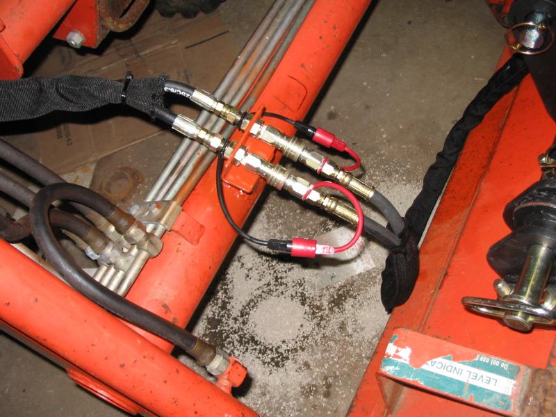

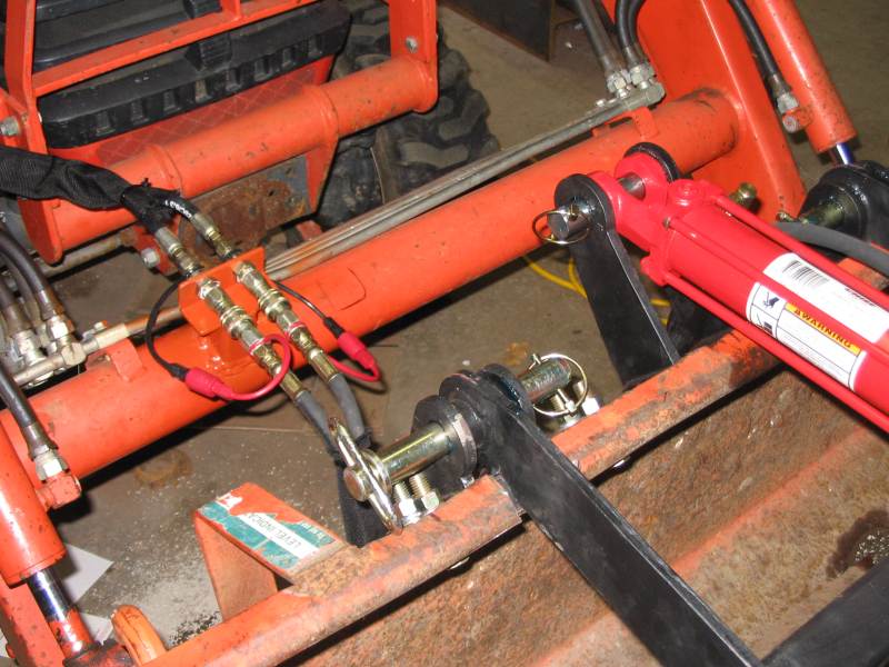

I passed on the WR Long QC kit. Too much money for me. So I did my own. Much cheaper and simpler.

   / WR long valve installed #49
VERY slick, Mad. Clearly a lot of money can be saved with basic fabrication skills - that I'm sorely lacking. I'm a software guy, after all!
-Brian
   / WR long valve installed #50
So am I, but that doesn't stop me from having other hobbies and interests.:D
