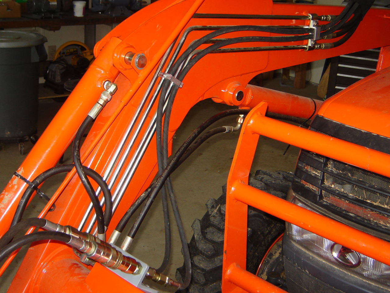

Wish I had known about that 2nd kit. I spent a lot of time making my own bracket and finding fittings, adapters, etc for a bulkhead. I did use those two screws holding on the hard line cover. Picture attached.
John

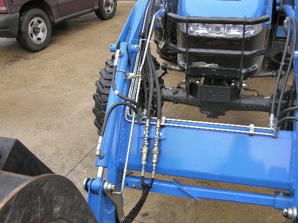

MadReferee said:
I passed on the WR Long QC kit. Too much money for me. So I did my own. Much cheaper and simpler.
We did basically the same thing to our NH.
