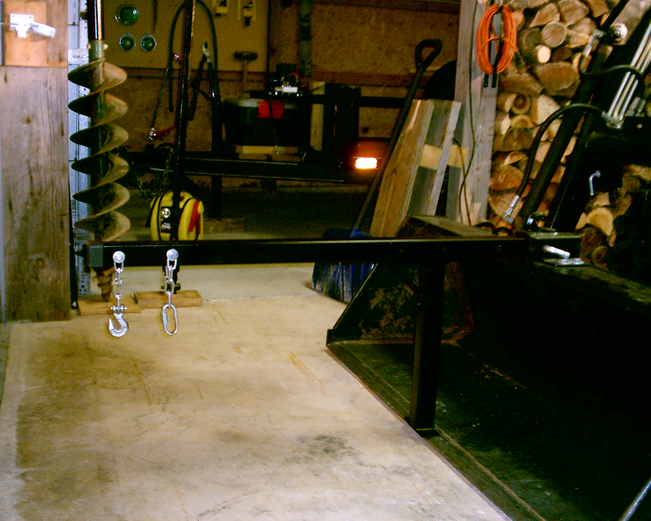

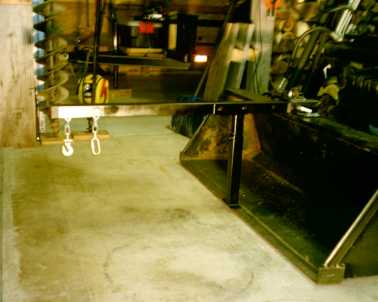

One of the best things I did was put a Reese Hitch tube on the top of my FEL bucket then make a boom pole. Total cost was about $35 plus my time. Maybe $50 today with the price of steel. I welded the hitch tube to a piece of 3/8" plate about 12"x6" and then made a doubler to go on the underside. The support leg for the boom pole is adjustable so I can use it with another tractor at a later date.
I use it about every time I use my tractor. It works great for lifting heavy big items like my Bush Hog on and off the trailer while keeping the tractor a foot or two away form the fenders. Also keeps what you are lifting away from the grill of the tractor.
Here is a pic.
