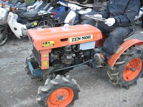

Oh, and you confuse me with the B6000 and the ZB6000 interchange terminology. You said you had the Zen Noe (sic) "repaired" and now refer to a B6000?? If you have a "Zen-Noh" it would be a "ZL1800" or something similar?? The B6000 is a Kubota.
Yep, sloppy keyboarding. Its a Zen-noh ZB6000 which I was told was basically a kubota B6000 made for a rice paddy cooperative way back then. Its one of the first they made apparently and the pto spins opposite direction to normal tractors.

Thanks for replies.
The slasher is 155kg (~340lbs). That's a biggish weight and could cost a bit when there is no mounting bar to speak of.
I'll look into the costs of this option.
The mechanic have quoted $450 to fabricate rear jockey wheel, plus fitting.
After 2 weeks still no price on front weight mounting. Could end up expensive.
I am in agreement with the masses.
Fabricating some type of weight system to the front would be the first thing I'd do.
I attached a picture I found and it looks like you could easily fabricate some type of mounting plate on the front of the frame and then the sky's the limit on what to use for weight.
If you can find someone selling an old weight set (weight bench, dumbells, etc) you could use the weight disks / plates from that easily enough or just build a box and fill it with rocks.
Unless this is a Per Wheel Price and not for the pair, the second thing would be to find a new mechanic. :eek:

As others have noted, suitcase weights or a homemade version of front weights are the way to go.
As far as your JD lawnmower: I had the same problem using an old craftsman on hills. I just put on the tire chains I use when removing snow in the winter and it solved the problem. The chains stay on year round now. On my previous riding mower, I just swapped out the turf tires for ag-style tread. That also worked fine (I'm not going for the manicured, golf-course lawn look, so the occasional tread mark on the lawn does not bother me.)

To everyone that replied with ideas on front weights, thank you. If this works, it will be easier and probably cheaper than selling one tractor and buying another tractor in the $5000 price range. And I still might needs weights on the front of the new one.
The mechanic has envisaged a mounting for barbells (gym equipment) on the front just like Steve suggested. Second hand barbells are not common in this area, perhaps in the city might be easier. The concept is sound though.
I am also considering making some concrete blocks in 50kg sizes with inbuilt reinforcement rod loops to hang them from a frame extending out.
Thanks fellas. I have more searching to do.

The little 1M slasher does not have any mount points for rear wheels so the mechanic would need to fabricate the mountings. :( That's why its expensive.
Well bummer. At least the pricing makes a little more sense now.
Good luck in your search. I think you're on the right track with a weight system vs a new tractor.
