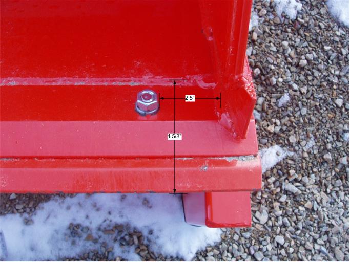

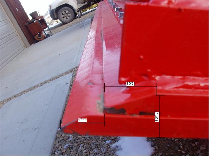

I have the L2296 72" HD round back bucket. It weighs 400# compared to the 330# for the standard Square back bucket. They both hold the same. I have attached a few pics with dimensions on them for my bucket and cutting edge. As far a lifting capacity I show 2 different weights at the pivot pins, One at full extension, 1684# and one at 1500 MM, which is 2154#
I'm going to make a template of how I think the teeth should fit and see if I can match up any of the shanks I have found. The YA190 may work with a little grinding. After the factory cutting edge, the inside of the bucket raises another 1/8 - 3/16".
If I didn't like winter projects, I would just buy the bar. It's not about saving money since the shanks cost so much but rather keeping me busy.

Nice illustrations. I'll check my bucket edge thickness but in looking at your pictures i'd guess they are pretty similar. I'm pretty sure that CA modified the shanks to accommodate the horizontal support thus keeping the two edges on the same plane. I can show you where they machined they shanks. The TB-8000-2A shank will support up to a 1.5" bucket edge so in theory it should work with your bucket. The shanks are about 1" shorter than the ones on my bucket but from the picture you can tell they are plenty long with plenty of room behind the bolts.

I measured my Bucket tonight the total cutting edge thickness is 1 3/8" this is the measurement you measured at 1 3/16" in the first picture. the 4 5/8" measurement in the second picture is 6" on my bucket. the first bolts are spaced out a 2.5" as well. Almost certain the other shank should work
   / X-treme Duty Extended Tooth Bar - Valentines Day Present for my Tractor #28
Ordered the YA190 from Tractorpartmart.com. Shipping seemed reasonable considering how much they weigh. I ordered 10 of them for a total cost of $248. Not sure I will need ten for a 72" bucket, it was better than being short and I may end up with spares. I have been reading on spacing. From what I can tell most are spaced 8-10 apart, measured between the shanks on the bar. For a little overkill I'm going to plug weld the shanks to the bar as well.
