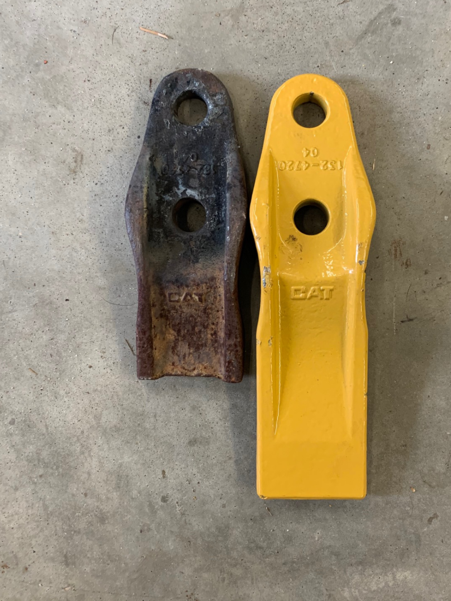

Thats a lot of scrapping to ware down bucket teeth. And why cant a bolt on tooth bar be added to a skid steer bucket?
I have a picture somewhere that I will post that shows the old teeth and the new one. .. the way the Cat bucket is, only allows for one or the other..cutting edge or teeth. The bolt on teeth won't fit over a C.E.
   / Bolt on bucket teeth #12
Think I got about all I could out of these teeth.

Now that's what I call getting your money's worth, how much are new the new teeth?
   / Bolt on bucket teeth #14
I don't recall, Maybe 300.00 ish for the set with bolts.....but not certain.
