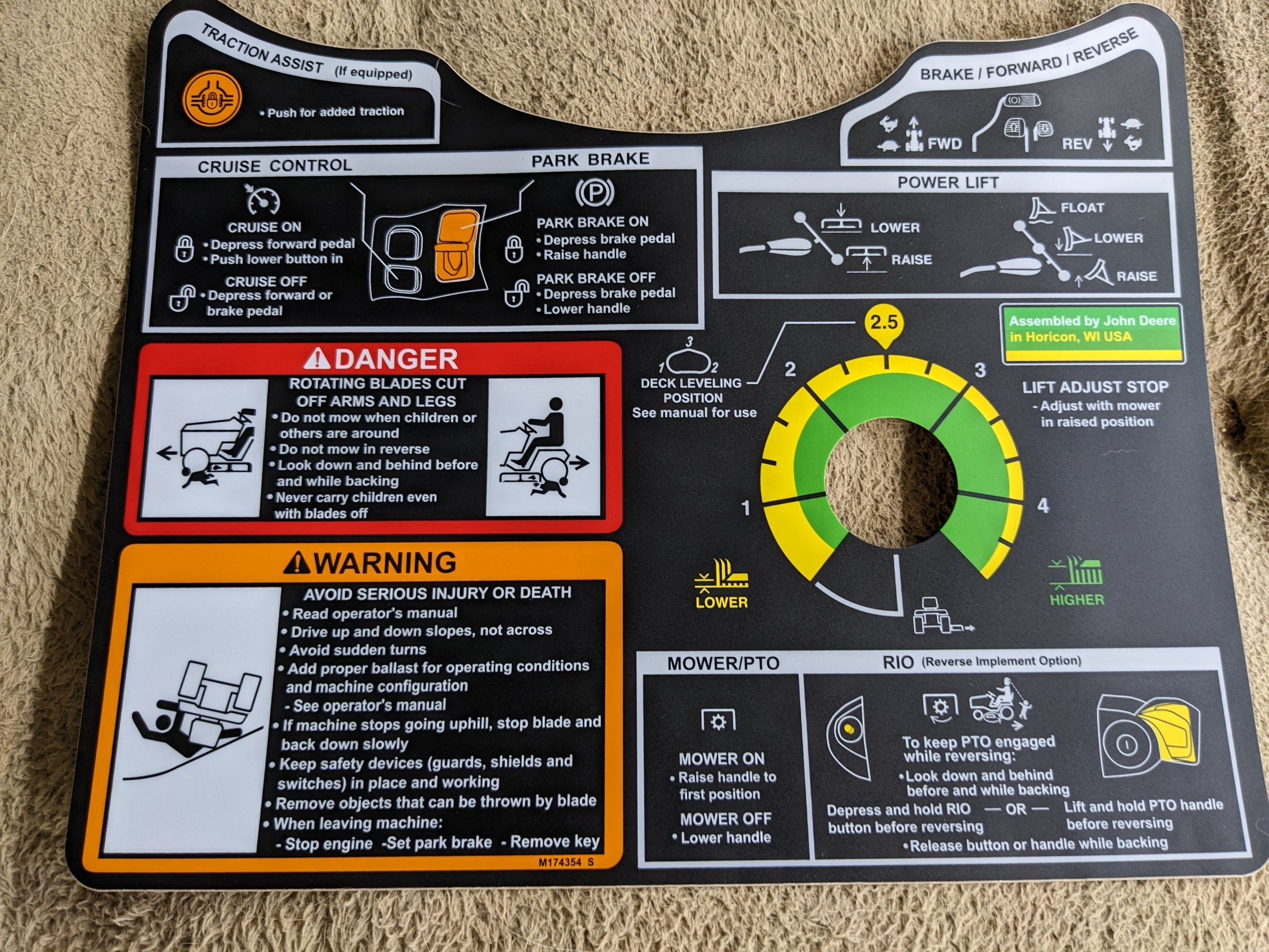

Spacers under the head of the adjusting screws? I did the same. I think I am going to try the rocker shaft replacement and see what it does. I'm also going to replace my tunnel decal as mine has 2.5" cut at the 12 oclock position. Seems they updated this and 3" is now at the 12 oclock position which is much closer to what it should be.
What is the Tunnel Decal you mentioned? I'm not familiar with that?

I had it wrong in my mind. My machine has 3" cut height indicated at 12 oclock. I saw somewhere on a post that there were different decals so I started to look.
If you zoom in on #22 which refers to M174354 you will see that the 10:30 oclock is 2" 12 oclock is 2.5" and 2:30 oclock is 3" This puts the deck 1/2" higher than the decal that is on mine so it should be pretty close. Its tough to see in teh picture, but the 2.5 that is used to level is clearly at 12 oclock. I posted a link to another forum that had a better picture.
