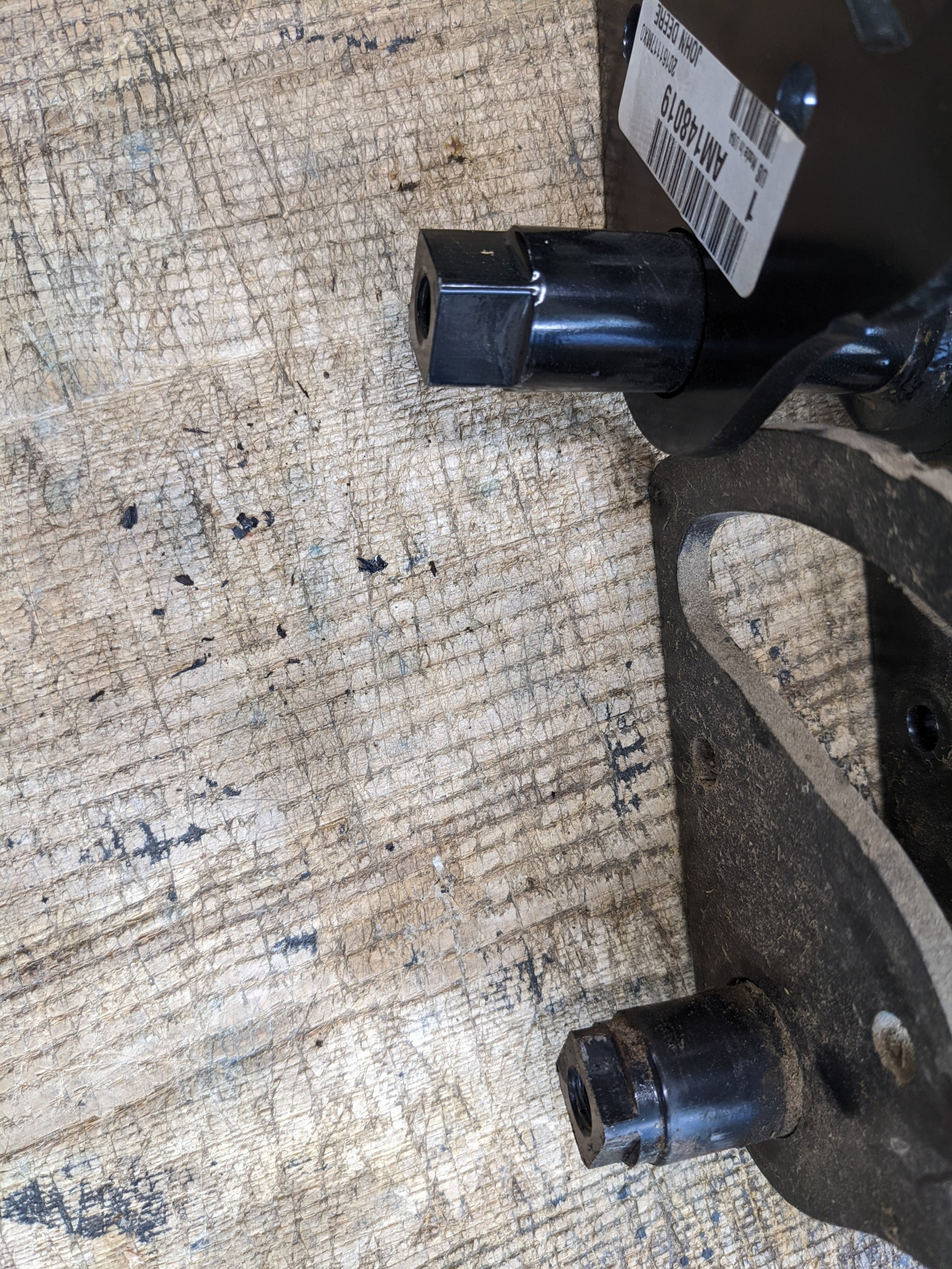

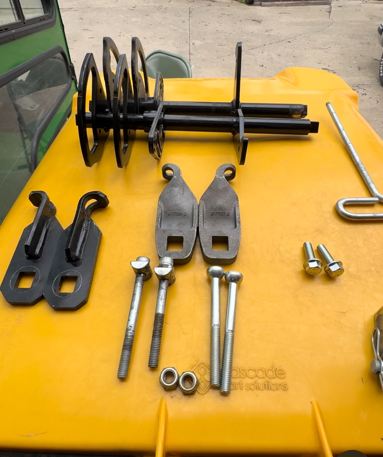

New rockshaft requires new end links and bolts also. Old one has one bolt that is LH thread and one that is RH. New one has both RH. The squares are much longer on the new shaft so teh new end links are also wider so much greater surface area. Looks like the new links eliminated the half moon cradles for the lift bolts as well. More parts coming.

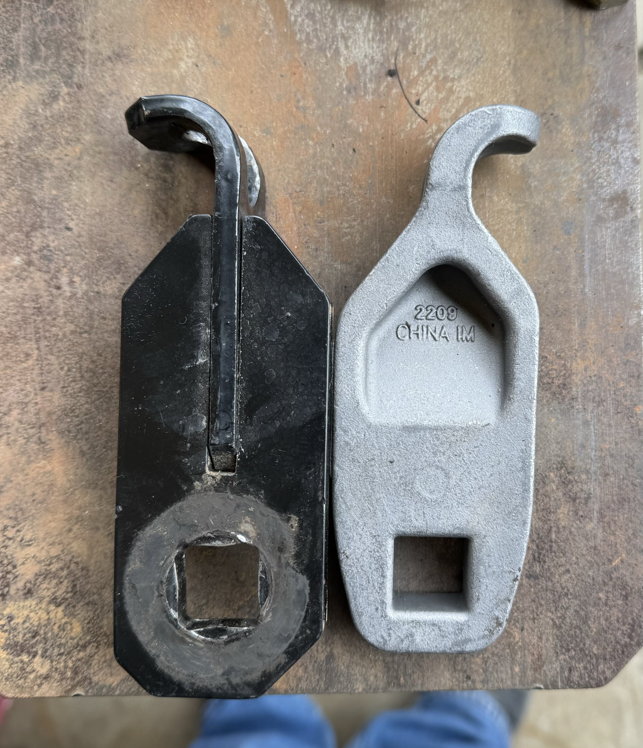

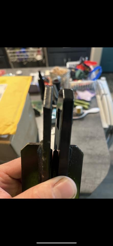

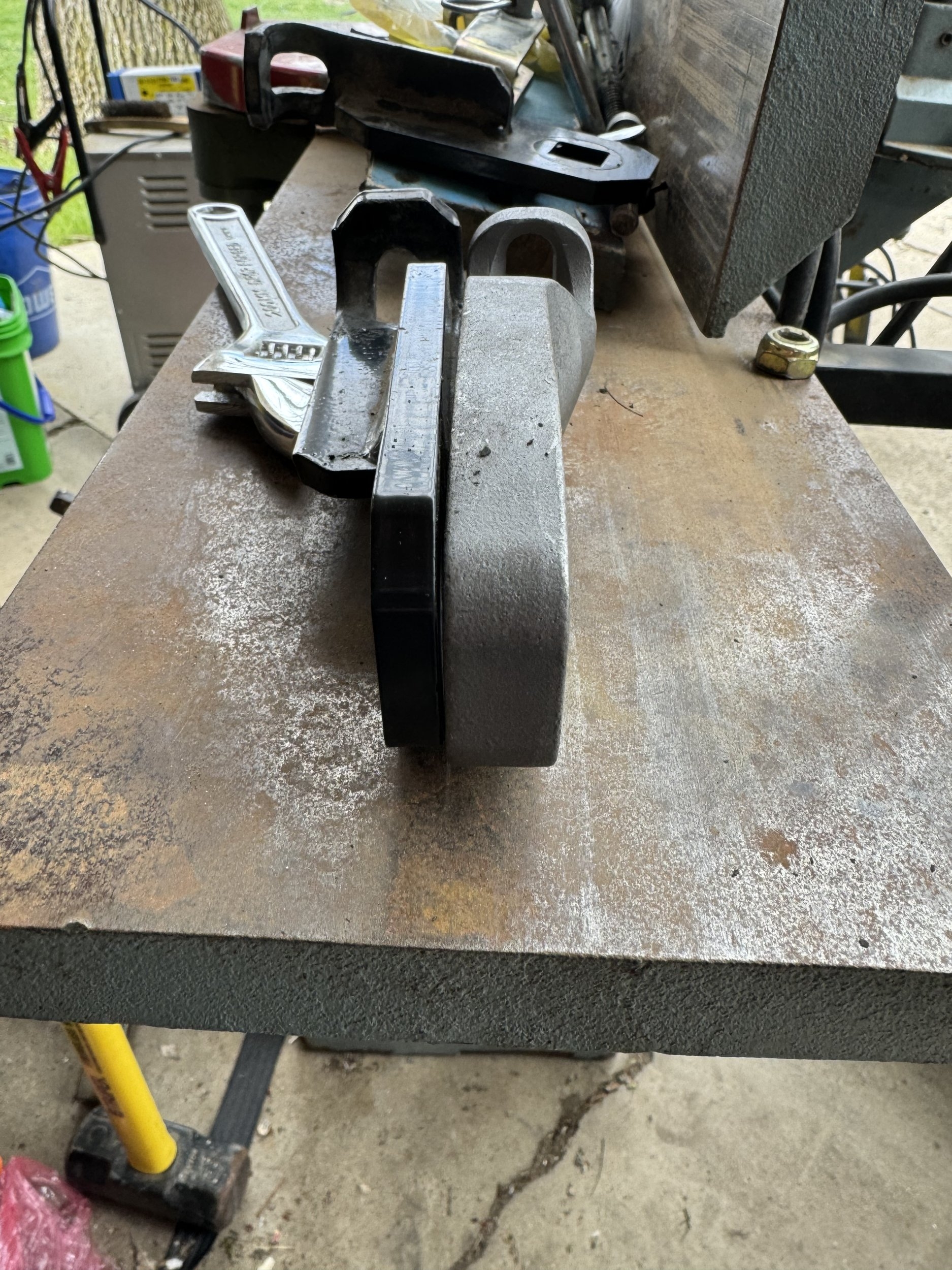

Here is a side by side comparison of the old lift arms vs new lift arms:
Top view: old on the left, new (M177098) on the right.
End view: old on the left
Side View

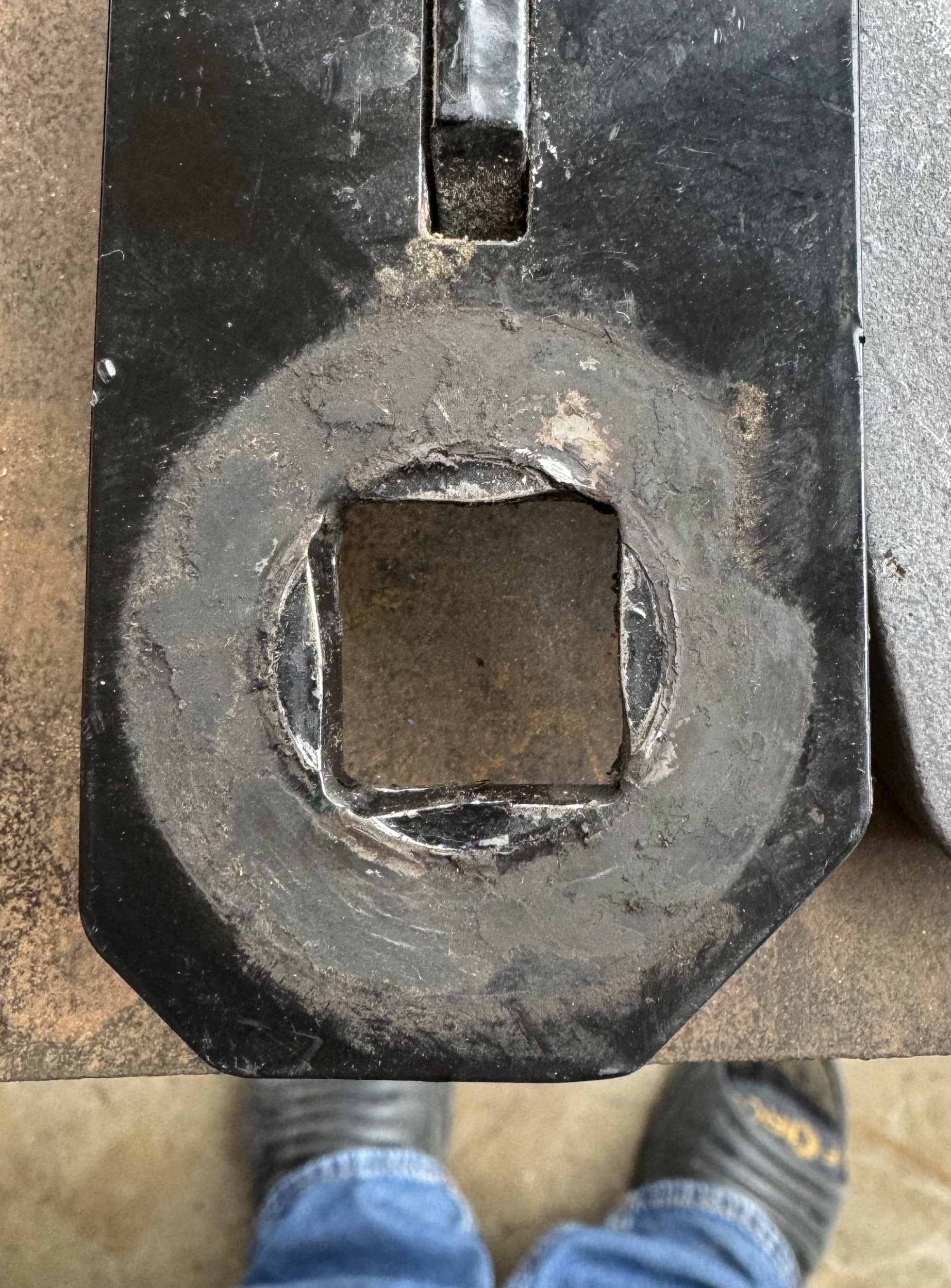

Better image of the wear on the old lift arms (below, left side arm). Holes are a bit rounded in the corners. I'm pretty sure that the original shaft was probably ok, it was just the slop created when the corners rounded on these older lift arms. I put them on the old and new rock shaft and there was a considerable amount of play, especially on the left side. I could wiggle the arm forward and back with at least a 1/2 inch of play at the end of the arm. This, spread out over the width of a 60 inch deck was considerable. The gentleman from the facebook group mentioned below in the instructions for serial numbers 042350 and lower, said that he kept his original rock shaft and replaced the lift arms with the parts recommended for his serial number, and that fixed the issue for him. I probably could have done the same and saved the cost of the newer arms and rock shaft.

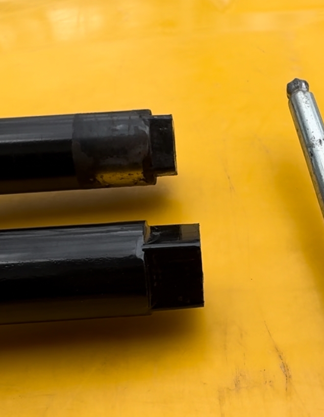

Old and new Rockshaft comparison. Old on top, new on the bottom.
Old and new parts shown together

Here is a picture of an original lift arm (on the left) next to the newer lift arm (on the right):
(image credit from a fella in the Facebook group "John Deere 2006-Current X700 Garden Tractor’s")

thanks for posting an update, does the new rock shaft have a longer male square drive to engage fully with the wider (deeper) female square drive of the lever.
   / X758 Deck leveling problems solved #68
Yes, it does. I have to update the post again, ran out of time on Saturday. I'll add a picture of it.
Edit: Images added to the post above.
