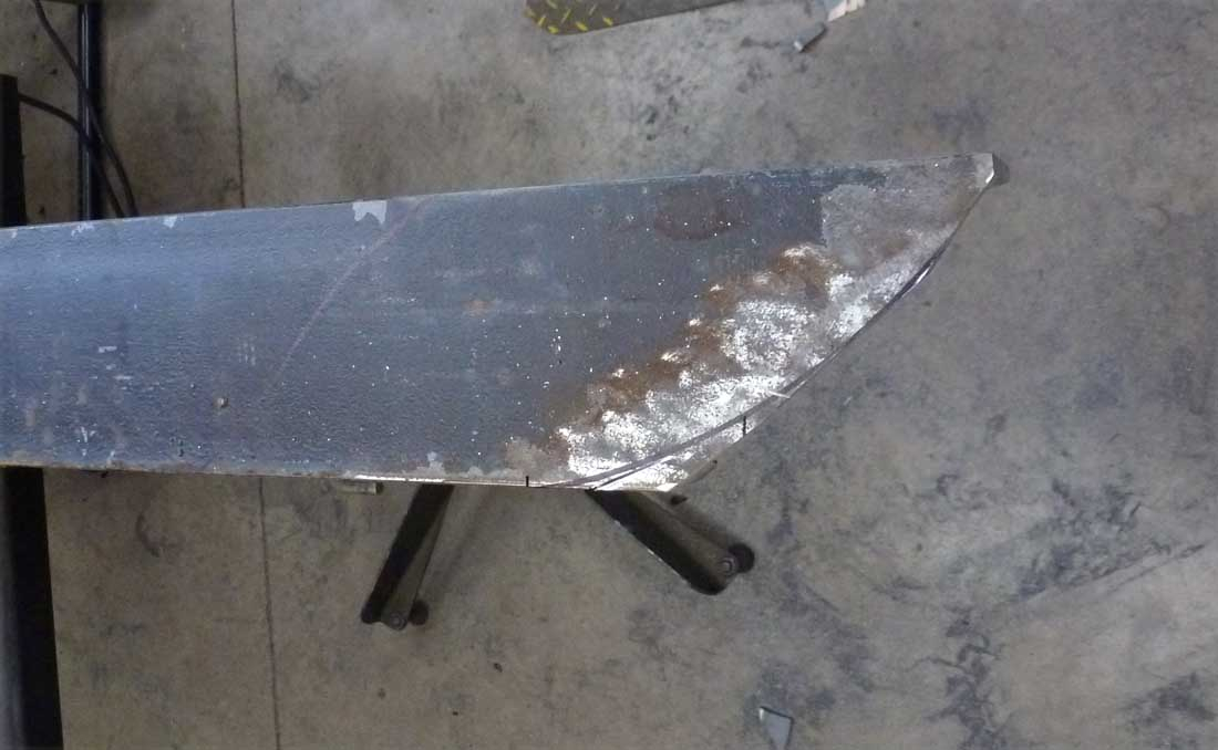

Here is the teeth on the last drag I built. These worked well and lasted for many, many K's. I'll do very similar teeth on the Groomzila. Note there is no spring system for impacts and they didn't get severely bent.
What will you be tow this machine with? How wide of an implement are you planning on?

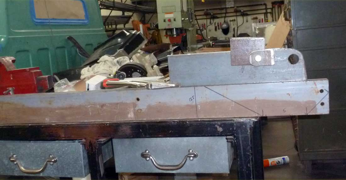

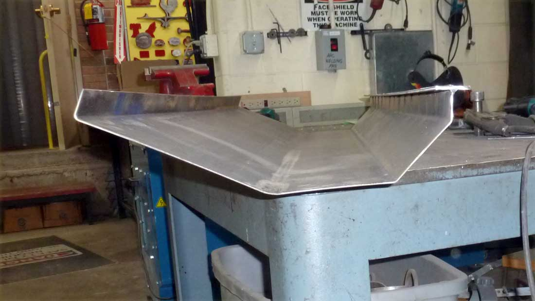

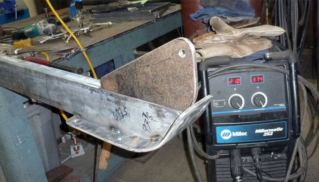

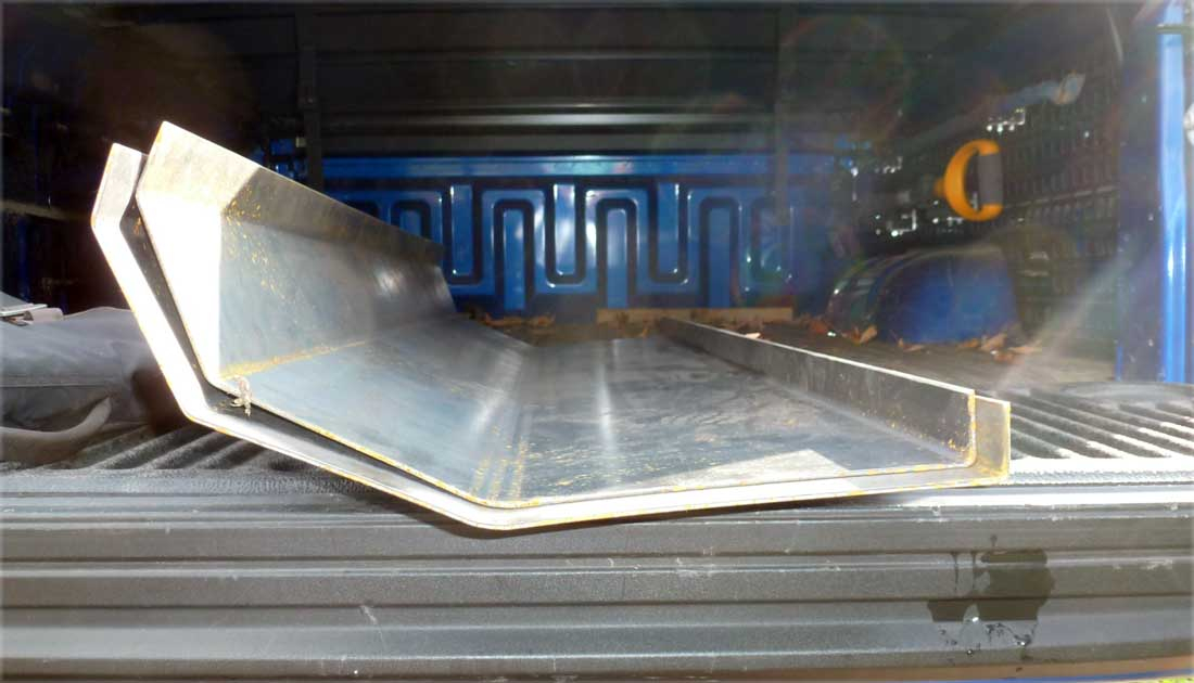

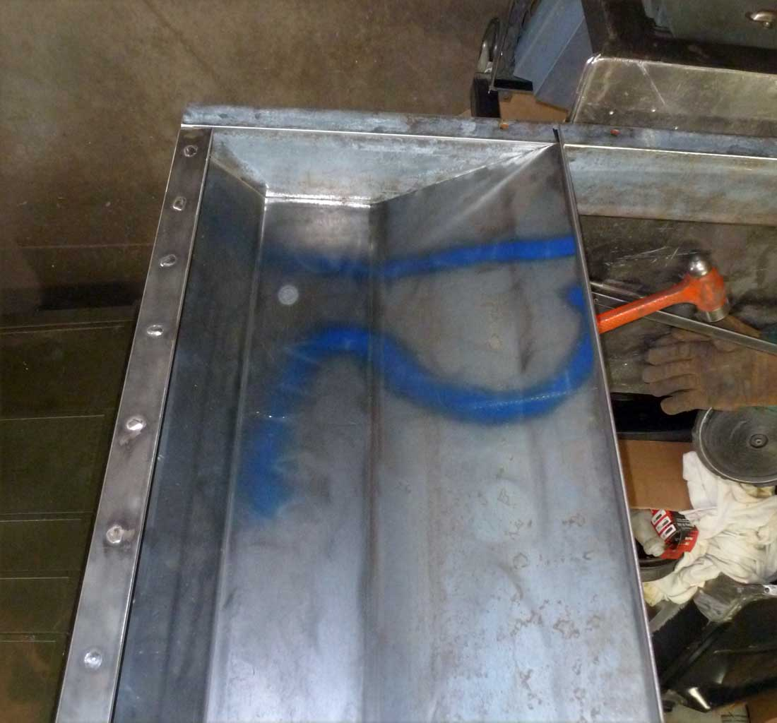

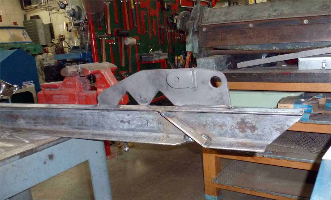

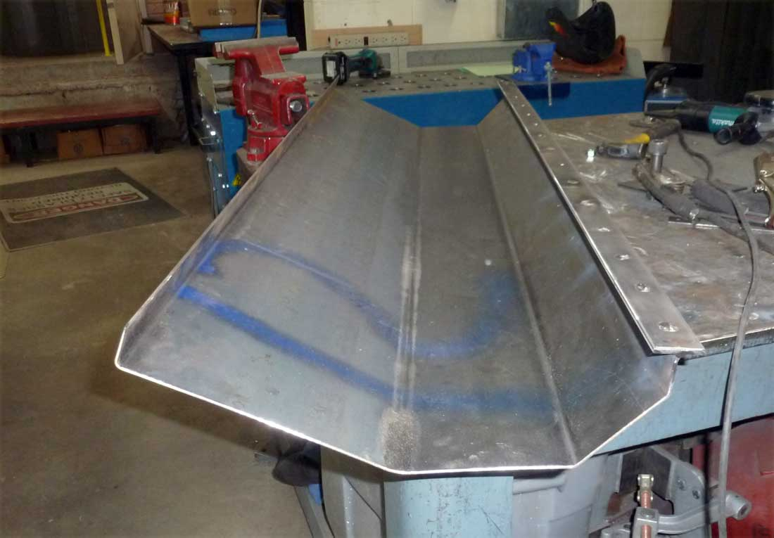

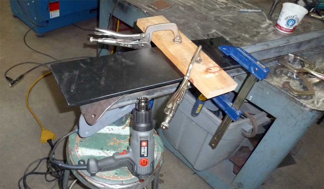

Heading into the shop tomorrow and try get something serious done. 🤣 (I hope) Here is photos from this past week there. This is 3/8 HDPE you see here getting warmed and then bent. These will have 7 bolts holding each on. Any questions?

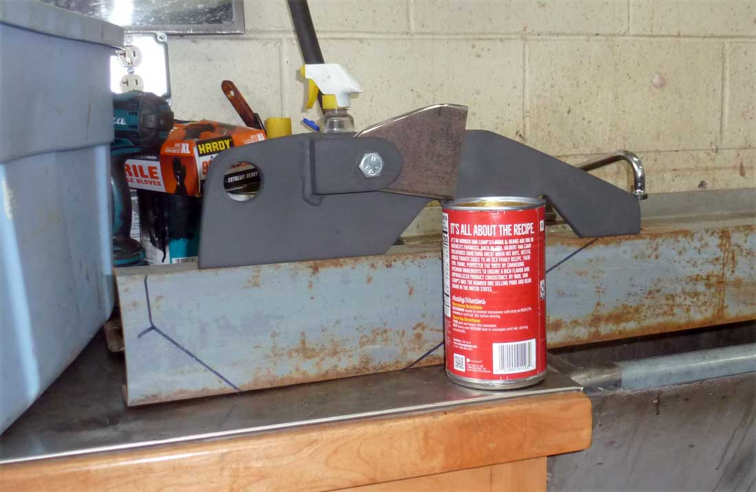

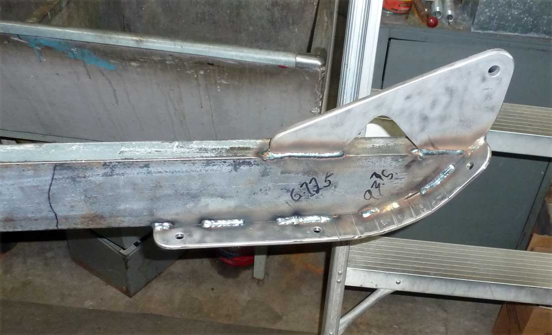

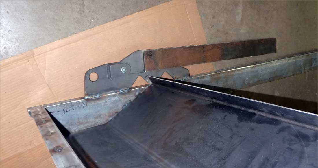

#95

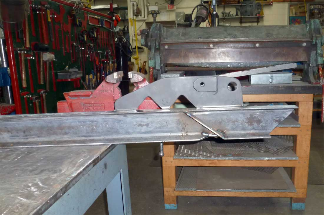

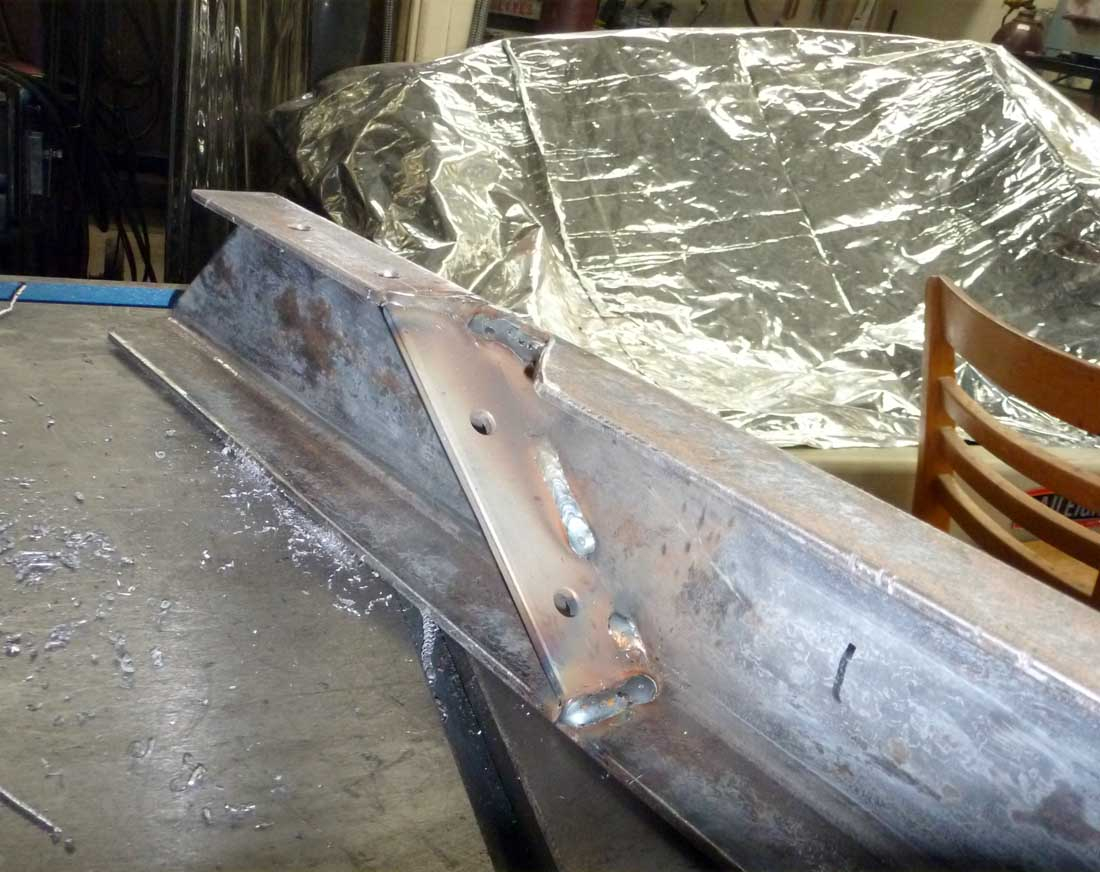

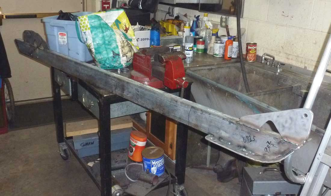

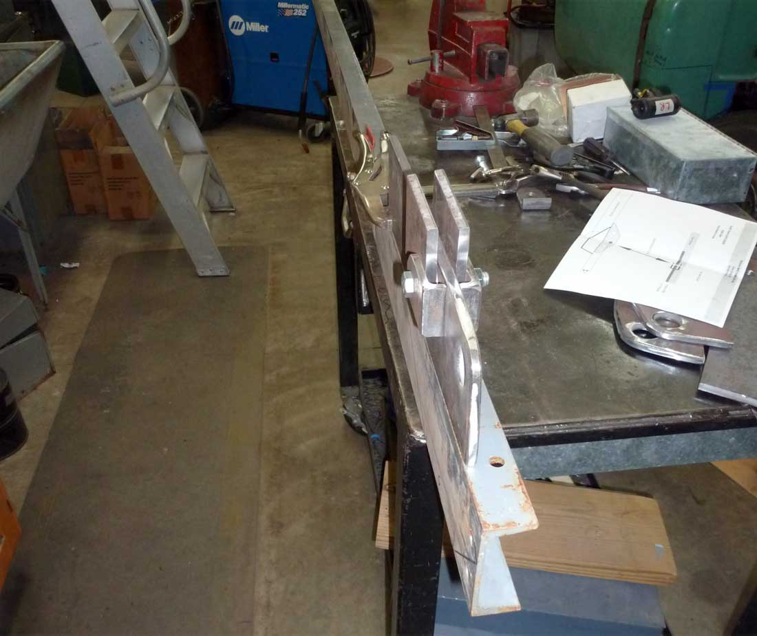

Yesterday I cleaned parts, then primed and painted. I like to use a sand blaster but these were to big.
Then I tacked them together.
