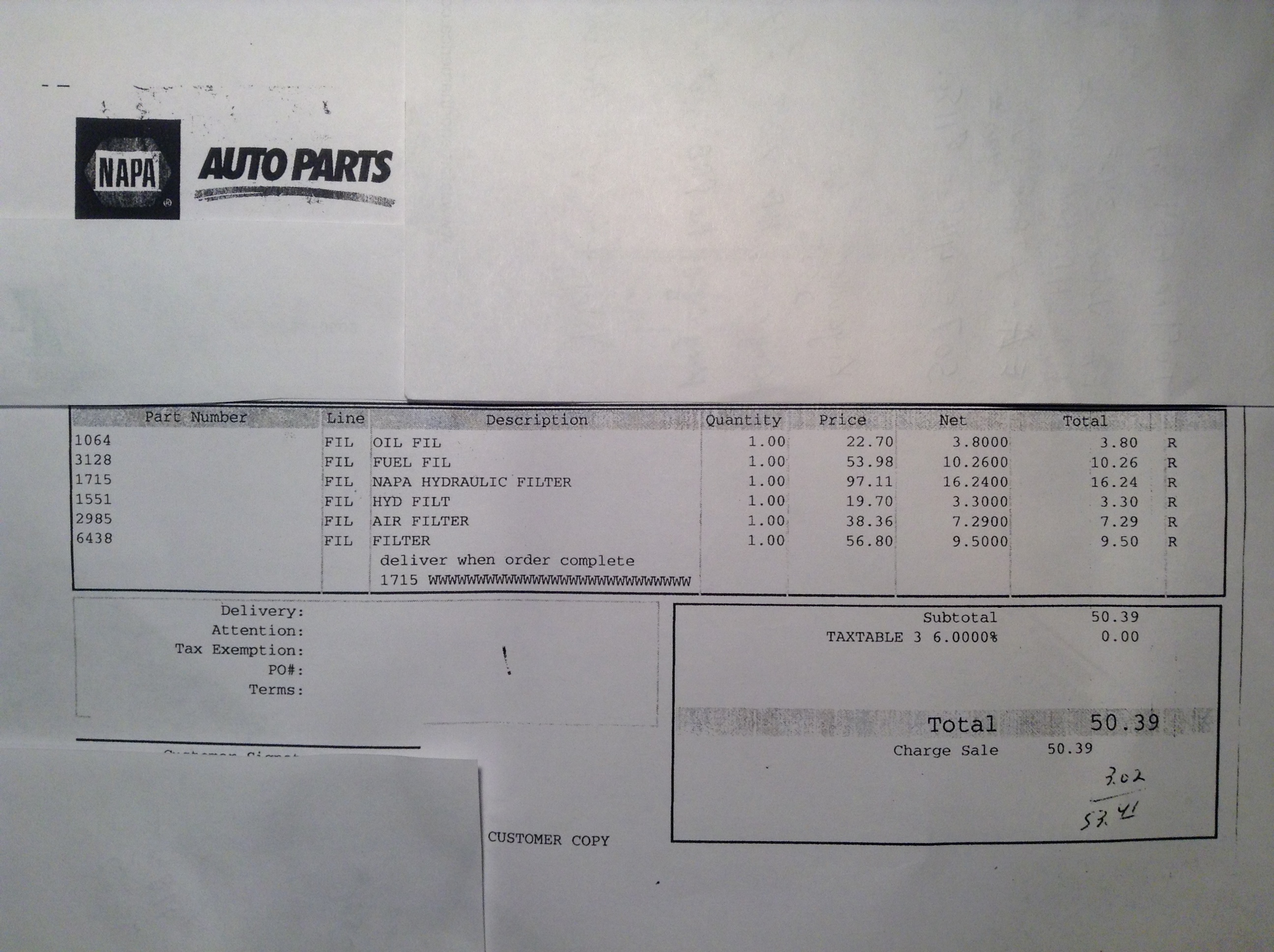

   / xj2025 first oil and tranny oil chg?? help #14
You did what at 50,150,300??? Engine oil and filter and both hydro filters??? Where did you buy the filters?
I changed engine oil & filter, the hydro filter, and the hydraulic filter at 50, 150, and 300 hrs just for extra measure, I have not changed the hydraulic oil yet.
You will not lose much oil changing the Hydro transmission filter, but when you change the main Hydraulic filter oil will pour out like crazy (use the shop-vac method)
I get my filters from NAPA (fleet discount)
