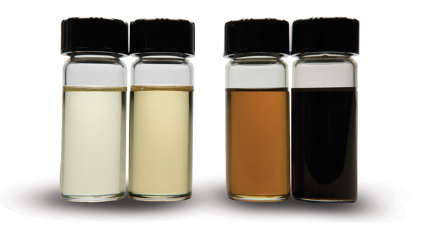

I didn't find it necessary to use the shop vac, I placed a small bucket under the tractor, spun off the old filter and quickly put the new filter back on with a loss of about 1 quart of oil. I put that quart of oil into a glass jar to inspect it. And I noticed the color of the hydro fluid is very dark for only 50ish hours of work... assuming the color of it was light gold when it went in. Dark hydraulic oil may not be completely bad but its signs of HEAT... oxidation and contamination.
Unlike a gear tractor, these HST are really putting the hydro fluid to work and it might not be a bad idea to change the fluid more often then the recommended 250-300 hours.

Oil color tells you next to nothing. Oil analysis is the only reliable way to know for sure.
Always a good idea to check what ever oil cooling system is present (oil to air radiator or fan on the hydro unit itself). Keep these areas clean of debris.

I disagree, Oil color tells you it’s dirty, it tells you if you have water. That is all I need to know, it isn’t a jet engine. I don’t need to know a bearing is wearing....

The small amount of hydro oil lost out of mine at the 50 hour was nearly clear, slightly yellowish.
   / xj2025 first oil and tranny oil chg?? help #34
It looked like what was coming out of mine was clear also until I pulled the bucket out from under the tractor and seen it in the bottom of a perfectly clean white bucket.
In this image from machinery lubrication I would say my hydro fluid was either right at the third bottle or slightly less. The issue with trying to judge from those bottle is no way to tell how much those hold or what kind of light is behind them. Certainly wasn't black....
but here is the link Why Hydraulic Oil Changes Color
