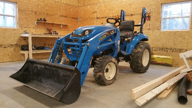

Howdy skysensor, I just bought an LS J2023H yesterday. It was the last tier3 model they had available in my area. Paid $ 16,700 tax out the door with a FEL, box-blade, & 4' tiller. They had a new XJ2025 in stock. It's about $1,000 more. It has 1hp less than the J model, is a tier4 engine (still Mitsubishi) & has a blue dash panel. It will be awhile before I can give an accurate review on it but after I've used it a bit I'll do a review.

Just picked up the same tractor you have. I was wondering how many hours you have on it, what kind of implements you are using, & if you have encountered any problems.

I own a 2023. I have had it almost a year & has been excellent. It has 60hrs on it. Just 1 tip -definitely want to load the rear tires- due to lifting capacity. This is a great tractor for the price-$12,300.00. The only difference that I have read is the 2025 has a newer seat which changed the dash area a little & the 2025 may have a tier 4 engine.

I will definitely be putting water in the rear tires. In a shed somewhere?? is my old garden hose adapter. Yeah, a couple small changes & tier4 engine on the 2025 & they jacked the price. So far it seems like it will be able to do what I need. Dug out a little 4" oak stump today & moved some dirt. This little machine is gonna get worked hard so we will see how it goes. I need to buy or build bucket tooth bar as I've got a lot of trees & scrub to take out. I'll post a review once I put it through some hard work.

I have enjoyed my tractor and I've been happy with it. Rimguard in the rear tires is a MUST. You'll need the extra weight for traction unless running in 4wd nonstop.
I have 60 hours on my tractor as well. Mine had a few problems, but the dealer took care of everything through warranty. It's 100% now.

Thanks for the input. Years ago when I had a grading business (skid steers, tractors, excavator) I ran straight water in my tractor rears. Being on construction sites I would eventually find a nail or screw. I carried wooden dowel stock that I shaped into plugs. Ream the puncture hole out, seat my wooden dowel, cut off the excess flush with the surface & I was back in business. The wood swelled up nicely & I never had one come out. Initially I tried regular tire plugs but they always leaked. I ran commercial tire sealant in my skid steer tires & never had flats.
I'm thinking of a 3 point platform with a water barrel for ballast & maybe welding some metal rods on my box blade to stack weight for when I want the box on & I'm doing heavy digging. I have a lot of trees to take out. I've got some design ideas for something similar to a bolt on tooth bar but stronger & more aggressive. We will see how it goes.
