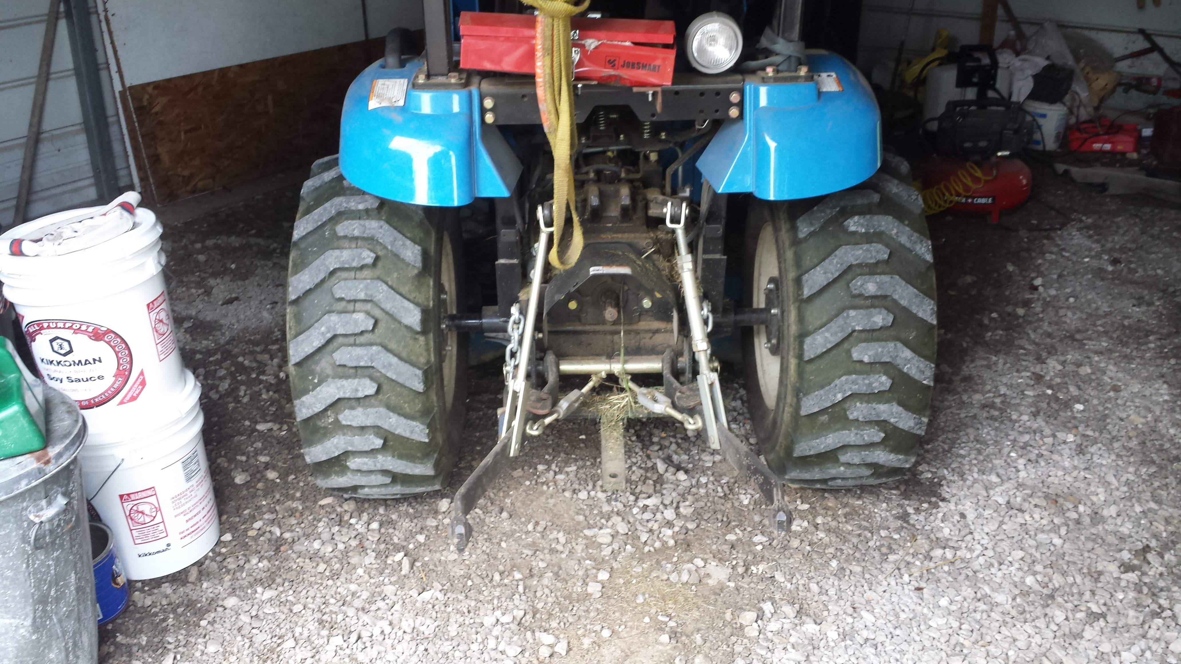

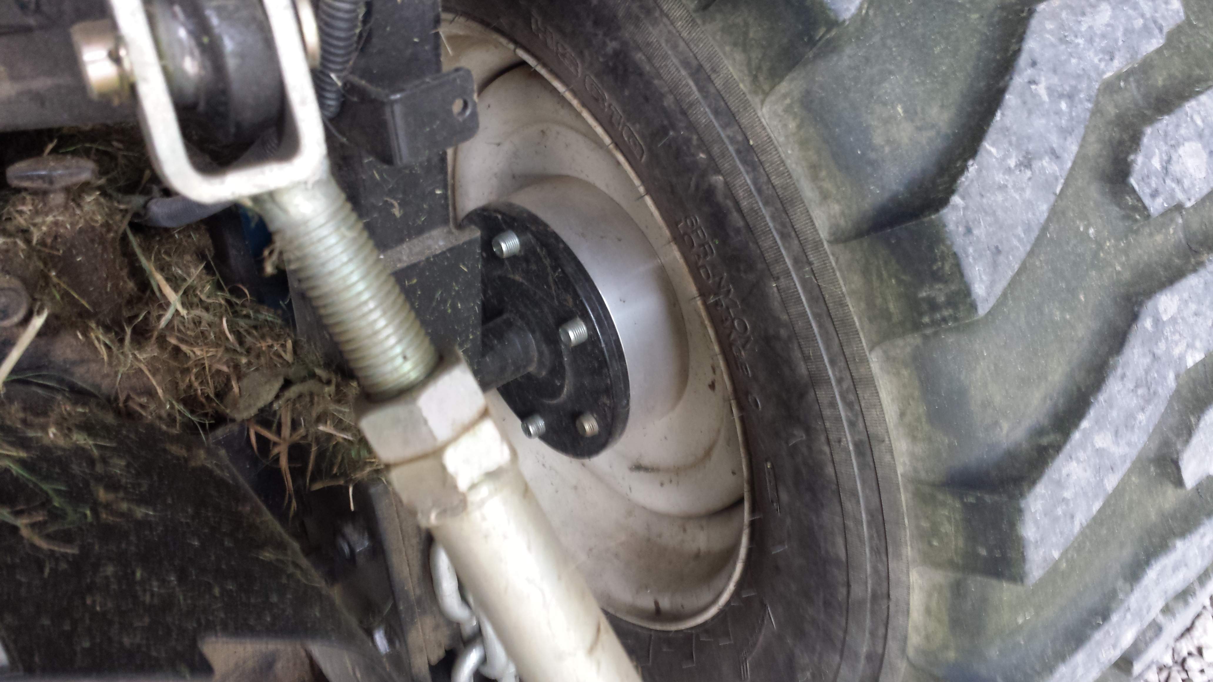

I have a J2023 and live in western Pa. I like the tractor, but have added rim guard and 2" wheel spacers. It is much more stabile now. The MMM is a 5ft, have been having trouble with the belt, as there is no tensioner except for a spring. This last belt I went with a 2" shorter belt and is a totally different mower now. We have around 200 hours on it and is just a year old.
Where did you buy your wheel spacers? That's a good idea.

I didn't see any Wheel spacers for LS on the website. Did you use the New Holland ones? Just finished up the paper work at the bank today. I hope to have my new tractor by this weekend.
   / XJ2025 Owners? #37
I called them and told them what I had.
   / XJ2025 Owners? #39
Can you post some photos? I'd like to see the difference.
