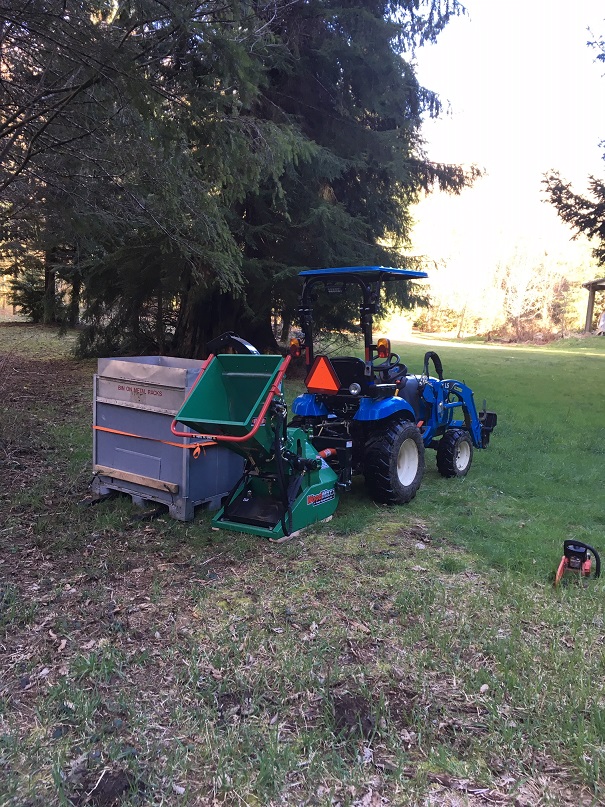

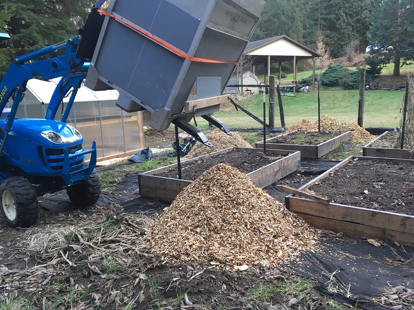

I bought the Woodmaxx TM-86H, the clincher for me was the hydraulic feed and safety stop bar. I end up working alone a lot and the safety feature is great. The other thing the variable feed does is allows me to slow it down preventing the tractor from bogging on larger limbs and it makes some really nice smaller chips for the garden. I have a bin I strap to my forks then drop it with the forks still strapped to it and chip directly into it. Then reconnect it to the FEL and go dump them where needed IMG_8952.jpg

Welcome to the pto chipper club! Nice setup, especially if you are chipping large amounts of brush and the chips need to go elsewhere.
One if the surprising thing about chippers in general is the low volume of chips after chipping major amounts of brush, so, it's going to take a while to fill that bin to capacity ;-)
Tip based on my experience, check the torque on _every_ bolt on the unit, not just what you had to assemble and grease every zerk you can find.
A curiosity question. When I got mine several years ago, the mate between the hopper and the feed assembly was off by about 3/8" inch and the ledge would stop small straight stems from smoothly feeding and coaxing over the lip. I solved the problem by grinding the edge to a 45 degree bevel and reported it to Woodmaxx, but wonder if they ever addressed the misalignment.
As someone else noted, the only ongoing problem that I have encountered is when chipping small, wet soft material (notably Confederate Jasmin and Bamboo) that the chute would clog, so, another mod that I made was to weld a short length of 1/4" rod to the bolt that secures the flywheel cover so that when it does happen, it only takes a single wrench to open the cover, clear the jam and re-secure the cover.

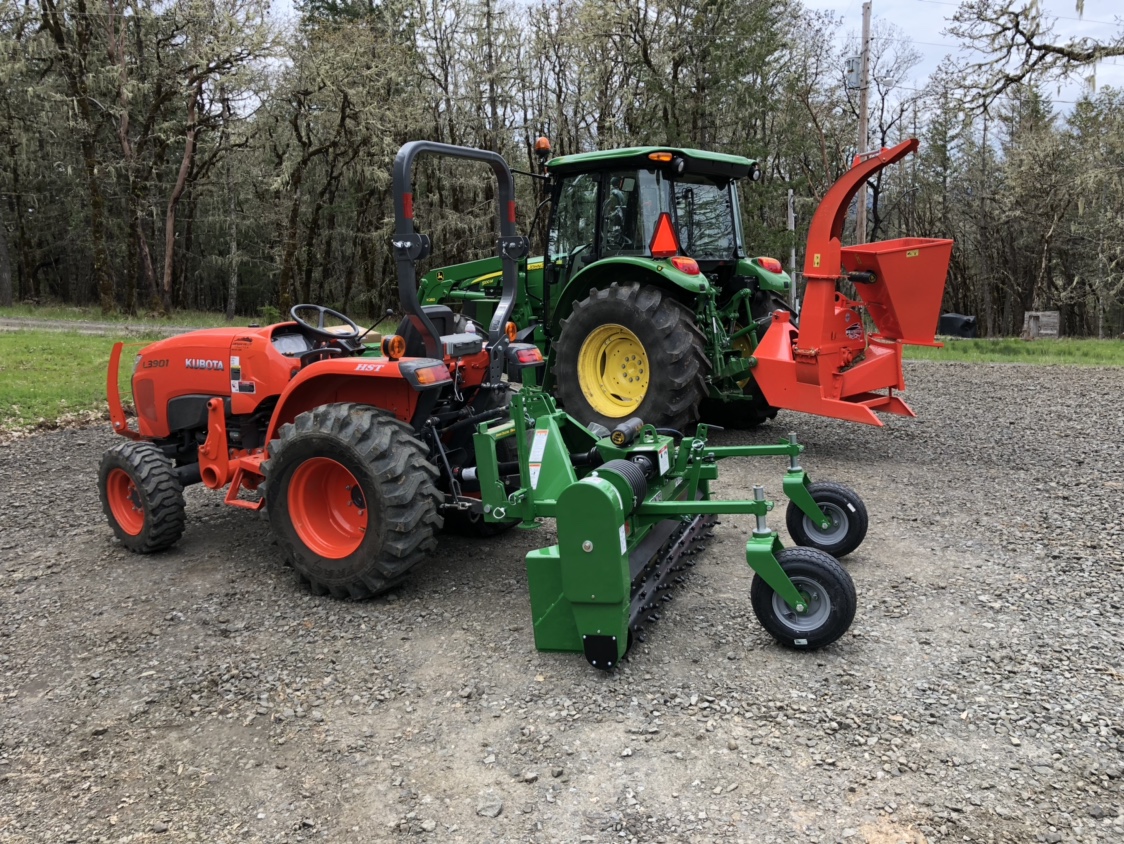

I completely agree with Oosik. I chip a lot of material every year, and have run my Wallenstein BX-62 behind my 30HP and 85HP (PTO) tractors. Green Douglas fir is pretty easy to chip but I can stall the small tractor pretty easily on anything bigger than 4” dia.
Put the same chipper behind the green tractor and it eats anything that will fit in the hopper.
I make sure I have extra sheer bolts though, cause I’ll break a couple in a days work.
I suspect hydraulic feed units can handle slightly bigger limbs per HP than self feed units because of the speed at which they chip.
