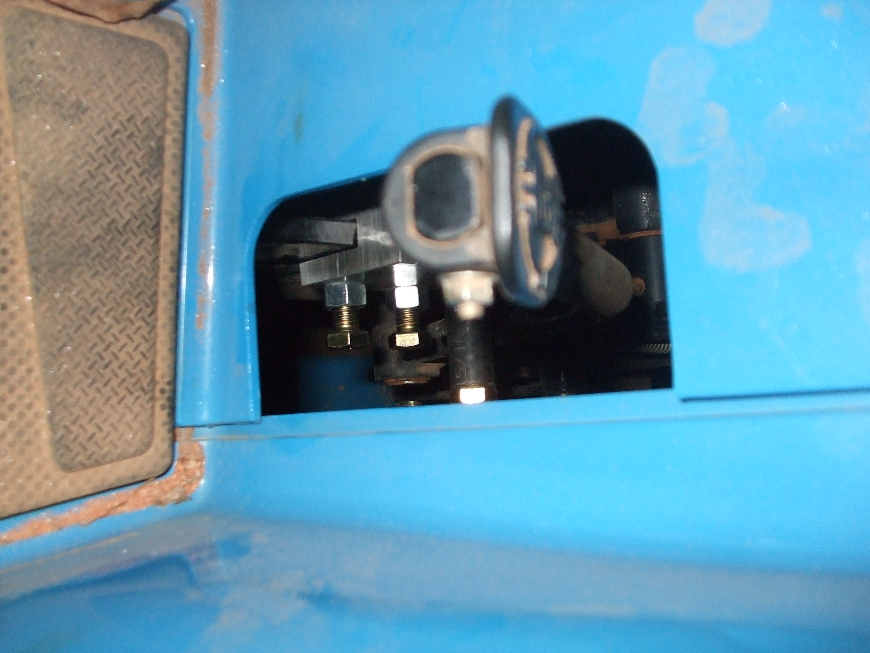

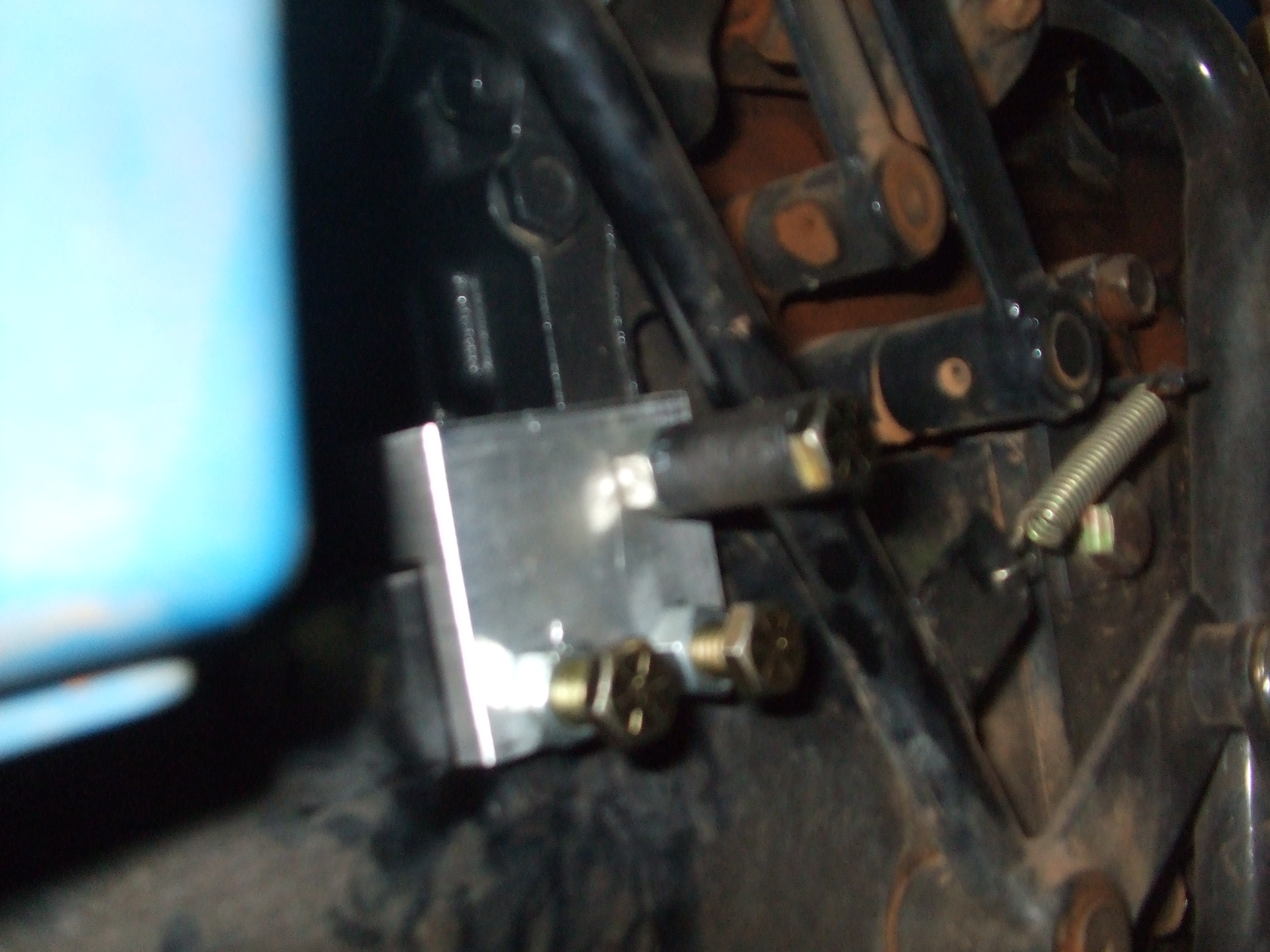

#16
I machined a stop for the differential lock pedal this morning and installed it. I'm just going to keep a 9/16" wrench in the tool box in the event I ever need to remove it and use the differential.
Thank's Motown for the great idea.
   / XJ2025H won't run in two wheel drive. #17
Looking good! Glad I could help. If you don't use it anyway, making sure it doesn't accidentally get used seems like a good idea.
Now, hopefully this doesn't happen, but... If the axle ever breaks again, and they don't want to warranty it, maybe they'll say "the diff lock must have gotten stuck on, which is operator error". Then you show them these pretty pictures. :)
