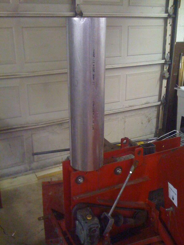

As far as modifying the chute the first thing was to come up with some tubing to extend it ... McMaster had some that would have been suitable ... but it looked like the minimum quantity was a 5' length ... which was 3' too many.
So I called a local heavy-duty truck place - Cross Truck Equipment - and asked if they stocked any 6" exhaust tubing. Sure enough, they had it in stock ... and 2' of it was about half the cost of the 5' length at McMaster. Dunno exactly what gauge it is but it's at least as thick as the metal on the original discharge chute and likely thicker ... maybe 1/16" or better:
This is "aluminized" steel tube ... it's weldable ... supposedly just sounds a little different when you weld it.
I did end up ordering a couple of 6" steel flanges from McMaster ... one to serve as as the base (welded onto the chipper) and the other to be welded onto to the pipe in the picture above. These will be coupled together with a clamp I'll fabricate.
The flanges at McMaster are called "angle rings" and are intended to be used for joining (lightweight) steel pipe/tubing together. Can get them with or without bolt holes ... I got the ones without. They are 1/8" thick. McMaster item no. 1764K51 ... around $5 a pop.

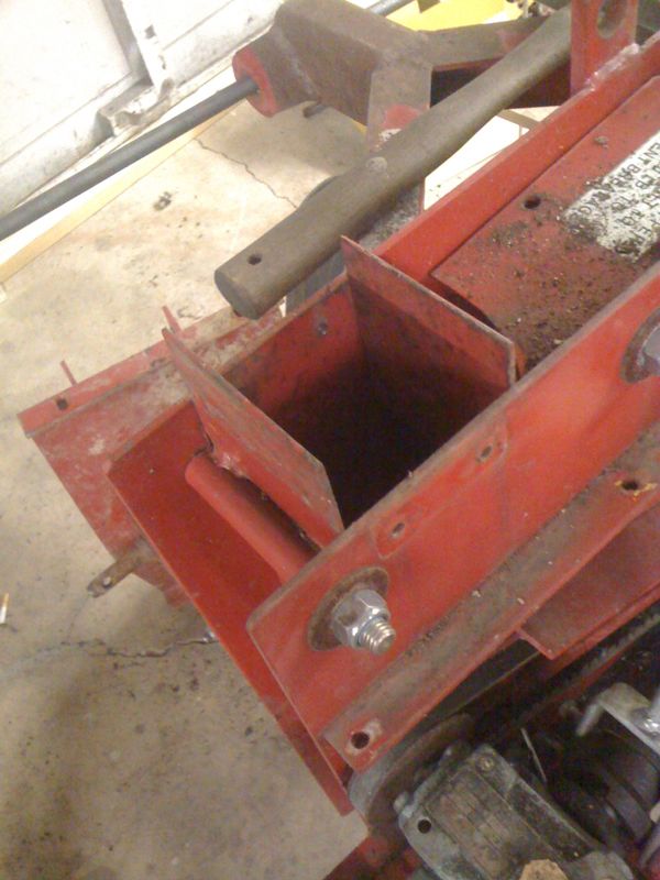

These two pieces of sheetmetal at the outlet were tapered inward to fit inside the discharge chute ... introducing a slight restriction into the discharge path. With the 6" tube that's no longer necessary ... so I bent them back out even with a hammer:

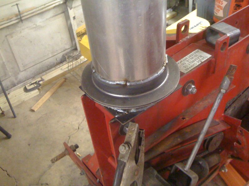

The flanges for the chute swivel came in from McMaster yesterday.
They look like they should work fine ... although they will require a little modification I hadn't counted on: the flanges appear to made from angle which has been formed into a circle, are welded on one side, and have some bead sticking up (on the outside)
I'll probably weld them from the other side as well, and then grind all the beads flush.

Running a little behind ... got distracted into doing some clean up in the shop ... lol ...
All this needs a little tweaking and some clean up (cut off/grind sharp points etc.).
I welded on some 1/8" flat/bar stock to close/cover the backside (bottom) of the bottom flange and then welded on the bottom flange:
