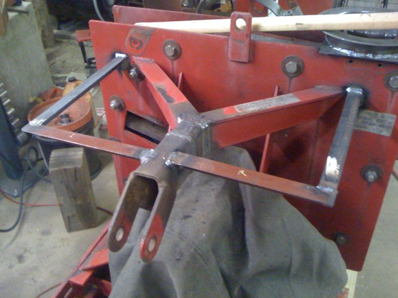

Got another 2" of 3 x 2 tube welded in on the top link mount so it should be fully quick-hitch compatible. Then added some angle for a mounting frame for a storage basket:

Basket was scavenged from an old upright freezer that gave up the ghost:

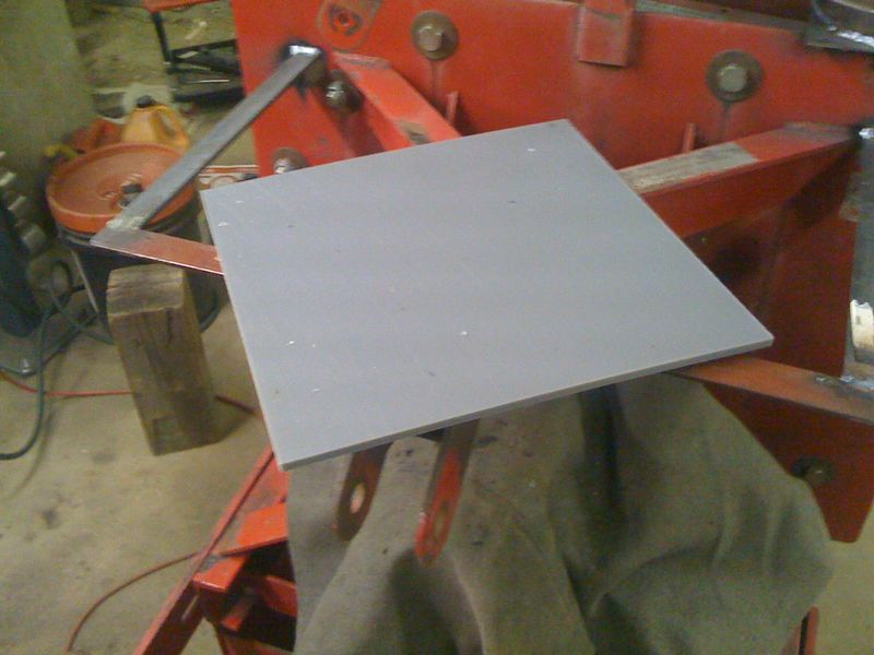

12' x 12" x 1/4" sheet of oil-filled UHMW polyethylene from McMaster for the chute rotation bearing ... it's got so much oil in it that when you touch it leaves a sheen on your fingers ... lol:

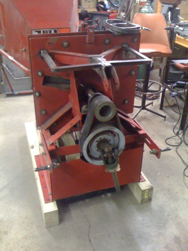

Drilled 2 holes in the basket mount angle for the basket clamps, also drilled a 3rd hole in the 3 x 2 tube. Since the 3 x 2 will capped, I went ahead and tapped that hole with a 1/4 coarse thread tap.
Took the side panels for the base and drilled 5 holes in each and then swapped the panels, mounting each on the opposite side so that the angle and the holes were outboard where they were accessible. Used the holes to run some 1/4" tapcons into the 4 x 6 x 48 skids to secure the skids to the chipper. The skids should eliminate the tendency for the chipper to tip over towards the back.
Also cleaned up the square rod on the PTO with a needle scaler and a wire wheel in a die grinder:
