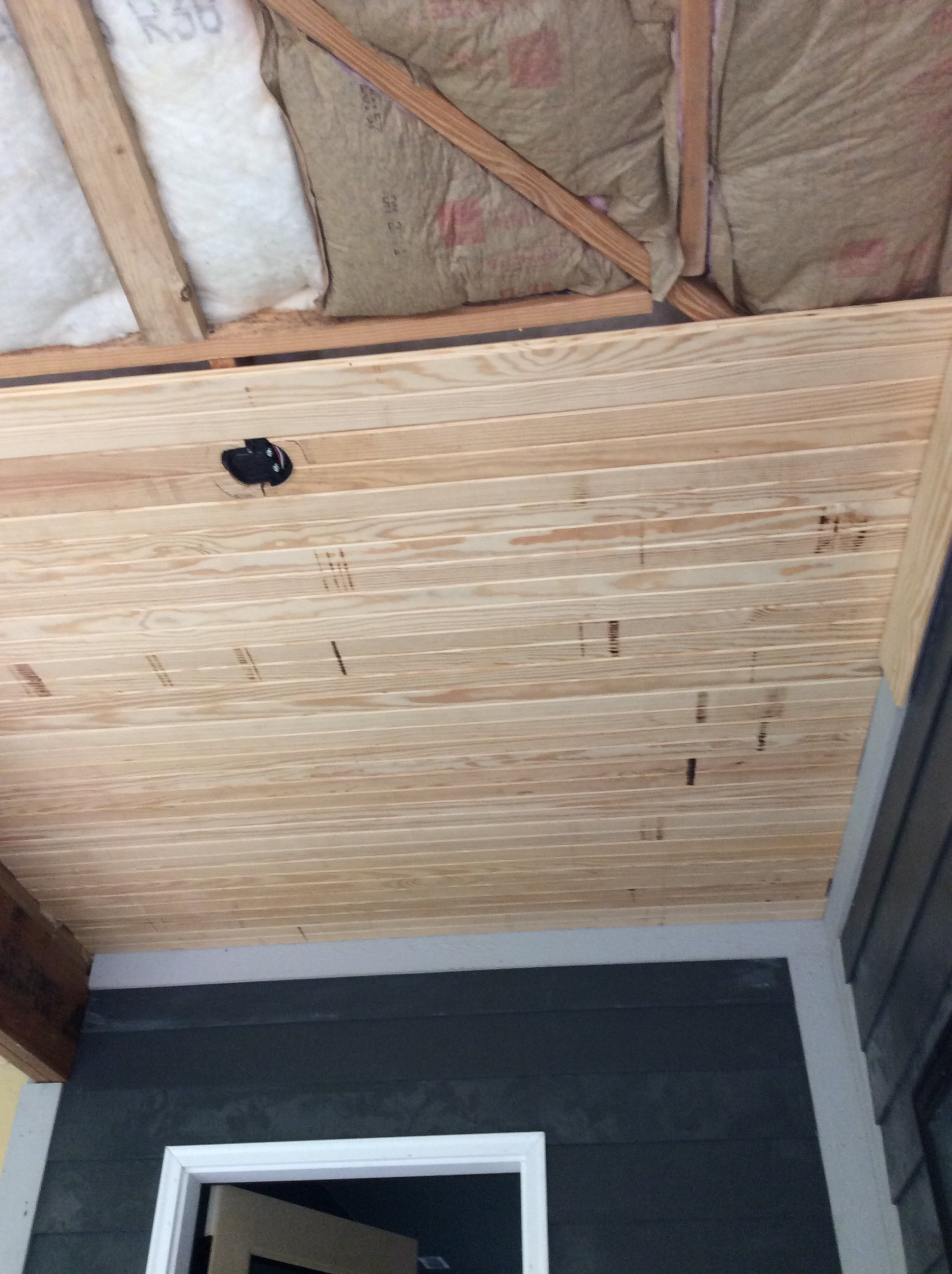

thx for the tip
the mill selling the stuff said the same thing about buying an extra 10%, i bought about 15% extra because it was cheap. i might cut the tung off and use it for window returns.View attachment 703845
so far, everything's going ok. the porches are 10 ft up and i'm not good on a ladder but, so far so good.
a few split ends and the black sanding marks but so far the boards are better than the stuff from lowe's.
i got just past 1/2 done on the first porch and it started raining which, coupled with the humidity, drove me inside to finish the interior trim.
i've got 3 ladders up and ledger boards all over the place. it's a 2 man job but neither one of my dogs will help !
shiplap might have been easier.
Did you finish the T&G before putting it up on the ceiling? Varnishing upside down is no fun. Painting might be a different situation. Jon

That looks pretty nice!
In my mind, it's typical to buy 10% over.
I usually give my lumber customers 10% over for warps, twists, and bends. Even mis cuts.
I pre-finished a lineal mile of T&G 6" pine for my Canada cottage ceilings (huge vault).
I sprayed outside, across 16 long sawhorses that I built.
One coat shellac sealer, one side, then flip over and spray again, after quick dry.
Then inside for longer dry.
Then out for light sanding, wipe down, and urethane spray (one side).
Back inside to dry.
Back outside to sand, wipe down, and 2nd coat of urethane (one side).
Then back inside for final dry.
The task took forever, but the result was perfect, and the back was thus sealed also, with the one coat of shellac.
1/3 the total batch, each time a procedure was done.
