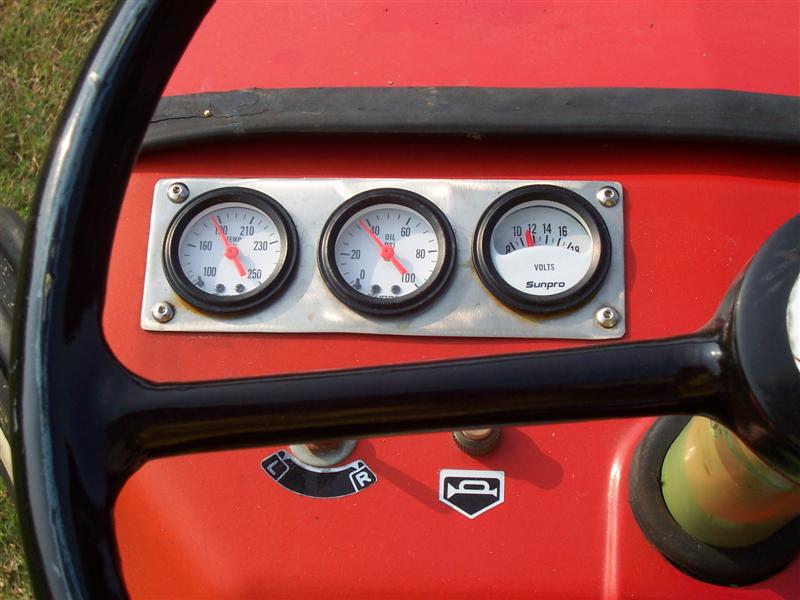

   / yanmar 1500 getting hot #55
here is how I did mine....1500D, and I run Water Wetter in mine as well
   / yanmar 1500 getting hot #56
Well I got the sensor today. It's set to come on at 110* C. That converts to 230* F. Looks like we found the problem!
