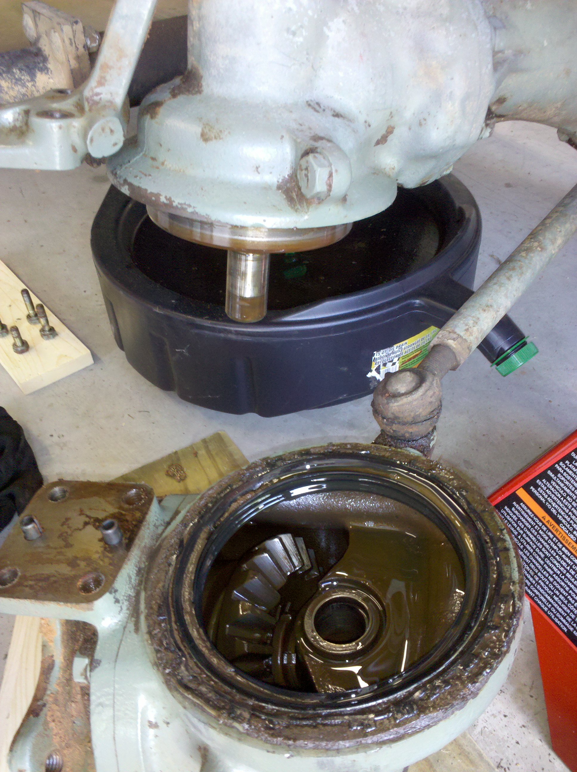

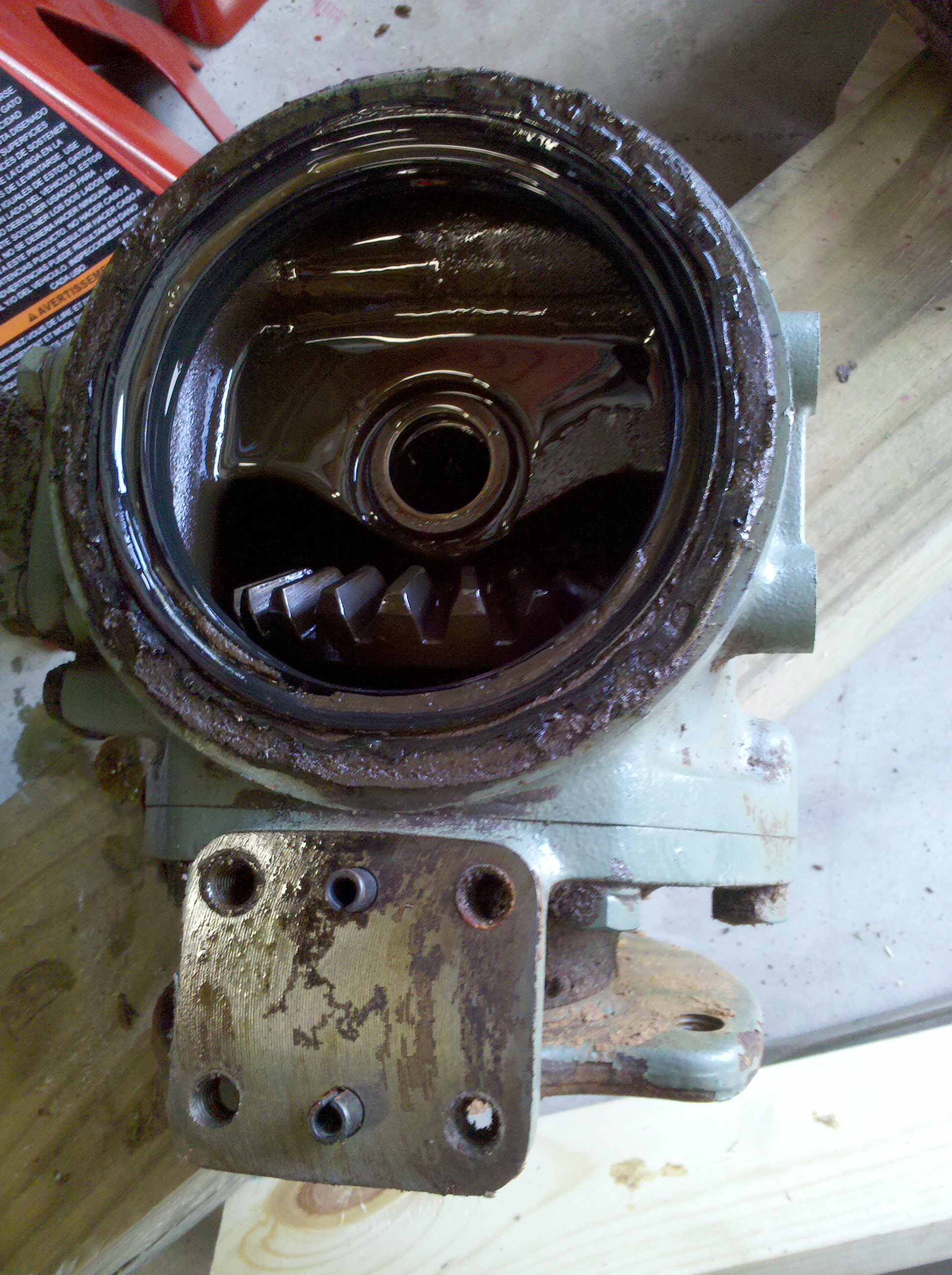

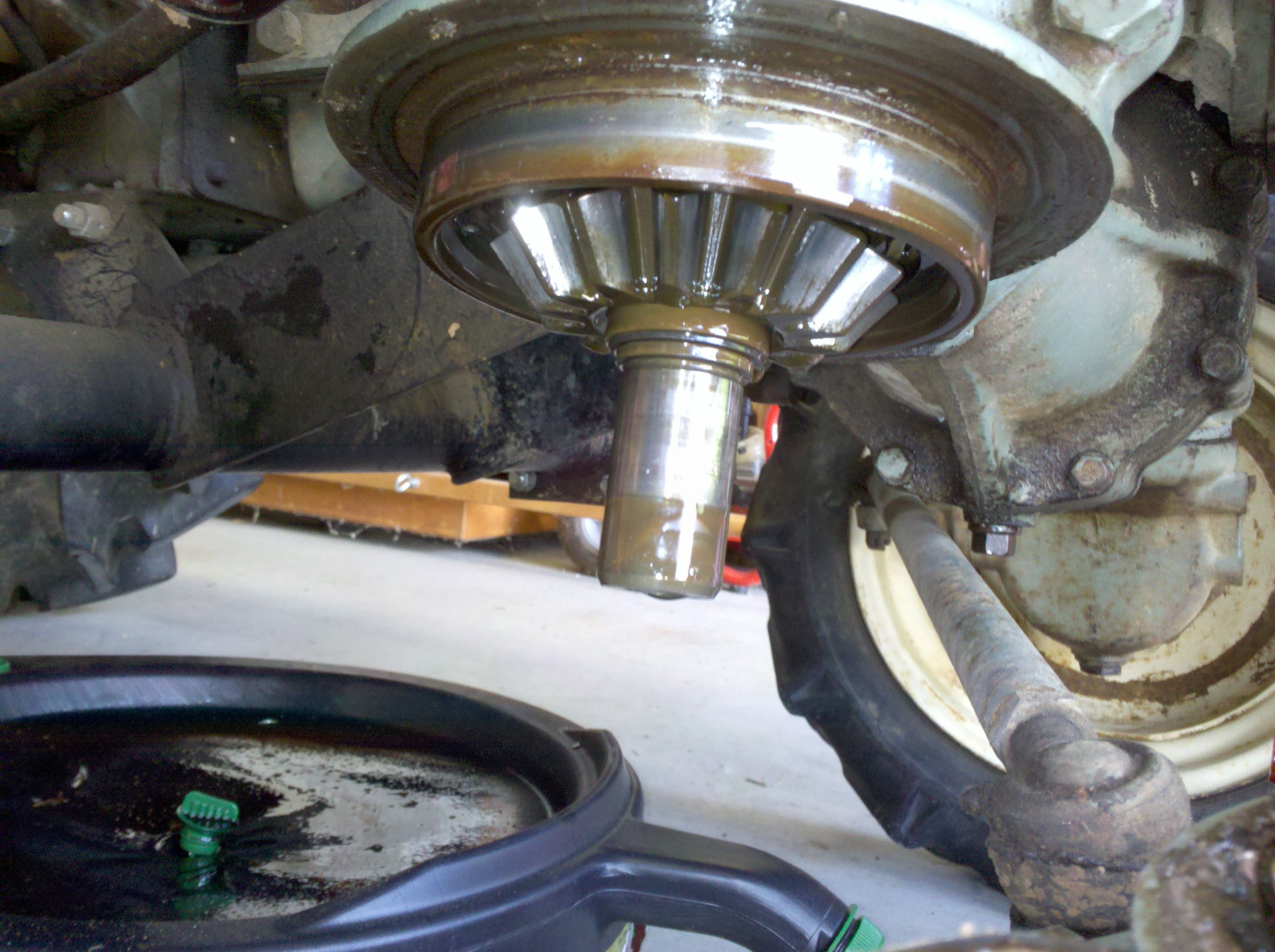

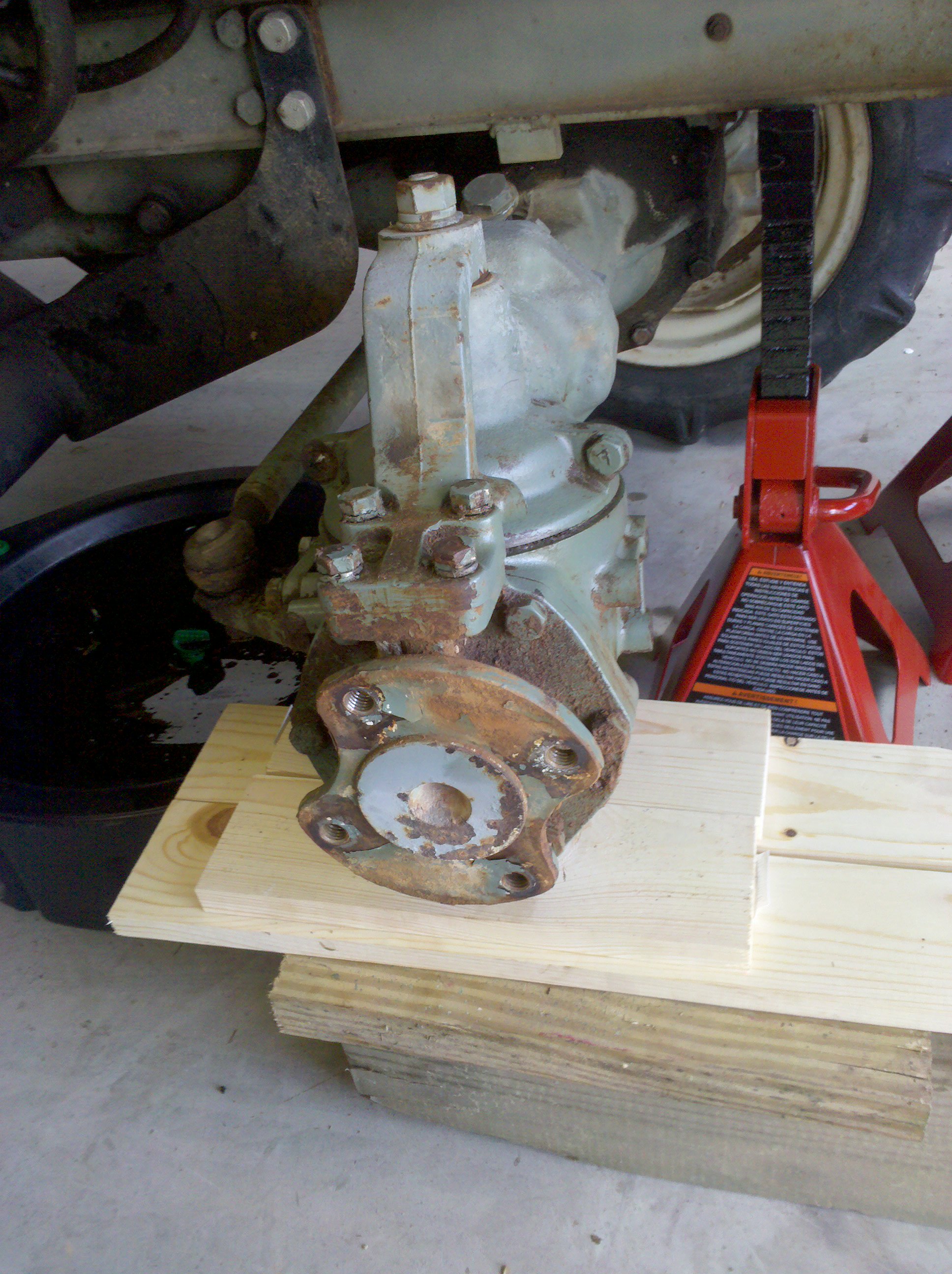

Hello Justin,
I replaced the front knuckle seals today. It was a relatively easy job and I didn't run into any major problems. I have attached some pictures for you to view. After jacking up the tractor I used a couple of jackstands to secure the tractor. I drained the oil out of the center drain first. I removed the wheel before draining the oil from the knuckle. That keeps the oil from running out onto the wheel. Be careful not to lose the o-rings on each if the drain plugs. After you drain the oil, remove the four bolts holding the lower knuckle. As you can see in the first picture, I used a short 6x6, 2x6 and some 1x3's placed under the knuckle to keep it from falling when I removed the four bolts that attach the upper and lower housings. I used a rubber mallet to help get the knuckle to drop off. I also used a screw driver to assist with the removal, being careful not the break anything. The knuckle dropped onto the wooden support fairly easily. It took a few pretty good hits with the mallet to get it to drop. Once the knuckle is off be sure you locate the washer that fits over the spline. It will probably be lying in the lower knuckle. You can see the washer in the second picture. I used a couple of screw drivers to pry the seal out of the knuckle. I forget to take a picture with the seal removed. You can see the old seal in the second and third picture. The seal has a metal ring encased in the rubber. On my tractor, the metal ring was exposed around the outer edges of the seal. It was probably due to years of wear. I got the screw driver started under the metal part of the seal and after a little effort was able to pry the entire seal out. After cleaning around the lip of the knuckle were the seal seats I put a thin layer of oil on the seal and used the mallet to GENTLY seat the new seal in place. I put some oil on the spline and on the inside of the seal to make it slide onto the upper assembly a little easier. I then reattached the lower knuckle to the upper and bolted it back in place. I did find it helpful to use the 1x3's as leverage to help raise the knuckle. I mounted the wheel and then repeated this process on the other side. I hope this helps you. There may be a better way to do this but this worked for me. Let me know if you have any questions. I'll be glad to help if I can.
