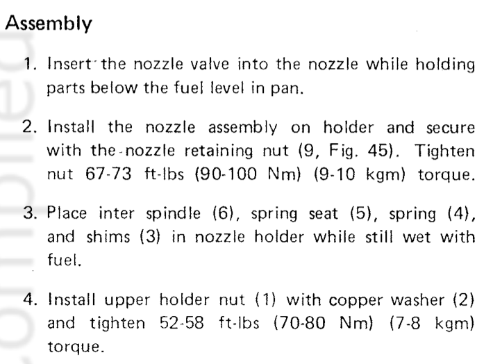

Here's the torques:
As I understand you have to be very careful on the injector parts , but what is exactly the case?
It needs to be very clean and is very fragile?
