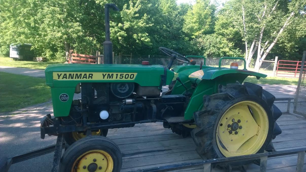

The tractor is repainted and I have no idea which parts are original or maybe put together form other tractors.
On the inside of the dashboard there's still the lime green color.
Here are some pic's:
Just enough rebuild for a test drive earlier:
This one is last summer:
I do have the parts manual which is available on internet.
In the meantime also got a service manual, but it is incomplete.
Doesn't cover the electrical parts and some other sections.

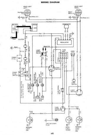

Today I removed all the unnecessary wires, removed al the tape and other stuff.
Everything works except....
My ignition switch is different.
The fusebox is only powered in the ON position.
Based on the schematics I guess the fusebox should be powered in the ON, TS and Crank position.
Anybody here who knows?
Also put the alternator back and tested the AC voltage on it (running engine), sadly it is 0.0
Tested the resistance, almost 0, also beep.
So maybe shortage inside the coil?
Or does anyone have an other explanation?

We do have a recent addition from the Yanmar Tractor Owners Group on GIO. I'll add it here too. Just maybe, with these manuals, you could draw some conclusion how things should have been on the machine.
YANMAR YM135 YM155 YM240 YM330 ELECTRICAL MANUAL.pdf
Next to hydraulics, the electrical schematics tends to be the most sought after item to troubleshoot.
Over at Jensales, this is shown. Would this actually be the right electrical schematic in image-4 for a YM186? Not sure.
Yanmar YM186 Tractor Parts Manual
Even in my image enhancer, one can now make out most of the English.
  • YANMAR YM135 YM155 YM240 YM330 ELECTRICAL MANUAL.pdf
Pretty sure that is the same diagram I attached in post #60, yours may be plainer.
