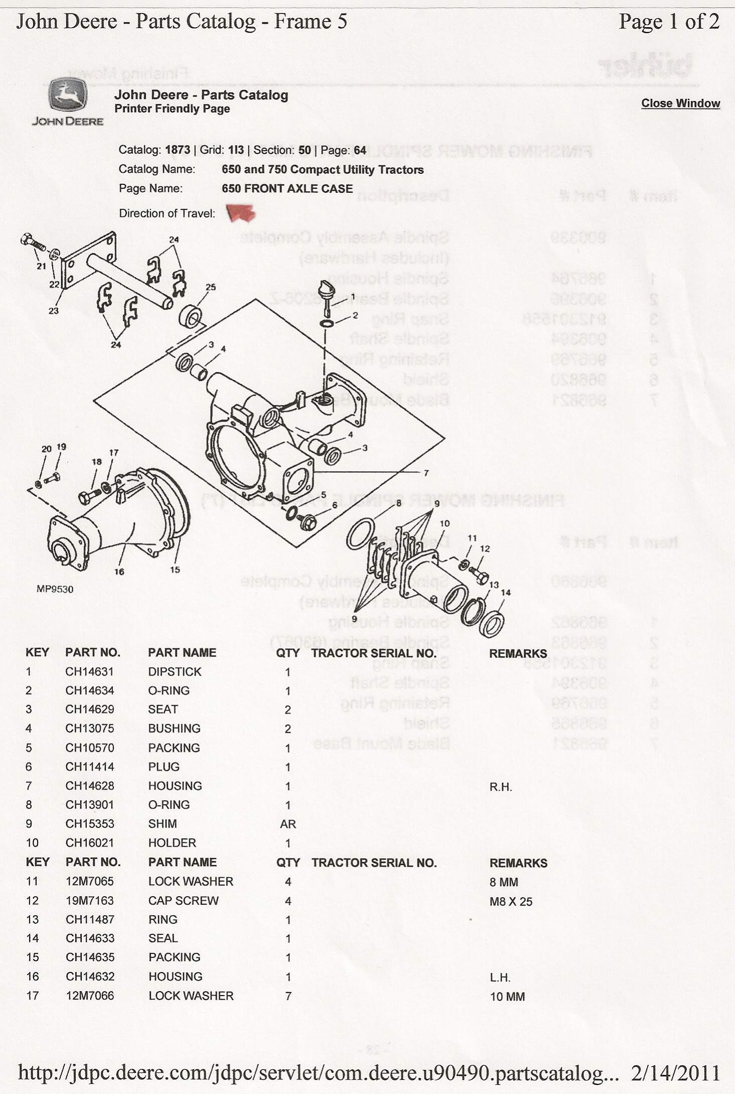

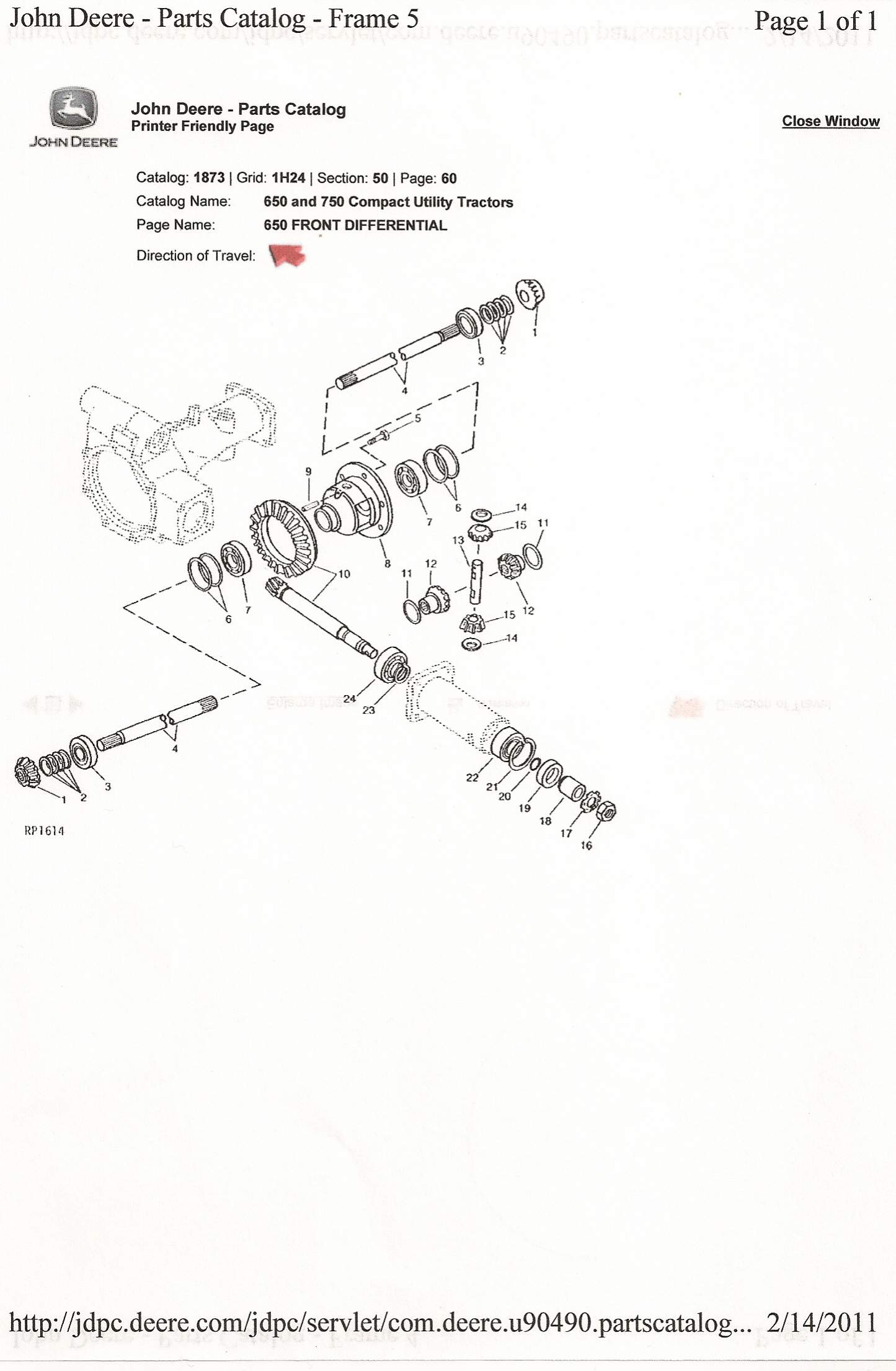

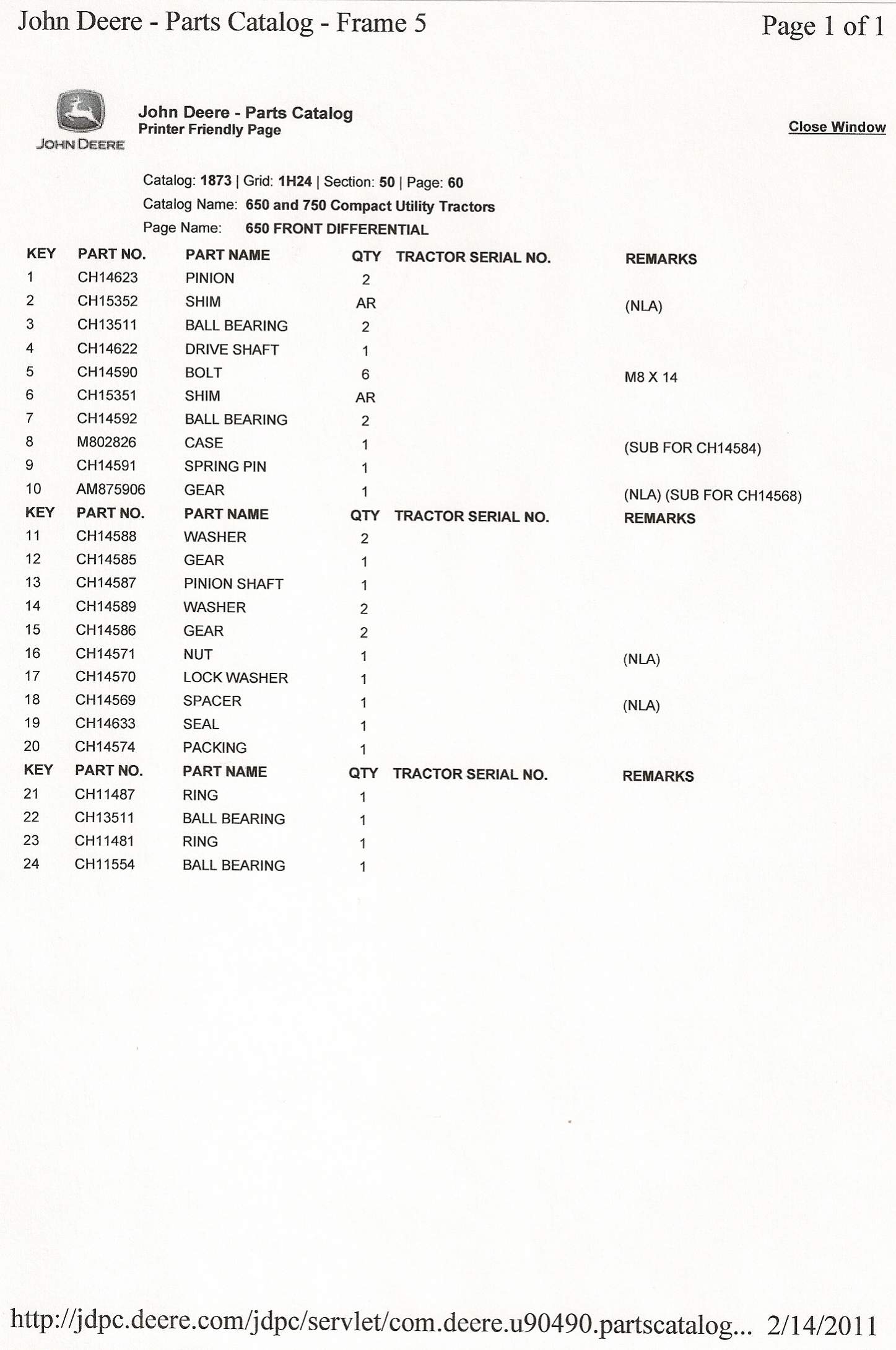

I agree! Going to try and attach a John Deere drawing. Probably won't work.

Winston1-that JDeere diagram is really helpful and now I get what the broken #23 ring does. Got the welding equipment and nickel rod ready to go so if the weather holds I'll try reattaching the busted ears this weekend. The guy at the welding supply shop thought the ears are cast steel not cast iron. Either way he said the nickel rod was the right thing. I'm going to pull the whole axle out from under the tractor to make it easier to work on. I'll post some process pix if all goes well. Meantime I have to find some roll pins to replace the one that came out in two pieces when the u-joint was disassembled.
Thanks for all the advise so far.

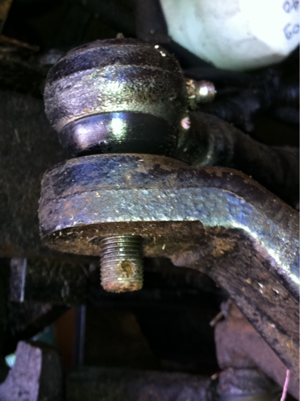

Weather is about 30 degrees so I set to working on the tractor. I want to pull the whole front end out by pulling the pivot pin BUT can't do it without disconnecting the steering linkage. This looked simple but when I removed the castle nut from the swivel joint it won't budge. Tried pounding on it with a hammer and wood block but no-go. Here's a picture. Any ideas how to get the ball joint bolt out of its hole? Is it threaded? If so where do get a wrench on it?
