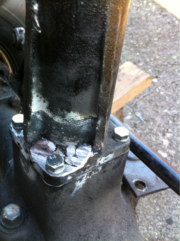

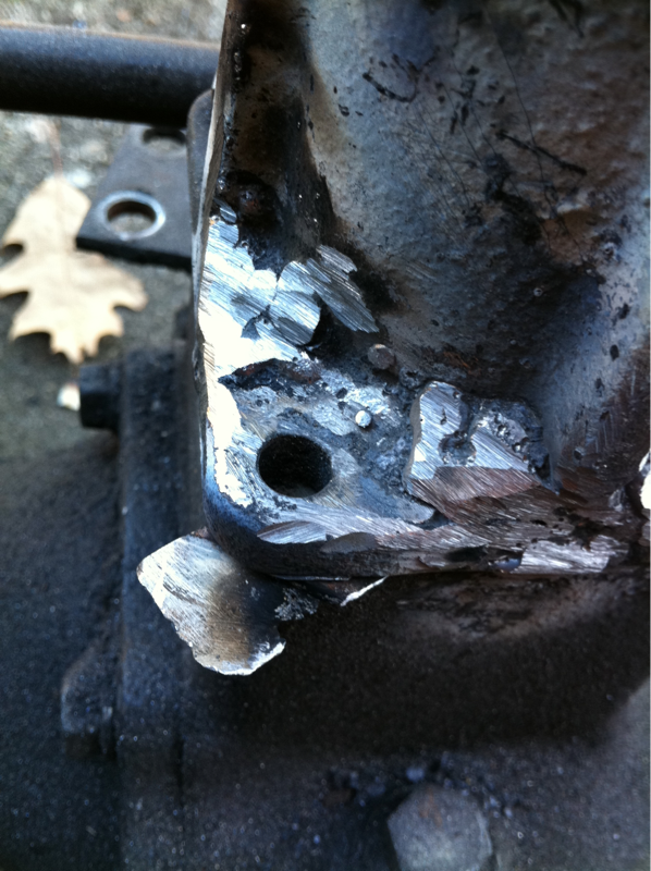

Got back to it today and welded the broken ears back on the pinion holder. The nickel welding rod wasn't easy to work with but several passes with grinding in between got a considerable amount of weld in the area. 1/8" and 3/32nd rod is what I had and ran it on an AC welder at around 80 amps. Working around the bolt heads made it a little tricky. I decided to use the axle housing itself as a jig to keep all the pieces in alignment. First I took out the oil seal so it wouldn't fry from the heat.
Everything is put back together now except one set of roll pins. So, tomorrow I'll finish 'er up and find out if this repair was worth the trouble. Keeping my fingers crossed...will post the result.

Sorry to say the repair was a bust. After reassembly the test drive revealed a nasty clatter from the front axle. I suspect the bevel gear and pinion are not meshing properly. Since I depend on 4wd not sure what to do next since parts are probably not available for this 25year old machine. May have to bite the bullet and get a replacement tractor.

Before you give up - I would put it up on stands, and listen to verify the origin. Maybe the racket is over in a hub. Maybe you (or an experienced automotive shop) could shim the ring/pinion into better alignment, or add material to rebuild that pinion gear.
I expect the parts are out there somewhere. Manuals for some models show different gearsets for different tire combinations, so make sure of the right ratio!
Did you already survey all the parts dealers and junkyards? How about Len? He can get near anything out of Japan if it's worth paying for the hours of research and calls he would need to locate the parts. In fact he has posted that he can have gears made from scratch.
And if you finally decide to move on, please offer it here. Somebody might have a 187 down, waiting for unrelated parts.
