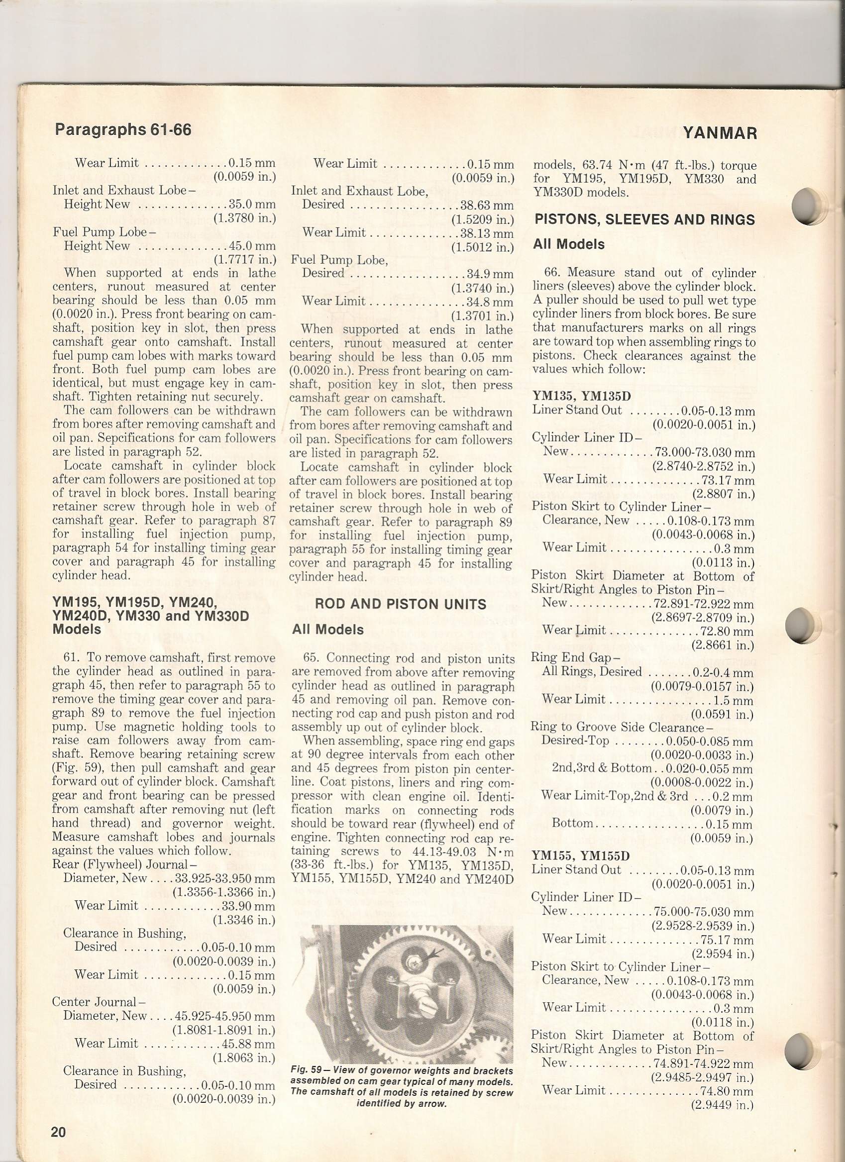

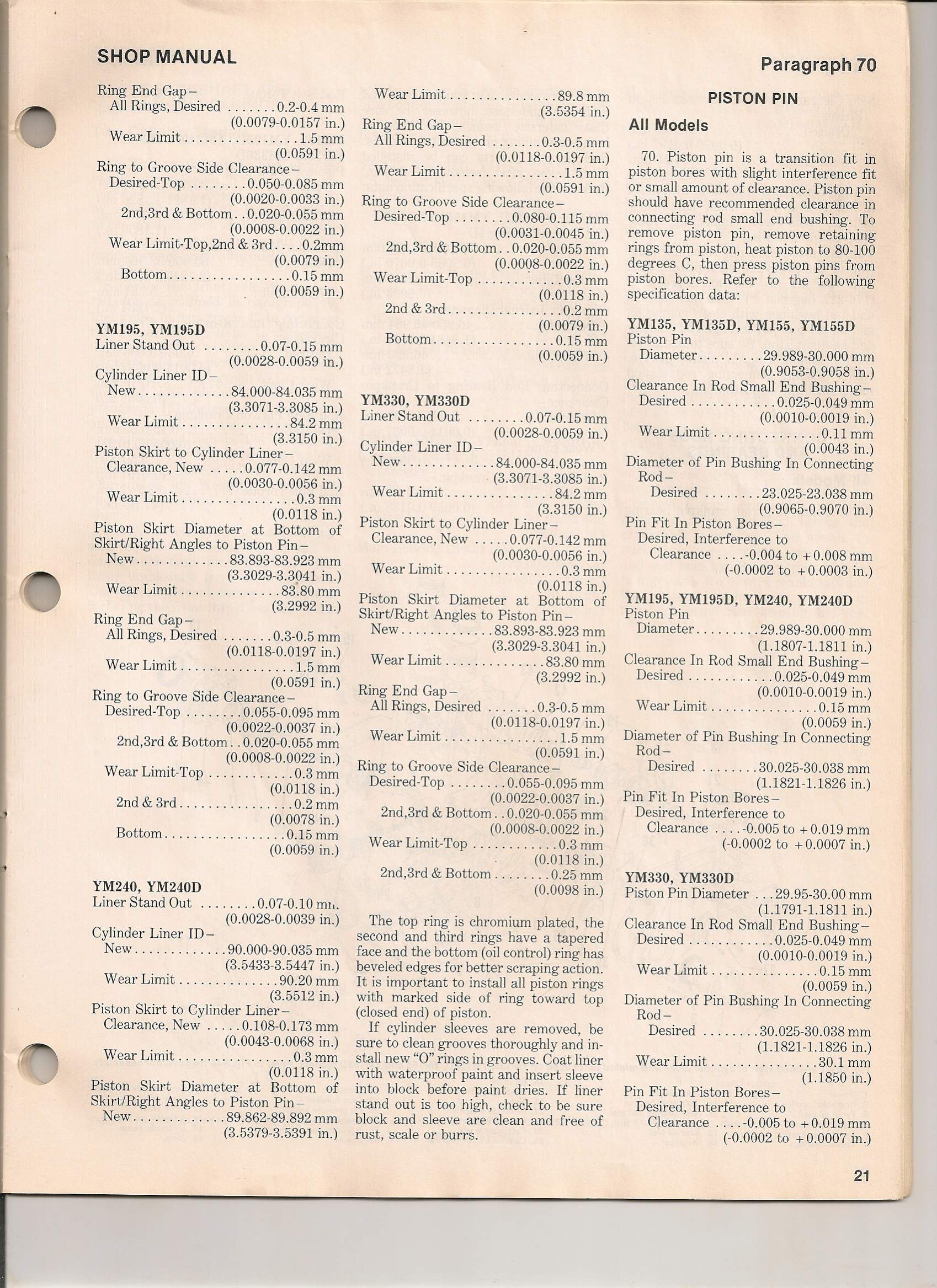

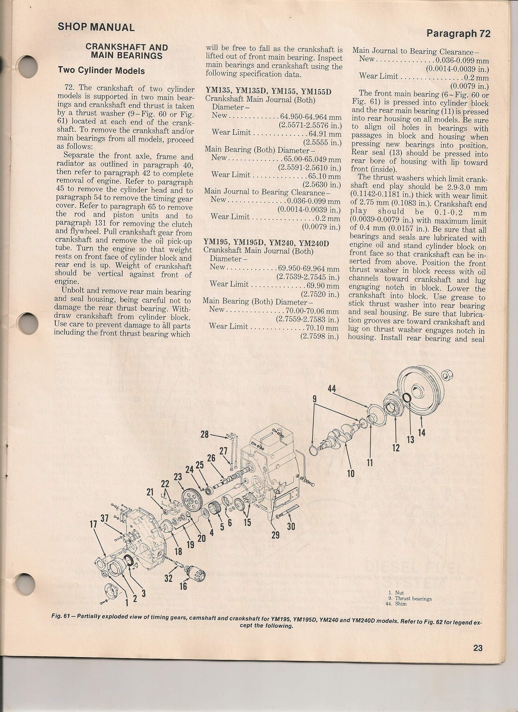

YanMar 2210 Factory Crack spec's??? Does anyone know what the factory Crack specs are for a 81 2 Cylinder 2210 Tractor. Also if its handy I would also like the spec's on the cam and rods.. Thank You in advance.:cool2:
   / YanMar 2210 Factory Crack spec's??? #2
According to Hoye's parts the 2000 and 2210 use the same crank and rods so here is what the I&T manual shows for the 2000.
Thank You! Going to go and see about get the crack turned, its a long shot but I have a contact at Bullet racing cams and they can turn it as long as its not cut to deep for 185.00 verses 450.00 for a new one.
Thanks Again!
   / YanMar 2210 Factory Crack spec's??? #4
According to available bearings they can turn the crack .030".
