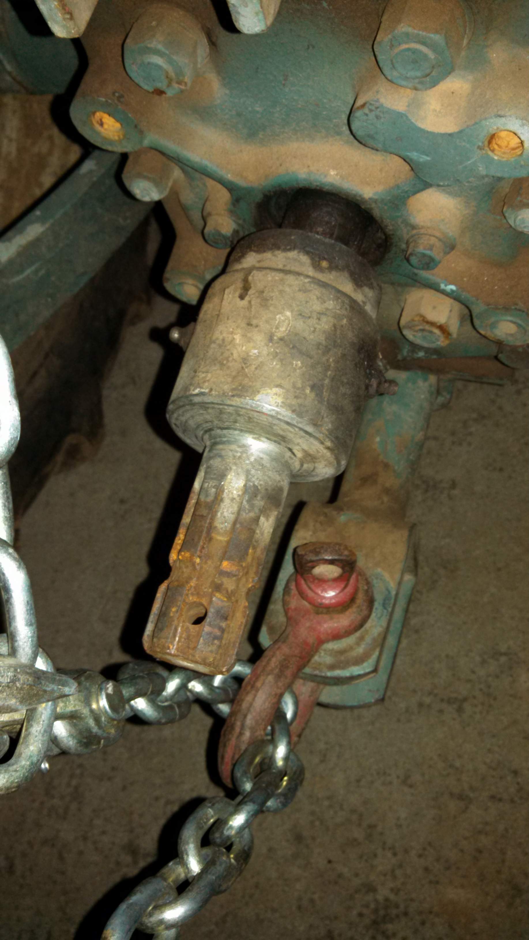

No. Wrong.Looks like the 'bridge' deal is for a mower to let it float relative to the tractor. My Woods rear finish mower came with this type of linkage. On a tiller, you need pitch stiffness to keep the tiller from flopping forward. This would only work on a reverse drive tiller (which makes the tiller top link pull rearward). My Yanmar tiller pulls forward, so this rig would just twist up the machine and fail the driveline.
Spin the torque tubes around to get more reach.
Ok here's how Yanmar intended their tillers to be set up. Note the special top link components. I call the tractor-side part a 'bridge'. I have it attached with pins here in this photo but there was too much slop so I then used the factory bolts that came with the 'bridge'.
I took this photo to show that the driveline provided by the importer was too short - so ignore that component. (After seeing this photo they gave me a free PTO shaft extender, no hassle).
And here's the old thread where I posted that photo. Another new tiller owner had the same questions as you. There are other similar threads here, and the correct solution in all of them is: Don't butcher the tiller, just get the correct Yanmar components (or weld up a replica of that top bridge). It is needed to tilt the tiller away from the tires as it rises.
Also wrong.On a tiller, you need pitch stiffness to keep the tiller from flopping forward. This would only work on a reverse drive tiller (which makes the tiller top link pull rearward). My Yanmar tiller pulls forward, so this rig would just twist up the machine and fail the driveline.
Your tiller attachment brackets have stops welded in place to prevent the tiller from rocking forward more than a few degrees.
