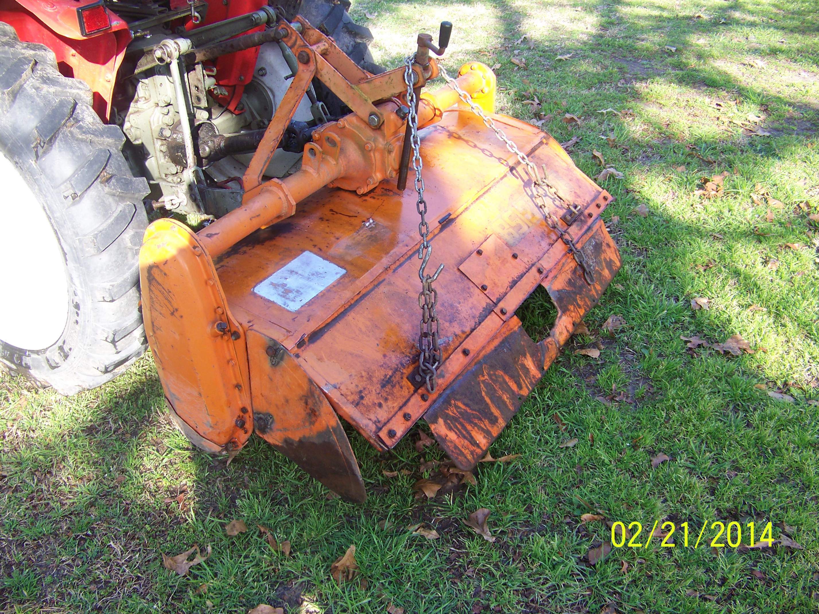

Your green tiller is an older RS1400. His red one is an RSB1400 or RSB1401. It's designed for use with a red Yanmar tractor's rear draft control socket. That's the reason for the different kind of mount. You can easily see what someone has done to solve the clearance problem on a tractor bigger than this tiller was designed for, yet maintaining draft control (the flex cable).
   / Yanmar 2210 lift arms too short for tiller #22
Here's the other end of the draft control squib. Anybody notice the top link config ?

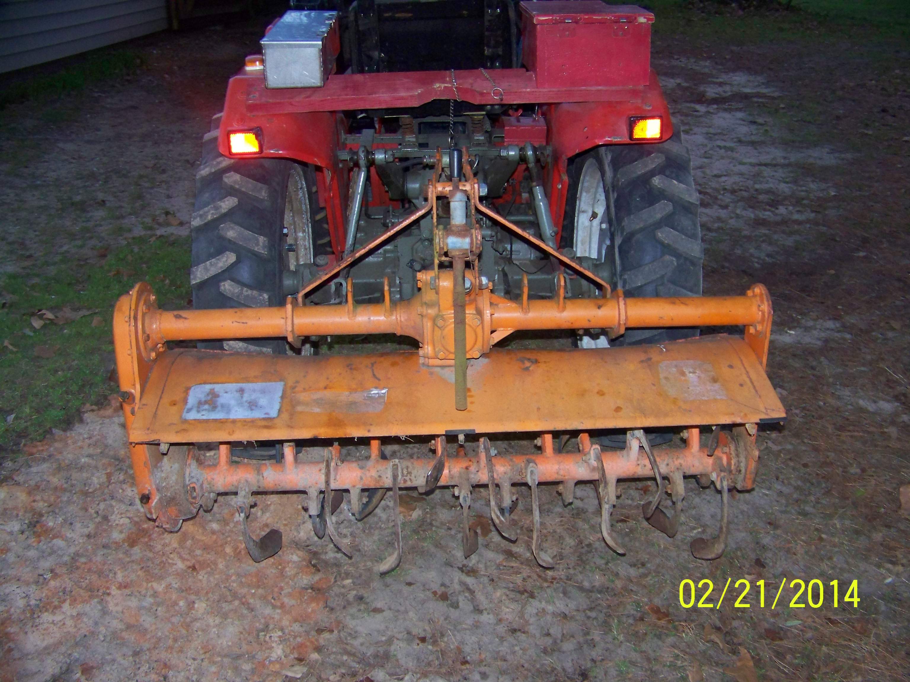

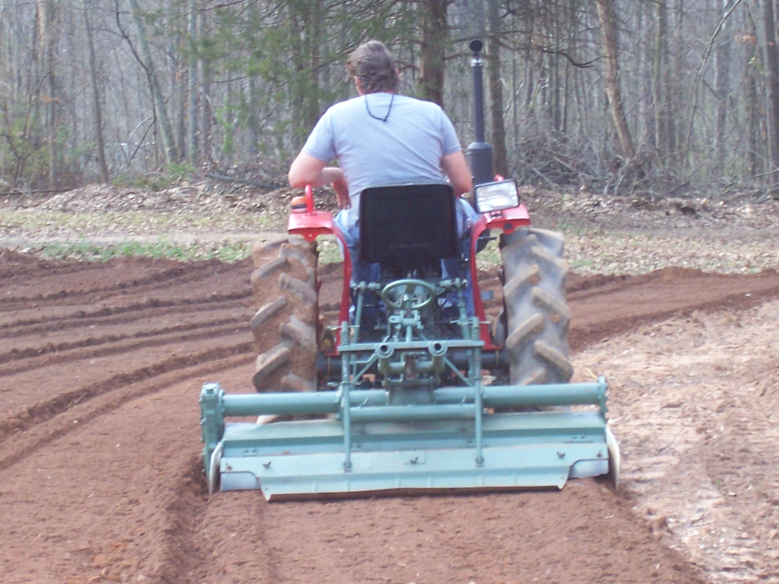

100_6738.jpg100_6732.jpgI went out and measured my fabricated top link from pin center to pin center. Although adjustable it is set at 15-1/4". My tiller never hits the wheels, my chain case runs in a vertical position.
About a week ago I had a 1200 chain driven unit repairing and selling for a widow lady. I hooked it up and ran it by getting the top link the correct length. I don't understand why this is so complicated. I agree the correct way is the factory set up but it can be worked around. couple of pictures of it attached to my 2002d.
2210 does have 9.5-24 tires and I have 8.3-24 tires. Maybe that is the difference. No idea if the lift arms are the same?
   / Yanmar 2210 lift arms too short for tiller #24
I have the RSB1401 and it came with the toplink pictured in California's post (#8). I have very little clearance between the tire and the tiller, but it works great. If it matters, I have (13.50 - 16.1) R1 tires on the rear. I do have the draft control bracket on the tiller, but whatever linkage was there is long gone, and I'm pretty sure there isn't anything on the YM226 to connect it to anyway.
I see how a cable may give feedback to the hydraulic system for draft control.
But what we are talking about here, is geometry to keep the tiller from hitting the tires as it is raised. The cable can't help with that.
In your photos (enlarged below) I see a non-original quick hitch moving everything back a couple of inches. And likely extender tabs welded to the tiller to move its lift pins farther from its chassis. Is that a longer non-original driveshaft? Modifications like this are what some have done to use a Yanmar tiller but I don't think it replicates what Yanmar intended.
I don't understand the point you are trying to illustrate with photos 2, 3 in post #21.

"I don't understand the point you are trying to illustrate with photos 2, 3 in post #21. "
I believe he is pointing out the existence, and lack of the stop brackets. If I were a welder I would install those stops and use a length of chain for the flexibility, otherwise a $20 toplink will work just fine.

Picture 055.jpgI could use a Reg. top link and actually tried it so I wouldn't have to Mount the Org. link but I never had Results Like this in the Pic.. Which was the first Turn of the Yr. effortless. You coluldn't adjust it to get these results. And if I recall If I you leveled the Tiller it would hit the Rear tires. There a reason Yanmar used the Top Link setup and I would not even consider Not using it unless I had to. But of course different model Tractor,Tiller etc. different results. When I bought mine From Fredricks I was told the Rs1400 is what my YM2000 was intended for.And BTW. not much mention of this but I really like seeing the Yanmar of America on Fredricks Refurbished Dealer Adds. :):thumbsup:
