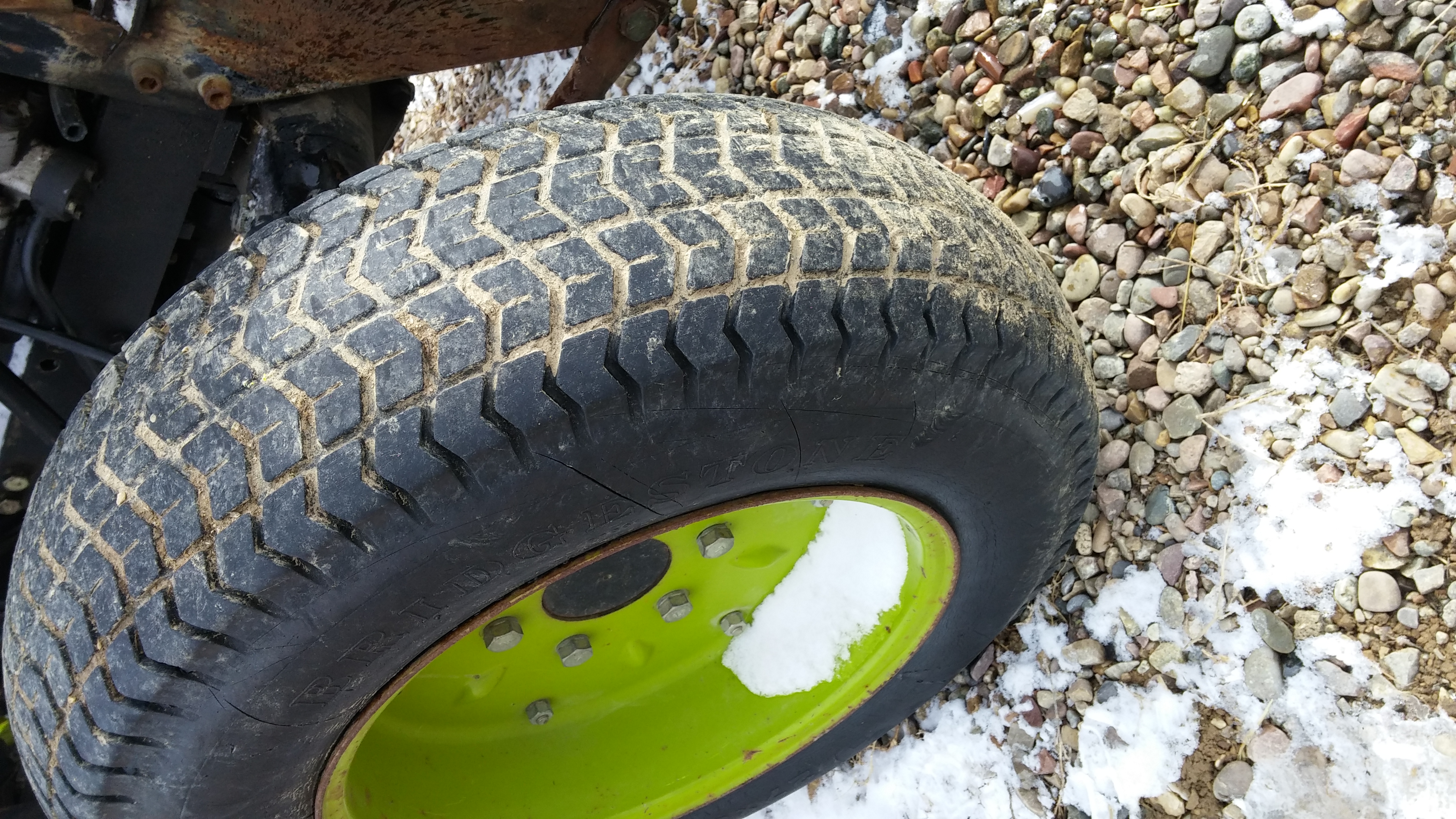

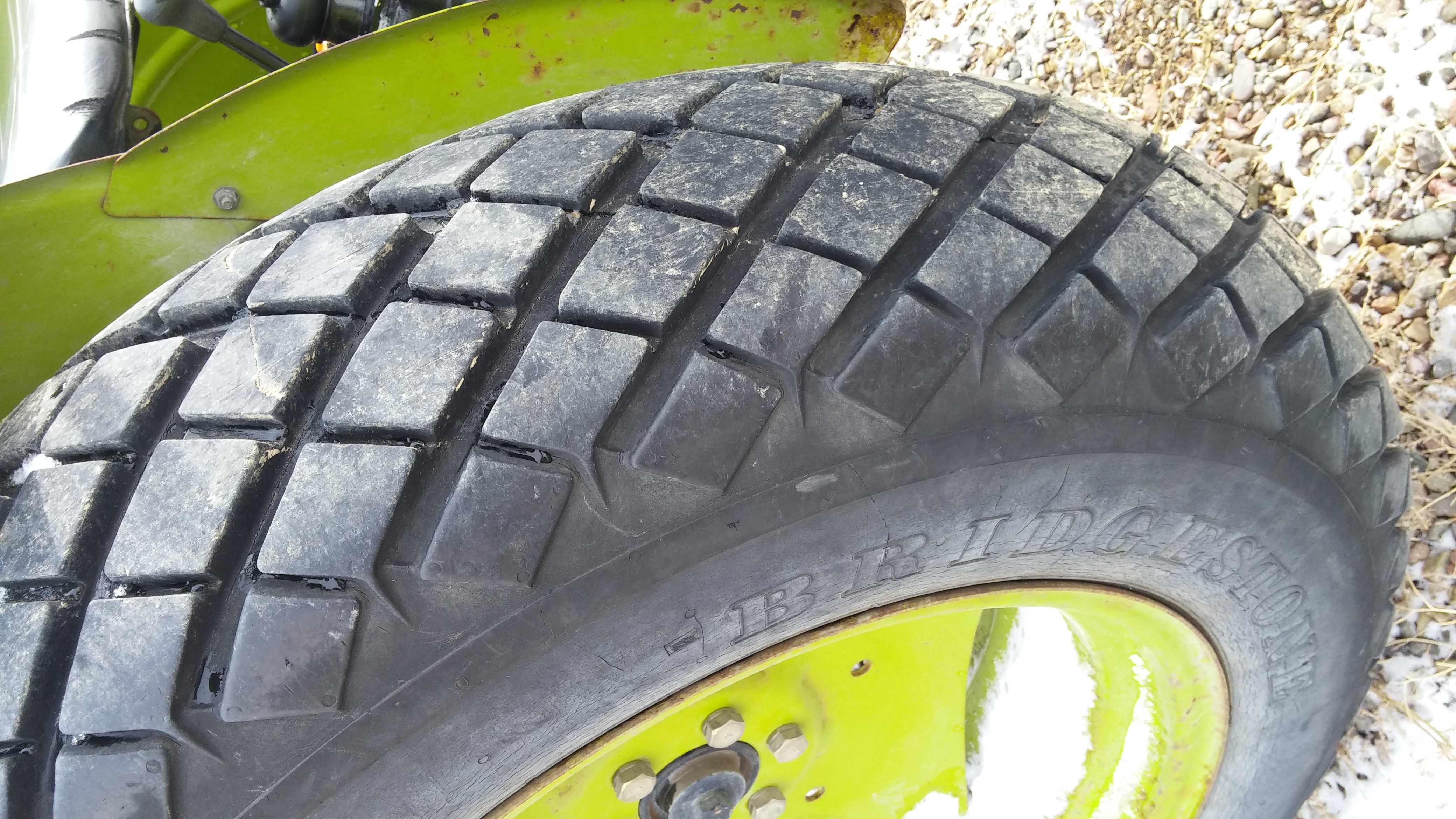

The front tires show some minor scuffing and are worn down a bit, but the rears don't show much wear at all. I think they are all the original tires, as they are all matching Japan made Bridgestones with weather checking on them.
