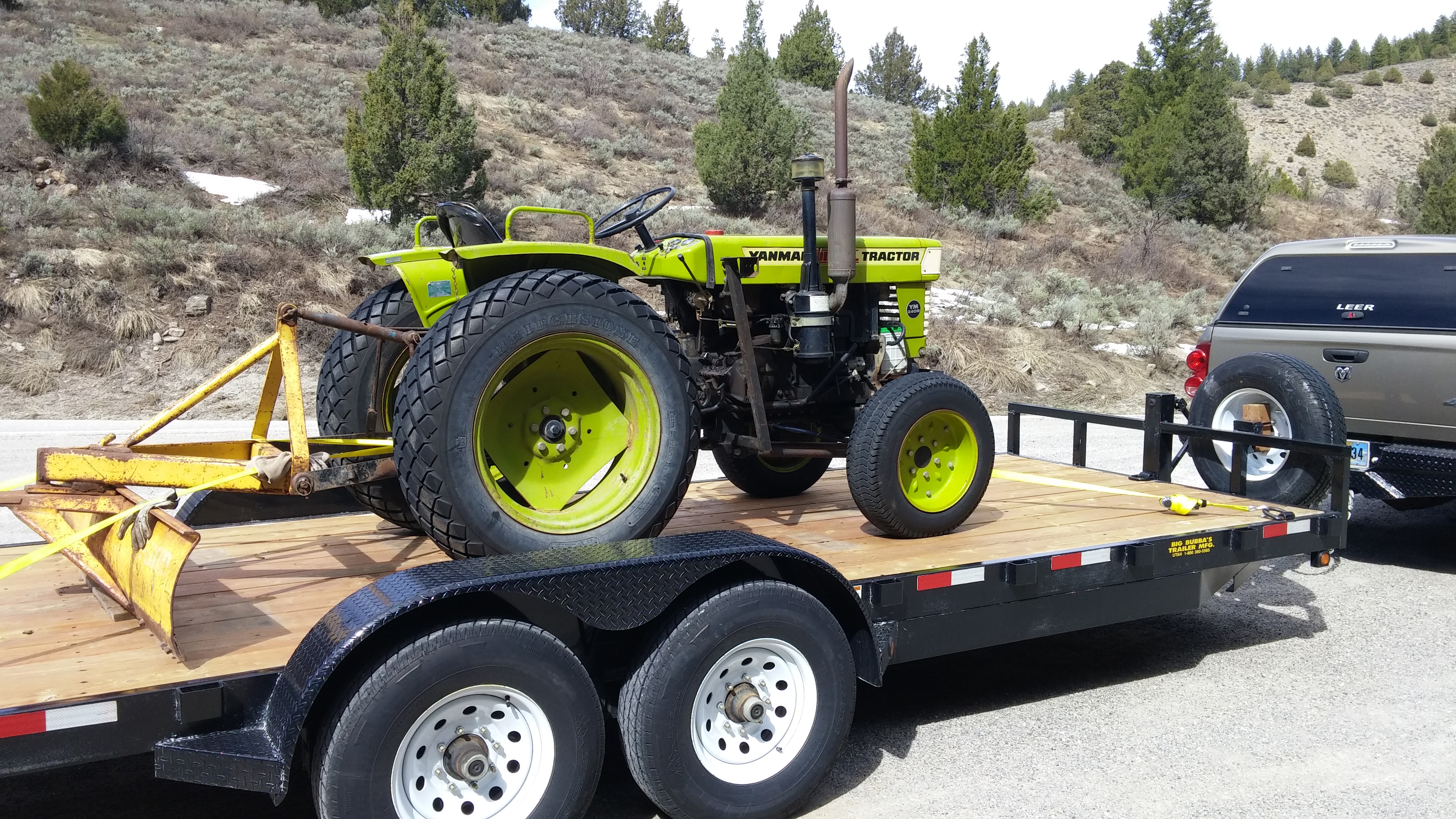

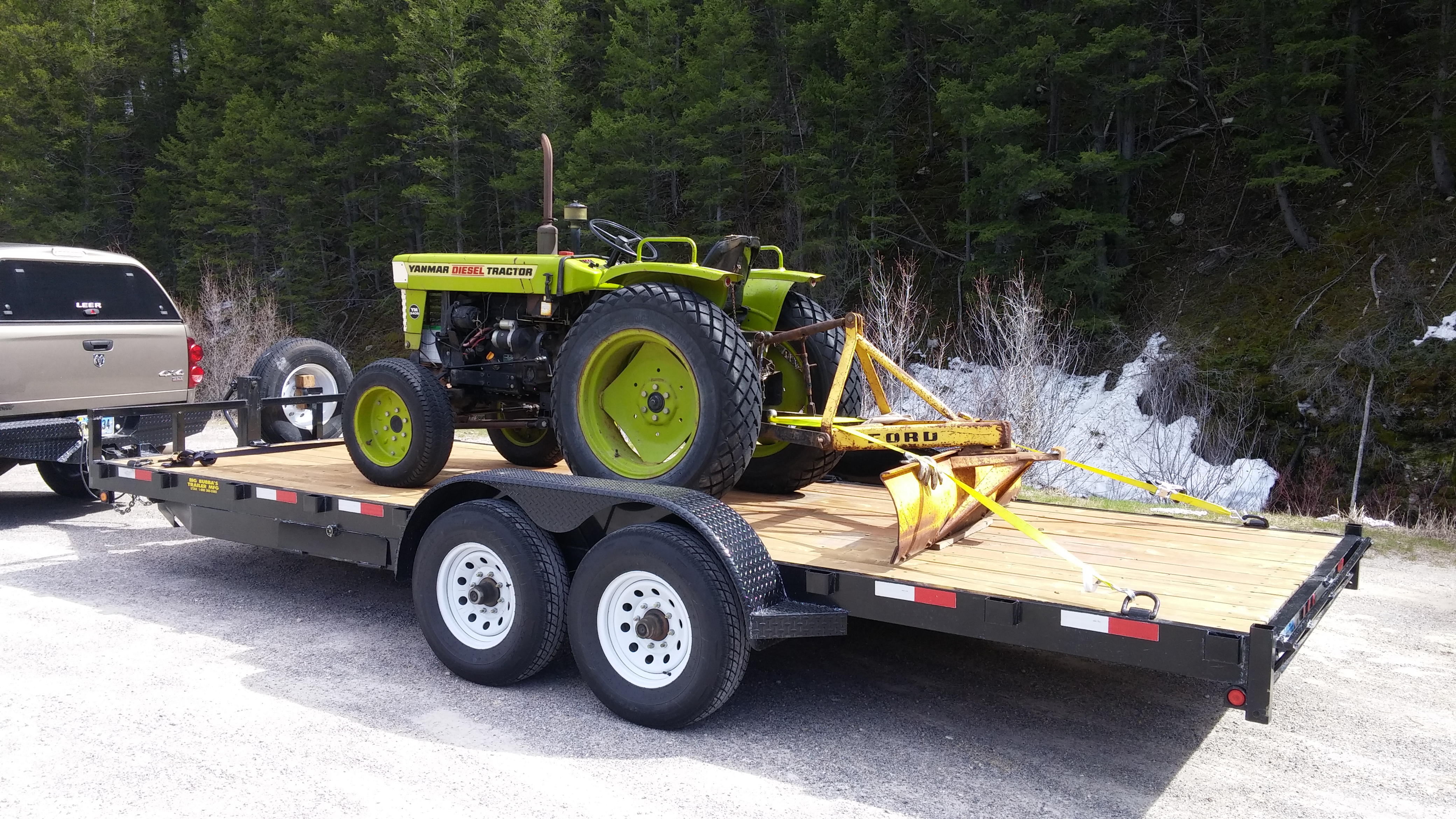

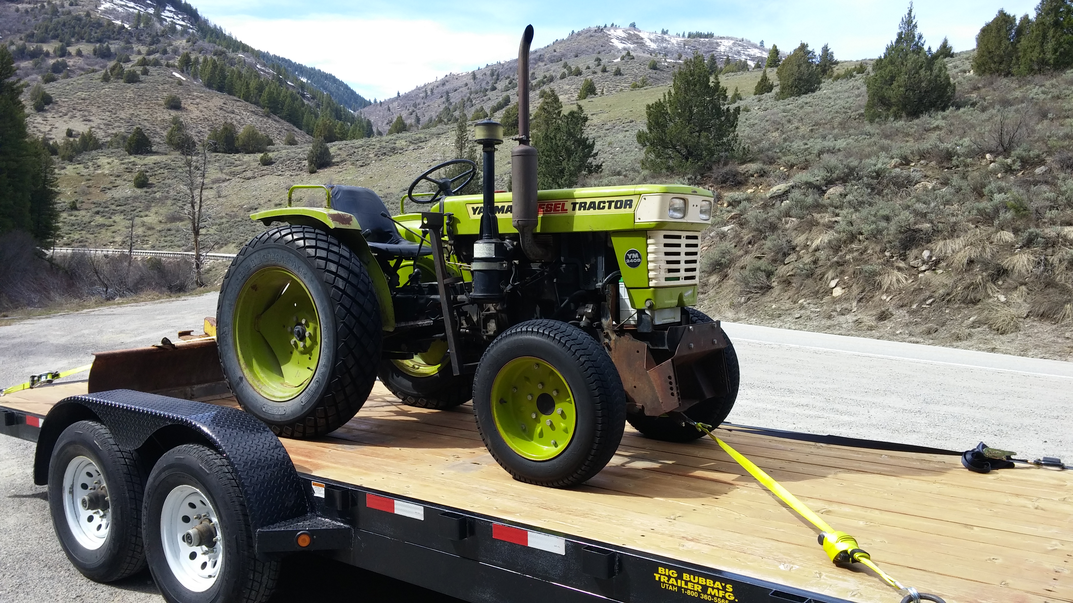

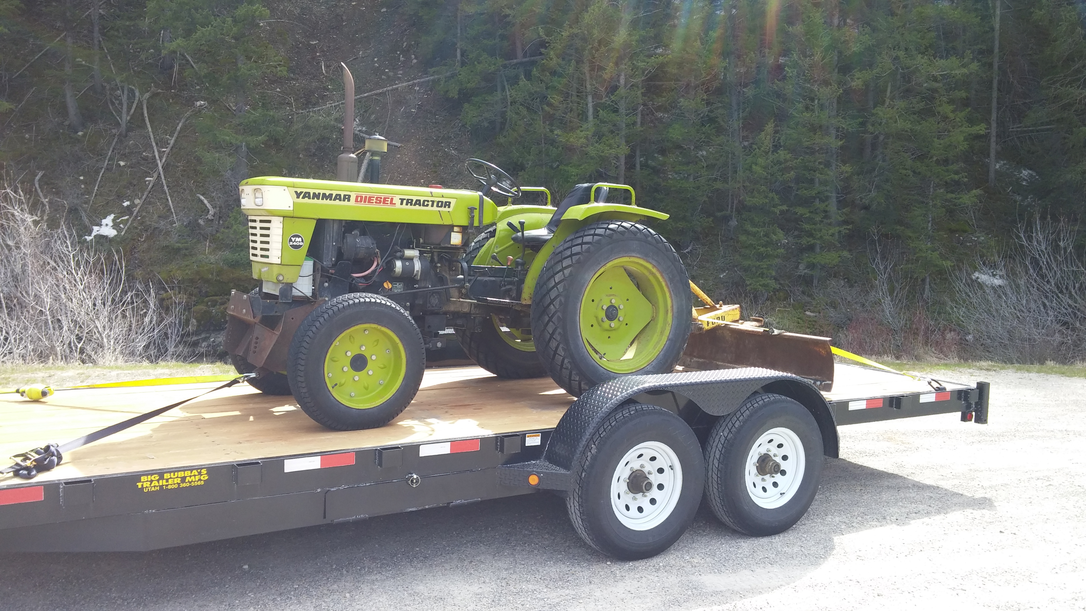

Hello been lurking for a while & you all have caused me to buy a new to me Yanmar! I have purchased a Yanmar 240d (pictures added) after following all the wisdom reaped from this forum! My question is this... I have purchased the only Yanmar 240 I have ever seen with the exhaust and air filter on the same side of the engine. Is this an odd ball or have others seen this as well? What do you suppose the brackets on the front of this tractor were used for? It has 780 hours (or 1780/2780/... who knows) but it is really good shape overall. Is it OK for the filter and exhaust to be on the same side? 0406171540b.jpg0406171541.jpg0406171540.jpg0406171540a.jpg0406171541a.jpg

Never seen one like that - and I've owned my YM240 since 2003.
The engine # id plate by the starter should say 2TR20A-X or maybe a different suffix. What do you see?
The intake manifold on these is cast integral with the valve cover so I guess it would be simple to have that as an option. I wonder if he repowered with the similar marine engine or something. I think that air filter is the same one used on the left in the final year of production, 1981, 'Level 4' in the parts manual.
The seat looks original so it probably is the first 780 hours.
Can you post a photo with hood open and looking down on the cylinder head?

I'd say it had a snow blower or something on it at some point, maybe the hydraulic levers on the other arm up near the steering wheel? I'd say 780 hours too, a very tender and gentle 780..... It's in great condition.

It appears someone has taken very good care of this old yanmar

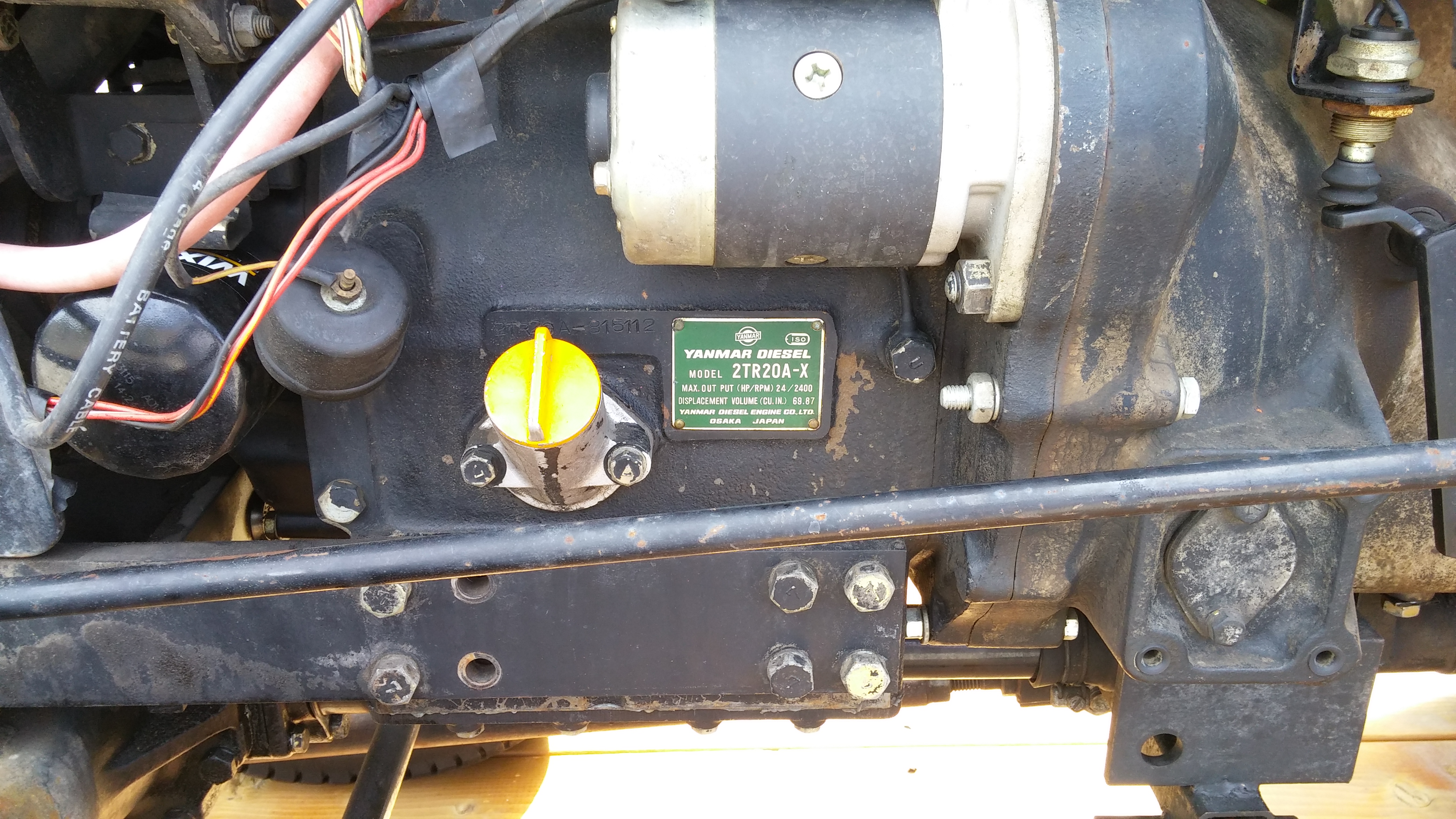

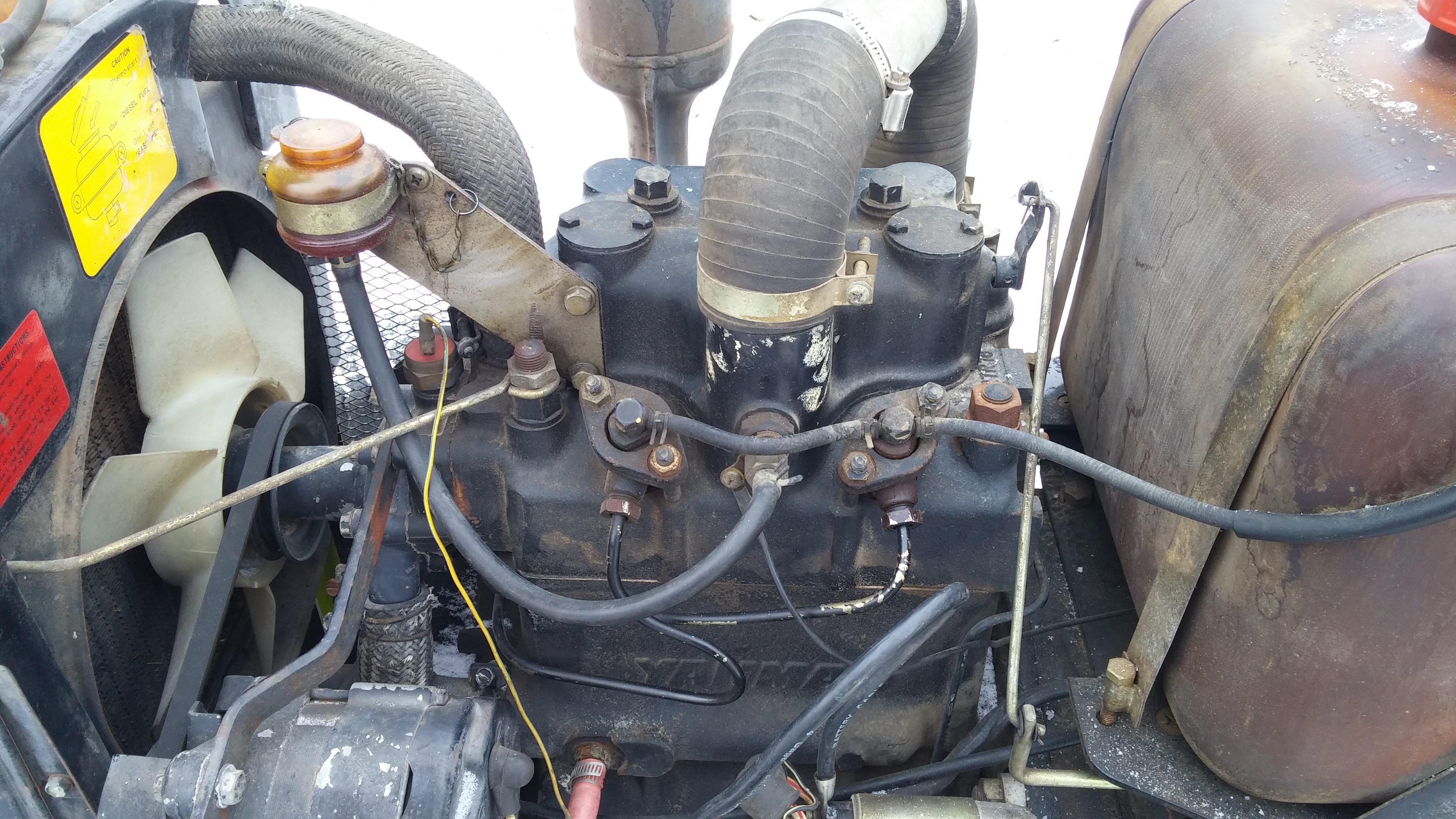

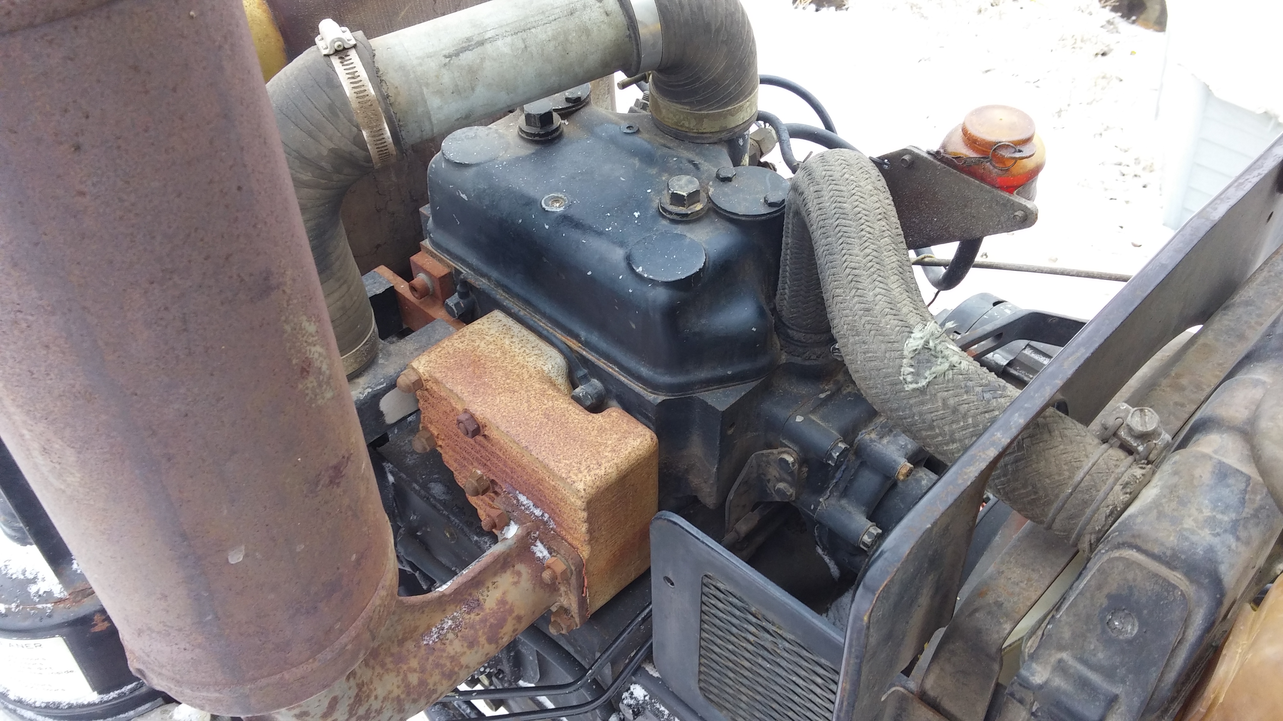

Thanks for the reply! The engine ID plate reads 2TR20A-X, But looking at the service notes that got passed on to me, the engine serial number is not the same as what was referenced in the service history (but the tractor serial number matches the what has been wrote down years ago). So I DO believe it got a new engine at some point, but cannot find ANY application that has the exhaust and intake on the same side of the head. This might be why I also have a tote full of spare parts, injection pump, injectors, exhaust & intake manifolds, water pump,a bunch of fuel lines, nos gaskets, bolts & pins, fan, fan belt etc, etc.

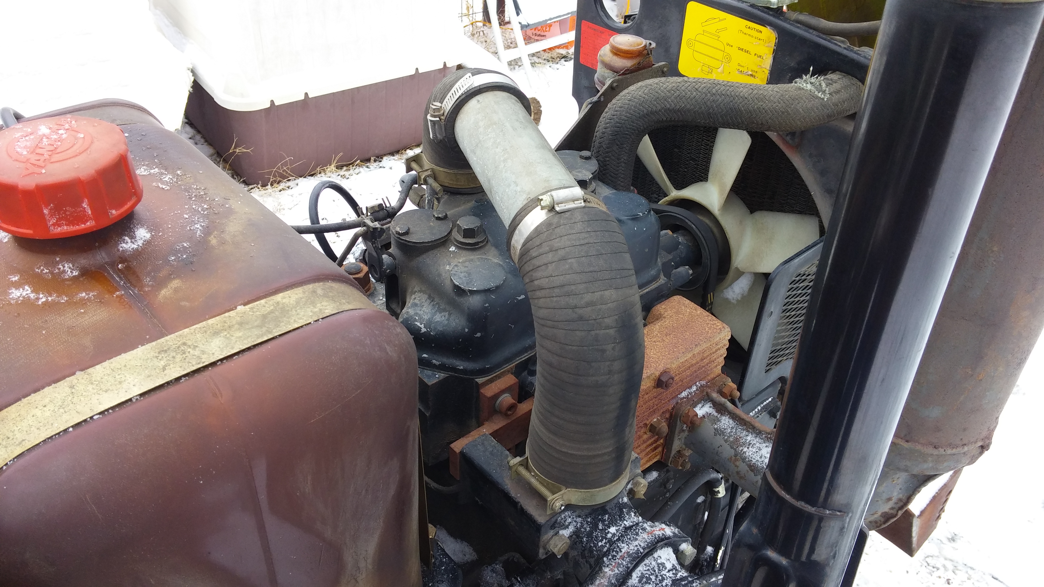

It looks very clean & everything but this air cleaner sharing the same side as the exhaust looks right (except a very welcomed oil pressure gauge & weird mounting bracket on the front). Here are some pictures0406171542.jpg0409170749.jpg0409170751.jpg0409170752.jpg of the engine.

Snowblower, do they usually have multiple mounting holes like this? Or did they a long time ago? I have been searching all over for a picture that shows a similar mount & of a Yanmar that does all it's breathing on one side :) .

Welcome to the forum. :welcome: According to Hoye the 240 came with to different filter styles, standard and the one you have. AIR FILTER- ^ STANDARD STYLE ^: Yanmar Tractor Parts AIR FILTER: Yanmar Tractor Parts
Looked in the parts manual and surenuff,optional air cleaner looks just like yours. Sending you a pm.

That is the ordinary intake manifold/valve cover, and the undisturbed black paint there further supports that it is a low-hour engine. The air cleaner mount is unpainted, and the hose clamps on that crossover tube toward the air cleaner don't match the oem clamp right at the manifold. I conclude that whoever mounted the snow blower or whatever it was, extended the original U-shape of that intake hose and modified the air cleaner mounting to avoid interference with some new hardware on the left side of the engine. So it's not a Frankensteinmar assembled out of unrelated parts, just a rational modification to mount some third-party equipment.
Mismatched engine serial # and the non-original bolts between engine and bellhousing suggest a replacement identical engine. (Check that those bolts are tight!) The addition of an oil pressure gauge might suggest some catastrophic end to the first engine, but I don't recall ever reading here of such an event on a Yanmar.

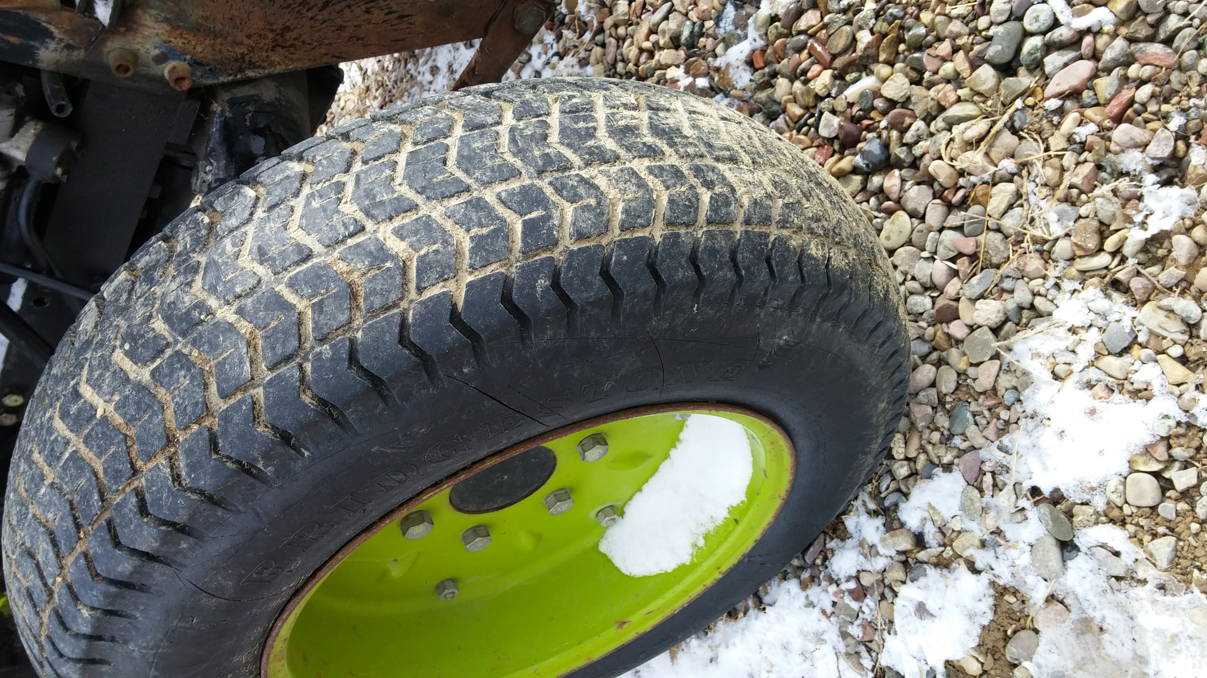

'Turf' tires on a 4wd might indicate this was bought new for primarily snow removal, with tire chains. (This seems to work better than ag tires for snow). Do the tires show scuffs indicating chains? And I don't see the rust that is common from clearing salted roads for 30+ years, indicating excellent maintenance or non-urban use.
Do you see any remnants of hydraulics? That mount by the throttle and the adjacent wear on the fender suggest a hydraulic control was mounted there.

The front tires show some minor scuffing and are worn down a bit, but the rears don't show much wear at all. I think they are all the original tires, as they are all matching Japan made Bridgestones with weather checking on them.

The air cleaner assembly has been moved to it's current location by someone, the brackets are "home made" and the plumbing doesn't match the OEM Yannie stuff. No matter it still functions as intended.

I would love to be able to find a picture of how it was originally plumbed under the hood. There are no mounting surfaces on that side of the head. I wonder if the big air filters were mounted to the hood in some was originally? Do you guys think I would have to move it somewhere else if I ever find a loader for it? I'm not sure if it would clear everything.

You should be able to look at page 57 in your manual and then look under the hood to see where mounting bracket #18 should mount.
/ Yanmar 240d questions
#20
LOL, I must be blind, I cannot see where the mounting point on the other side is, in the parts manual (thanks a million btw!), in pictures, OR in person! I will probably leave it for now, unless I run in to clearance issues later on.
