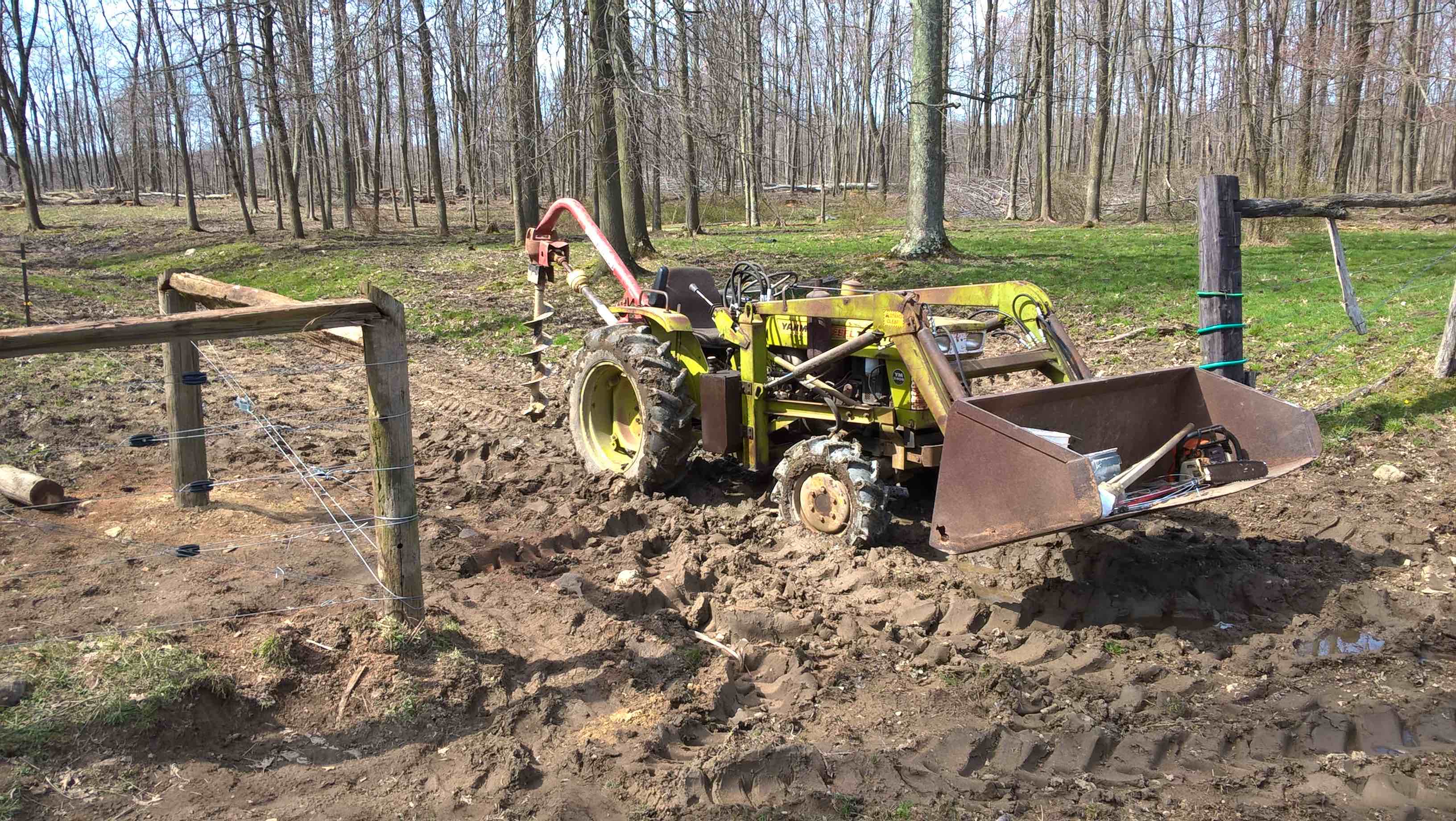

No loader on my Yanmar and I believe Clemsonfor for a good example doesn't have one that I know of. When I spoke of the JD. I just remembered when the last time I put the bucket on. It was almost Spring of last yr.. It was wet and without 4wd. It didn't take much to almost get it stuck. Which I had to bucket out the rear tires right off the bat!! Try the rear scoop and then see if you think your need one. For me with Turfs and 2wd. even if they gave me a loader I won't do it. Here's a pic. of the JD. it keeps up with BH & FM 35 acres...
