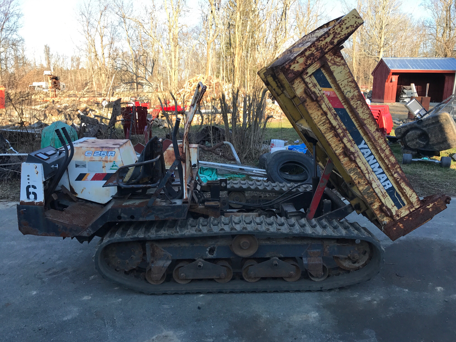

My $400 "parts" machine is now an excellent runner! I fixed the wiring, fuel lines, put in a new low pressure fuel pump and it fired right up! Runs awesome, steering is very responsive, brakes even work good! I went through and hit every grease fitting I could find and oiled all of the linkage.

/ Yanmar C25R Track Dump #30
I love it!
Looks like heck > ... User neglect and abuse.
Runs like it should despite years of abuse > ... Yanmar quality!
